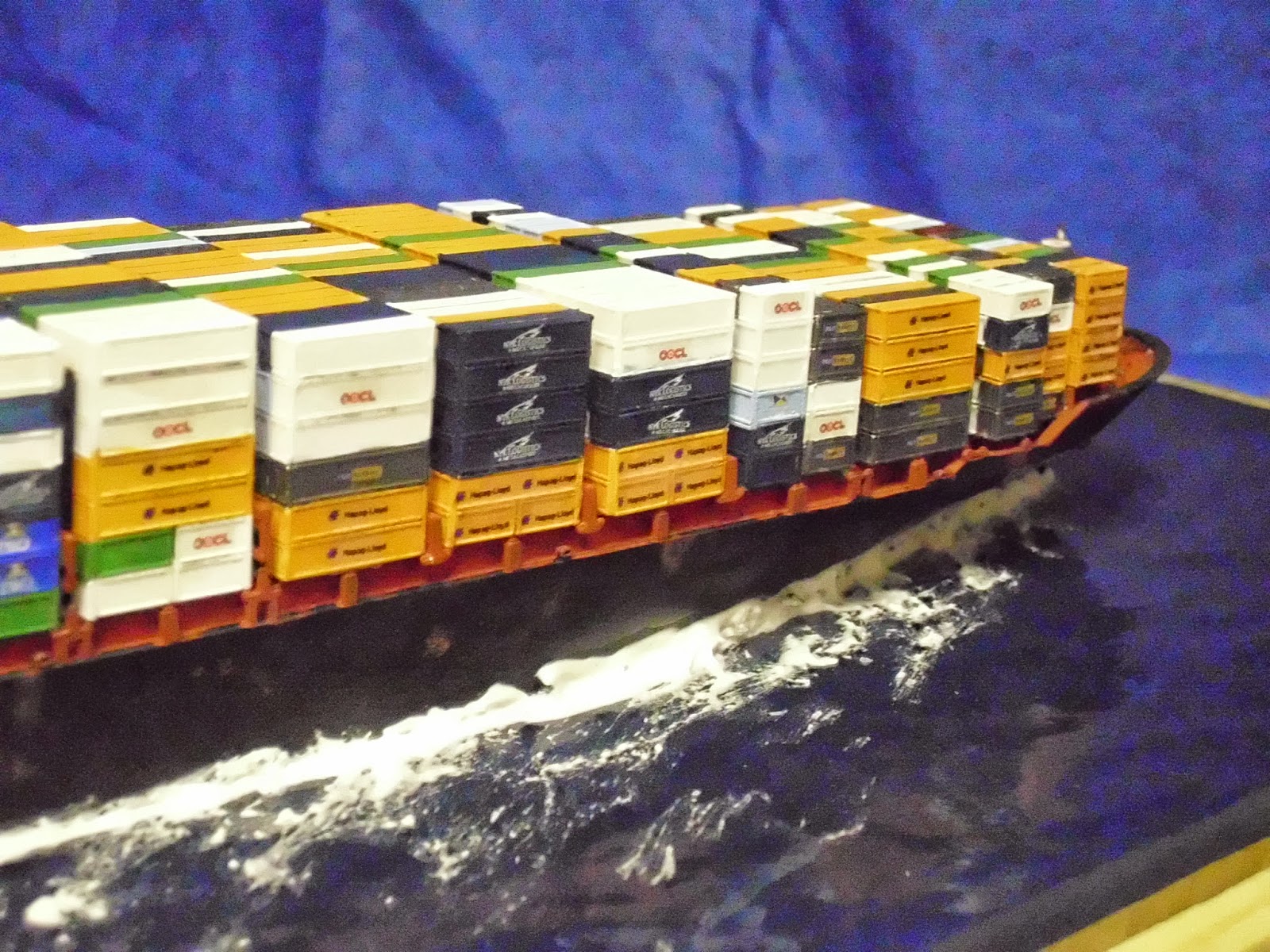

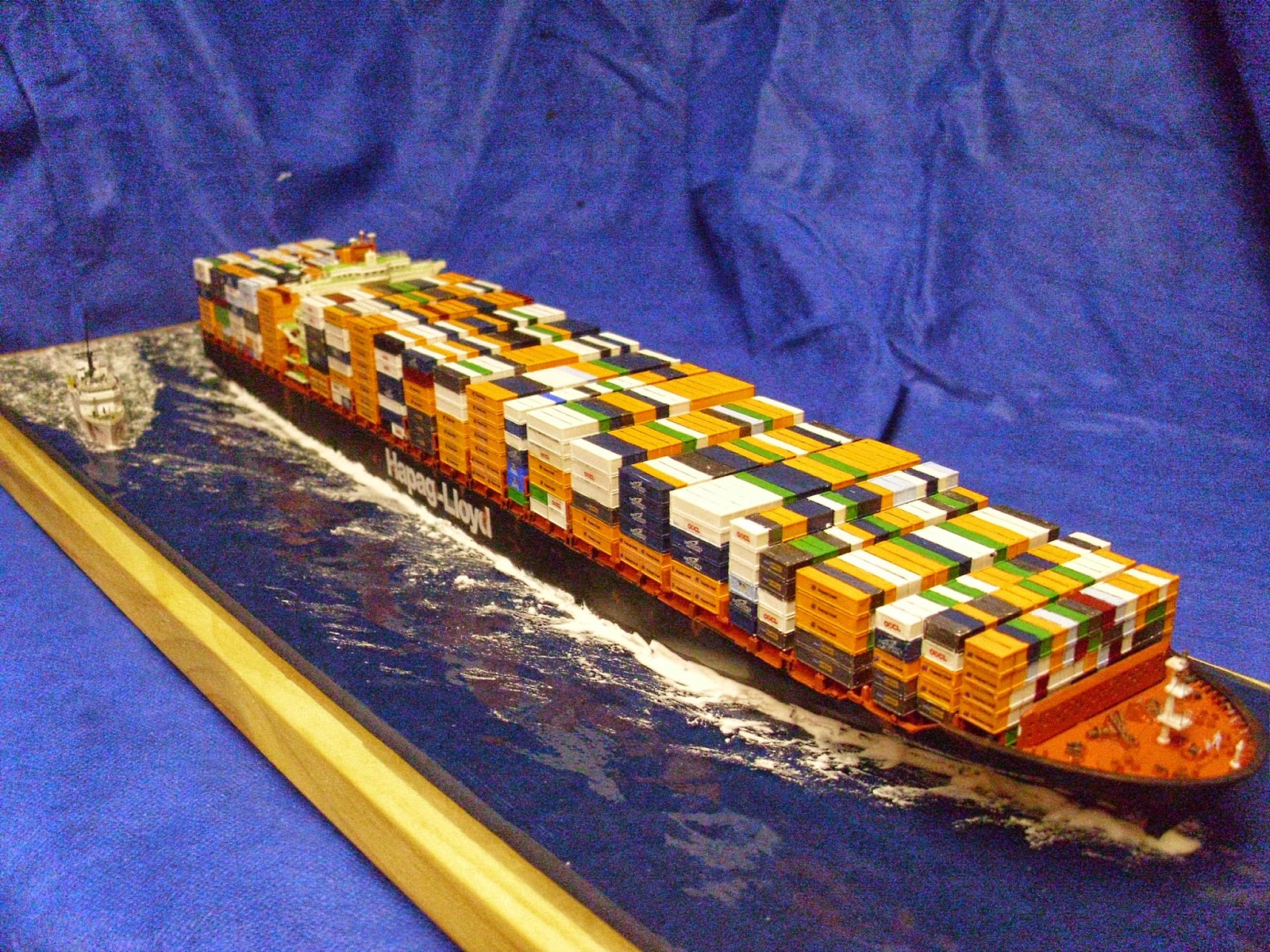

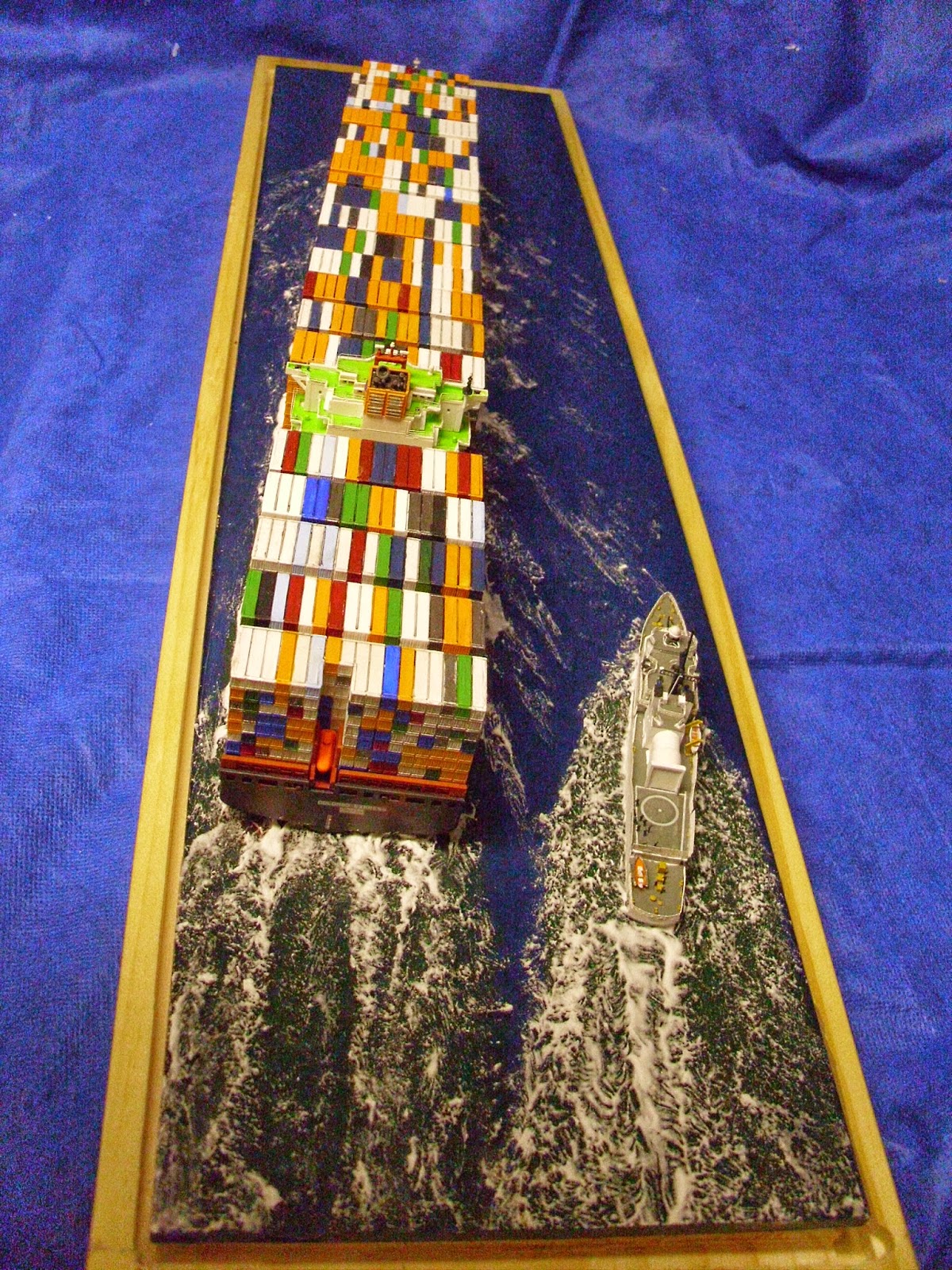

As per my previous post, here is the final photos of the build. I was pretty proud of how well the wake turned out on the vessels.

Yes those are 1/700 scale Coasties on the flight deck. What is a CG cutter without at least some of the crew catching a smoke break?

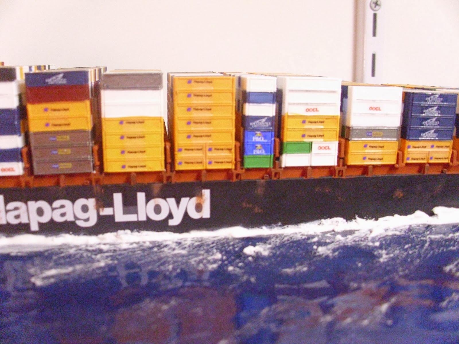

The extra container decals were added from White Ensign Models. I definitely could have used a few more for sure, but I was pretty sick of painting containers by that point.

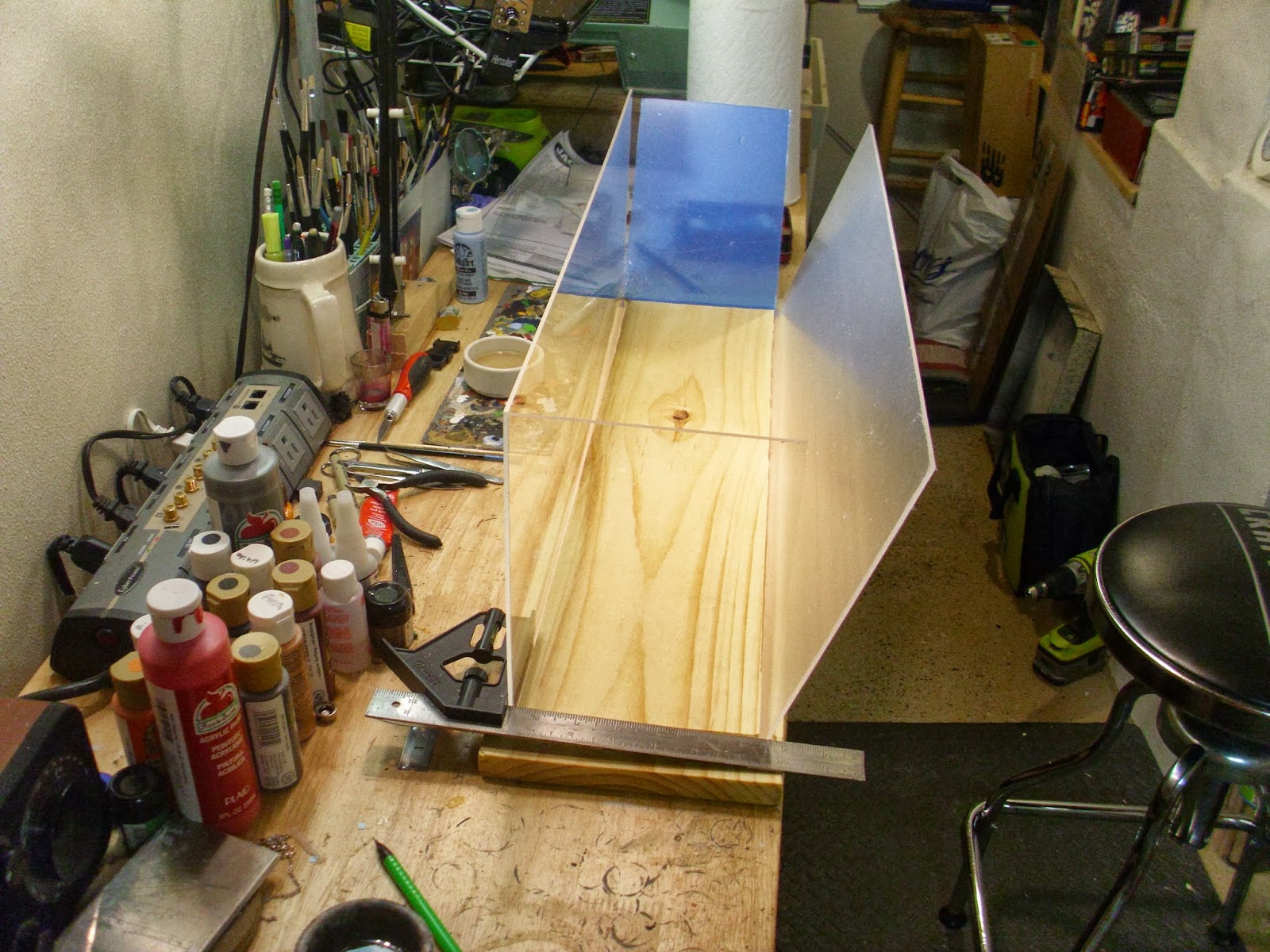

A very realistic scene, specially the water! What did u use to make the water? [Y] Did u cut and assemble the plexi case yourself, if so, how did you cut the panels and what did u use to glue them together?

I had printed my own container decals. I had saved the artwork for awhile, but just recently erased it. I should have posted it somewhere.
Don, That would have been great to find that on the net with more container companies. The white Ensign decals were great, but a few more companies represented would have been a more diverse model.

If you go to my blog, I have a few more pics and tips on making acrylic display cases. I will probably post another article on my blog at some point as I have a few more cases to make. The glue is called Weld-On #16 made by IPS corporation. I used a Ryobi Cordless Circular saw with an Avanti plastic blade to cut the acrylic sheet. The water was a piece of textured acrylic typically used for bathrooms or shower stalls. The wake was simply done with several layers of a 50/50 mix of Patch and Paint spackle compound with water. I painted the bottom of the water acrylic with dark blue, and the area where the wake was going to be was painted a hunter green. I used my dremel tool with a dremel plunge router attachment to cut the channel for the display case pieces in the wood. I never used this before despite owning it for a few years! Lastly I used an acrylic scribe tool to smooth the edges before gluing them with the Weld-On.

There was a site on the web that I found by searching for “shipping container logo”. It had the logo for just about every company involved in tri-model (container) shipping. Just had to resize them and fit to proper color background.
Don,
I must admit I thought about doing that, but since the White Ensign decals were less than 10 dollars, and I needed to buy more sheets of the testors film, it seemed far easier to just buy them. If I was going to do this ship again, I would definitely print my own, maybe in addition to the White Ensign decals. It is ashamed that the kit manufacturer didn’t make any efforts to add a separate decal sheet. It would have been pretty nice if Revell-Germ. had offered some optional parts to make a varying level of containers instead of the “all full on every stack” look they have. Still, I won’t bag on any company for putting out a rare commercial vessel, as they don’t seem to be very big sellers when compared to the military ship model market.

Here are a few last pictures starting with the display case fit up.
