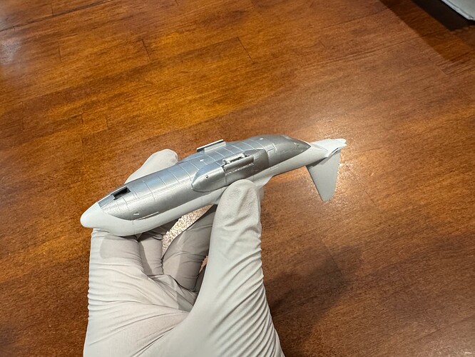

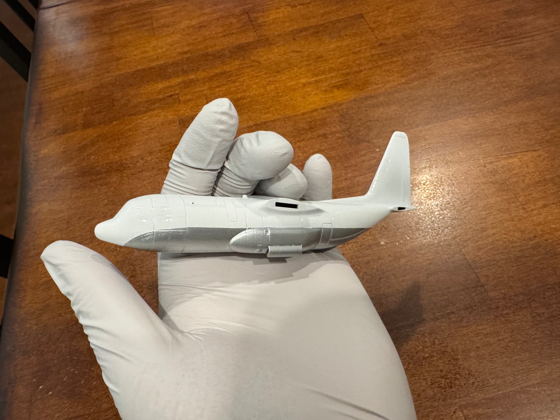

The base kit is the C-130H from Hasegawa. It’s an older model from 1987, but it still works pretty well fit wise. Converting it to the L-100 required minor work, primarily filling the lower windows with putty and also filling in some scribing for the door on the right side. Asides from that, everything is practically going to be the same. I’ll be using decals from Draw for their Delta L-100-10s.

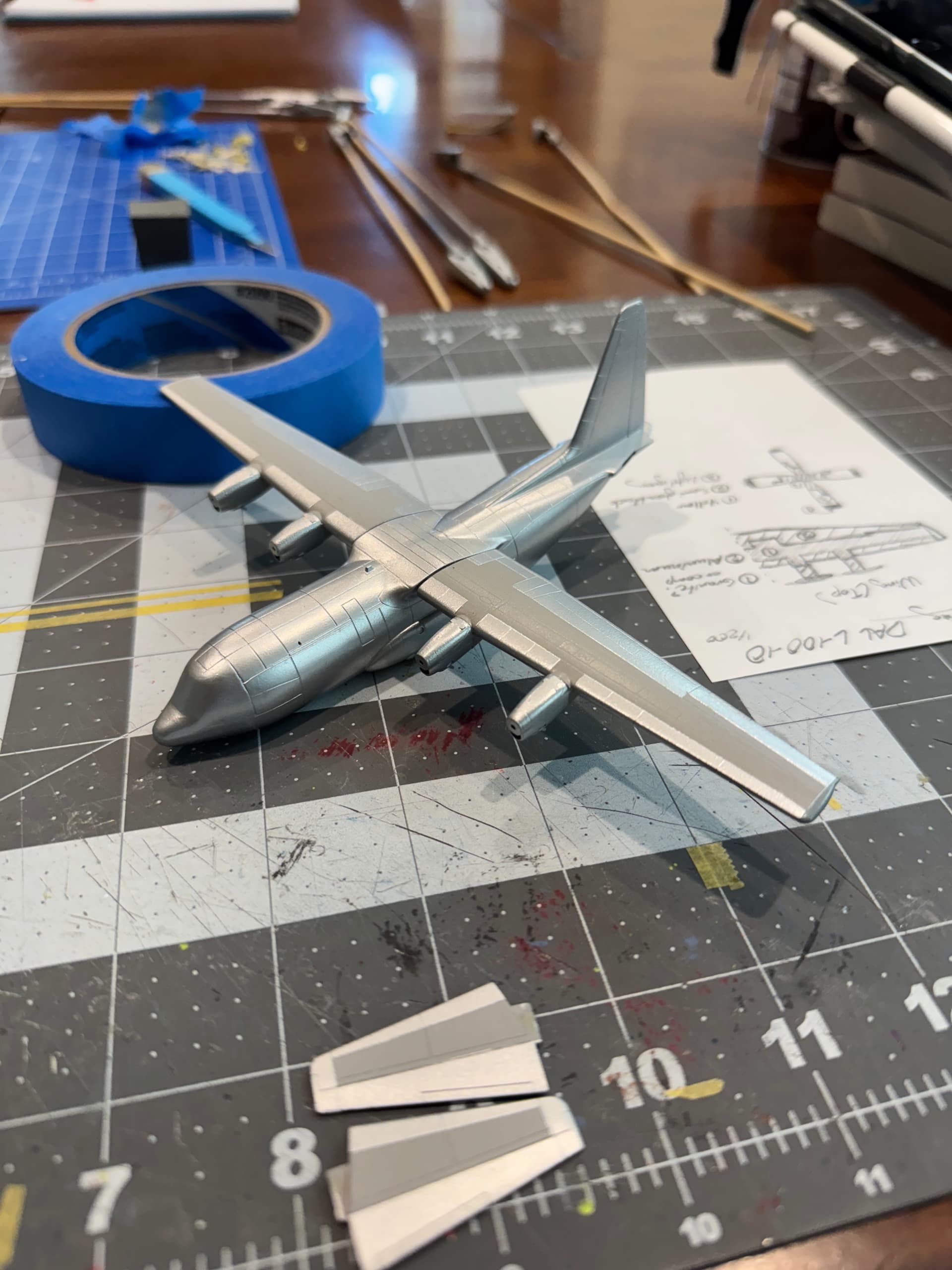

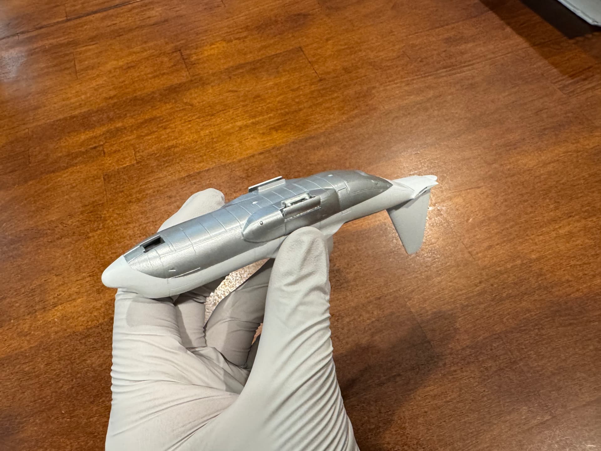

Here’s most of the aircraft put together with the exception of some minor bits and bobs like rigging posts, propellers and landing gear.

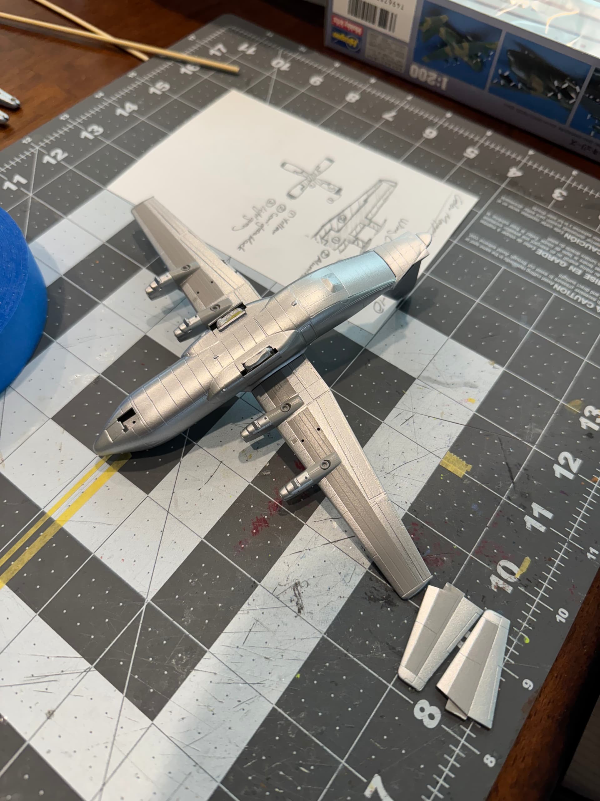

Hey everyone, I finished assembly, and have started to clean the parts for painting. I am now struggling a little with some color references on my L-100 wings.

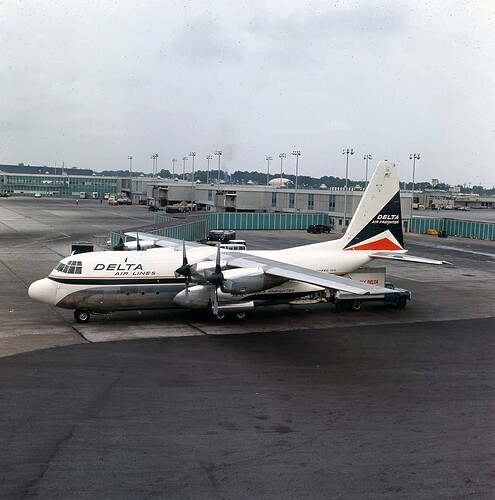

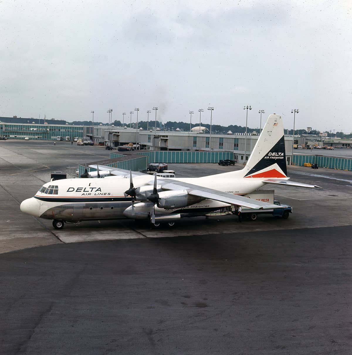

I have only one really good photo of the color patterns on the wings, which is this one.
I think the engines are aluminum. The leading edge is a lighter gray that I don’t think is metallic. My main problem is determining what the engine nacelle thingy connecting to the wing is. Is that the same color as the back color of the wing? Wingtips look to be a lighter winter grey. But yeah, I would appreciate help if anyone has any other color references for the wing or can confirm what I see! Thanks in advance! Happy modeling
