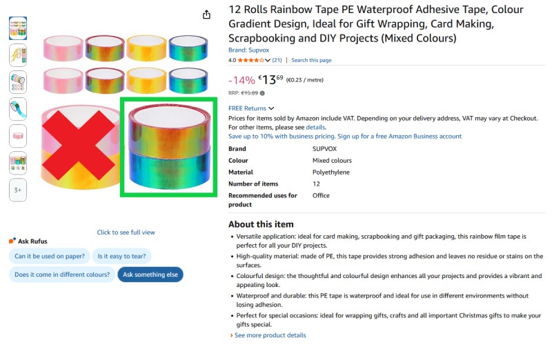

To replicate armoured glass I am using rainbow tape, which I found on Amazon.
There are lots of differend types available, but the two on the right does only work for this.
Most times I use the blue/green tape, but the red/yellow looks good either.
One of the last things I do on a build is to paint the vision blocks silver, cut a suitable piece of tape and stick it on. Depending on the angle of view the tape changes its color and looks very effective like armoured glass!

ancoron109: I disagree with your suggestion for this question. The rainbow tape is good for modernized glass with anti-laser treatment. WW2 era glass had no such treatment.

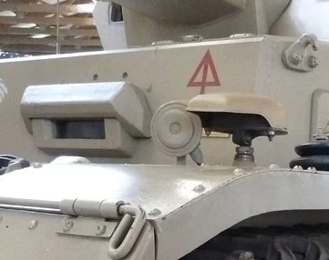

OK, if you want clear vision blocks on your model it is completely up to you.
But vision blocks on German tanks in WW2 consist of multible layers of thick glass. Looking from inside these are clear, also if removed! However, looking from the outside they appear in a very dark shade of blue, sometimes even green. If you ever had the chance to see a real thing in a museum you know what I am talking about.
If you really want an authentic look paint the block in a dark blue (XF-17 works good), then dry-brush with a lighter blue (if you like additional with a green) and put a small dot of very light gray into one corner. Finally a coat of PVA, Pledge or whatever gloss varnish is at hand.
I do it all in one with the tape … :joy:
