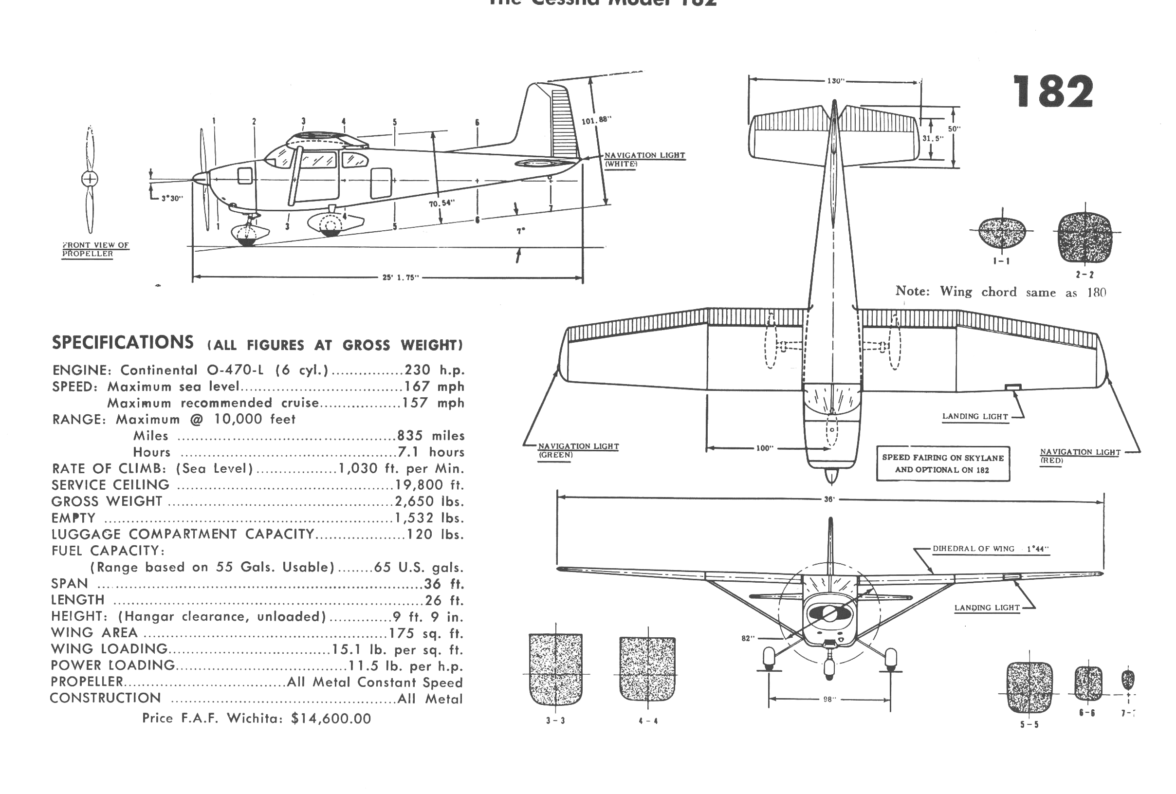

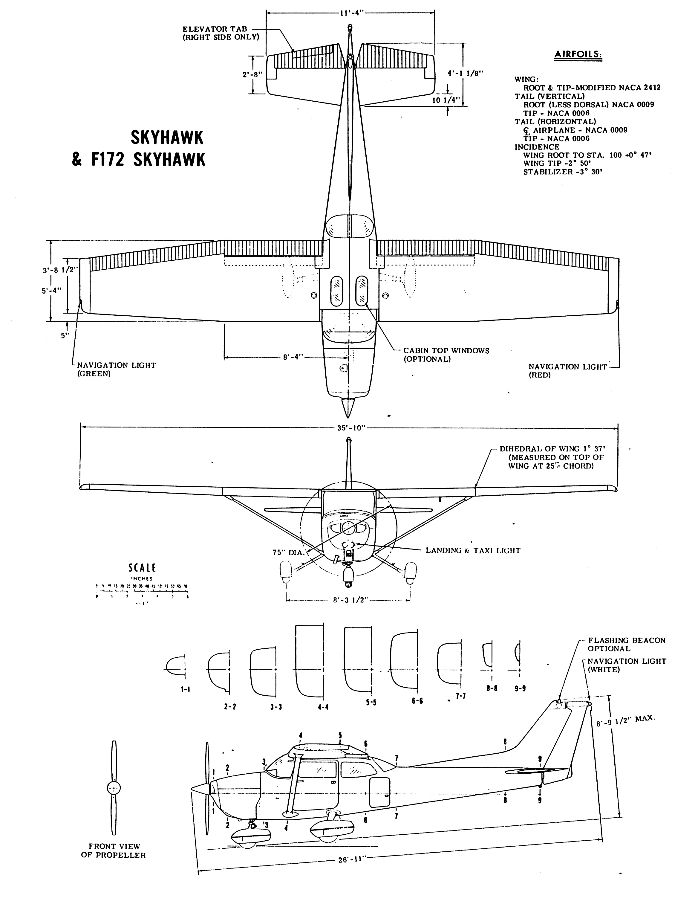

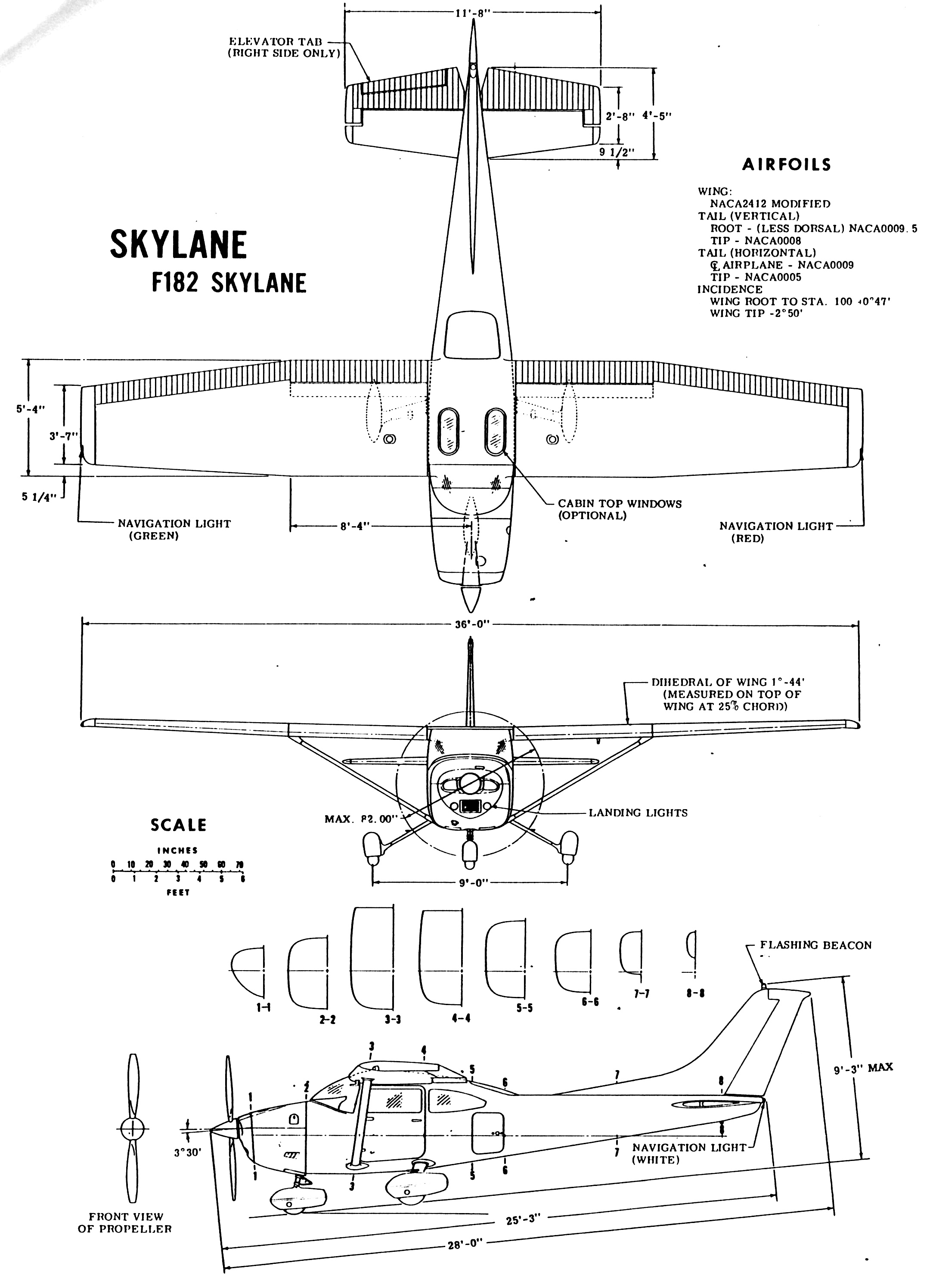

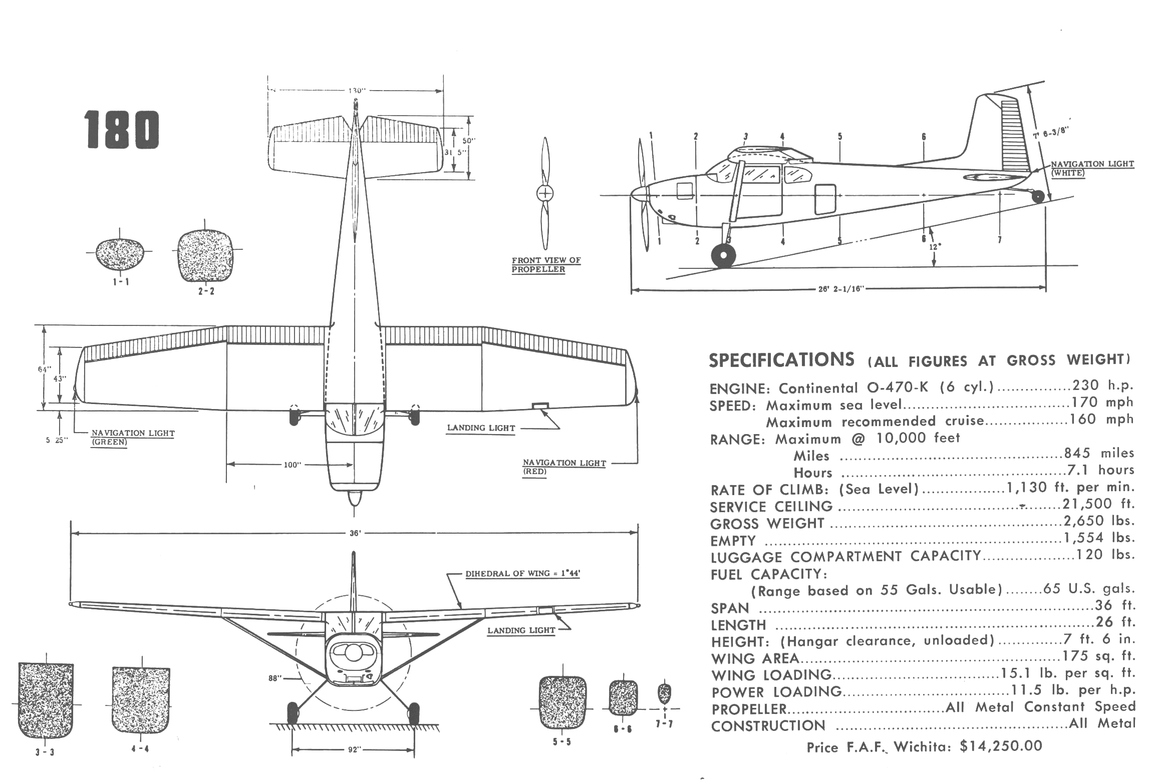

The 182 was a tricycle gear version of the 180 which was introduced in 1953, the 182 was in 1956 or late 1955. As time went on the 182 grew a swept tail, then a wider cabin and back window among many other minor variations. The 172 was partly based on the 180 fuselage but it was different in many ways from the first 180. The 150 grew from the 140, the last 140 had the same wing as the first 150.
Here are some Cessna factory 3 views of the 172, 180, and 182.
I was wondering when you were going to chime in here John.
