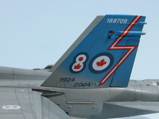

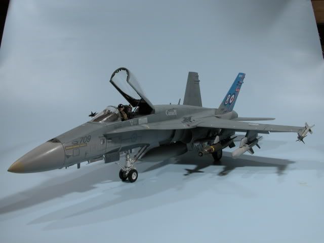

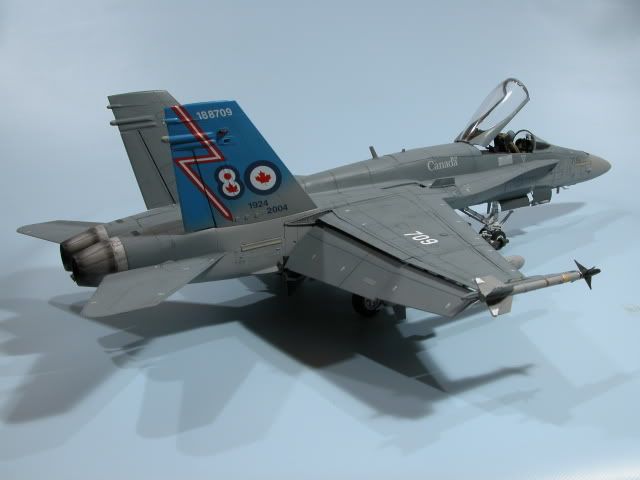

Hi,
I recently built a Canadian CF-18 at 1/32 scale using the Academy kit. It turned out very nice without to much surgery, just a couple of things to sand out. Also, I don’T know about those 1/72 kits but Canadian CF-18 have a spotlight on the LH side of the nose. You should check for a kit that give you that option.
For decals, there is a very good company that makes great decals for CF-18 in differnt scales. There are several retailer but here is the link to the manufacturer. http://lemdecal.com/ I used those decals on my bird and I must say these are the best decals I had to put on any model, very thin and sticks well. Will look like painted on with just a small amount of Microsol. Here are some pictures of my CF-18.
Luckymodel also sells those decals at low price and they delivers pretty fast. http://www.luckymodel.com/scale.aspx?search=Y&q_brand=LEM&q_category=&q_scale=72&q_word=
Also, here’s a link to a good site for reference pictures. http://www.airshowphotography.com/
I modeled the exact plane that is shown there. You can use those pictures to check the differences between US and CDN ones.
Have fun

Yann Solo … excellent build on the Hornet. My compliments to you.
I am thinking the 2003 TMOTA set in 1/48 but the 2001 TMOTA or 1992 TM in 1/72. Which set does Lucky have in 1/72?
The 1992 one.
Thank you very much, it was fun project with a lot of learning, if you know what I mean.
