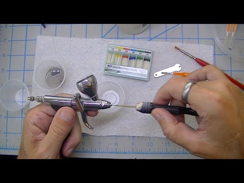

I would suggest doing a thorough full strip and clean. The nozzle may have paint built up on its inner wall.
This is a good video by Will Pattison:
Try it and see if your airbrush sprays well again.

Glaring error in that video, NEVER EVER pull your needle back thru the airbrush when cleaning, you’ll risk getting paint where paint should not get to. Always push the needle out the front before cleaning and, re-install it from the back after cleaning, pushing gently until the needle is seated.

Not to start anything contentious, as I have heard that rule also. However, iwata’s official video have you pull the needle back to deep clean it. Check it out on youtube. I figure they would give good advice on how to clean their ab?
Just my opinion on this.
When the paint cup contains paint, and the needle is pulled back for paint flow, wouldn’t that part of the needle exposed to paint make it past the needle bearing anyway? Or if the bearing is scraping off the paint from the needle, then same thing should happen when the needle is pulled out the back.
As long as the flushing is all done well first, any minuscule amount of paint getting pulled back, if any, shouldn’t damage anything. This is different from a full on paint leakage into the body of the ab past the needle bearing. This happened to me before and a total stripping of the ab for thorough cleaning got the ab back in full working order.
