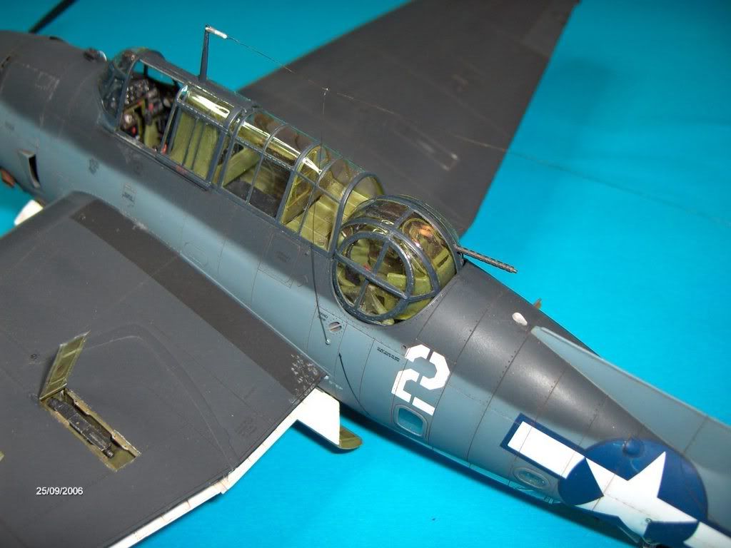

This is the AM George H. W. Bush TBM-1C Avenger that I’ve been working on for the past 18 months. The plane is basically complete except for a couple very small parts to attach (you won’t be able to see what they are in these attachments. I’ve taken photos but am not happy with them except for this one and the short video attached. I’ll post more photos when I can take some better ones. In the video, if you can view it, I’m only using that canned air used for cleaning dust from keyboards, etc., to make the prop turn. There’s no motor or anything in the build and no sound effects because I’m just not good at making them.
This build took so long because I superdetailed and scratch-built most of the interior, and detailed a lot of the exterior, and because of work and Reserves, I only could work 1-2 hours a day on those days when I could even work on it. I want to put this in a diorama but have just begun working on the carrier deck, ordnance and equipment and haven’t started the figures yet. However, because of mobilization and impending deployment downrange soon, it may take a while to finish the diorama stuff.
As I said, these are just a teaser and I’ll post better photos soon. The video is a little grainy because it’s from my digital camera. I’ll try it also with the digital video camera.

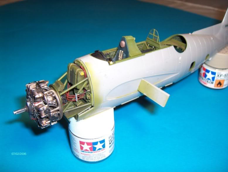

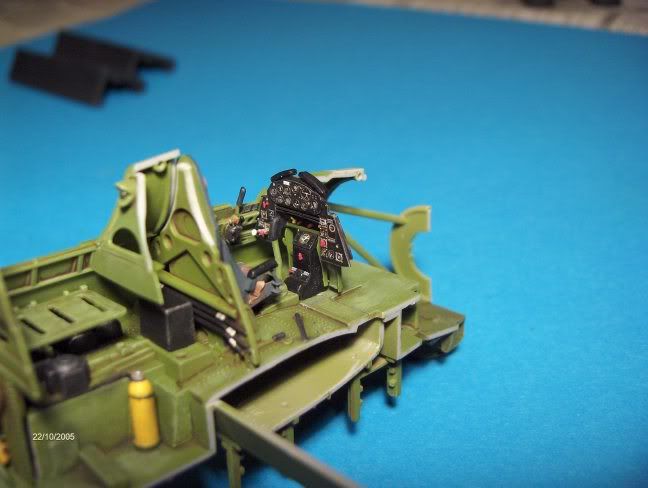

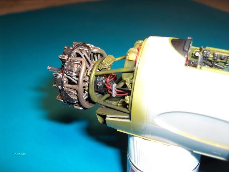

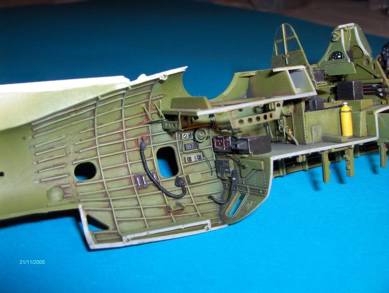

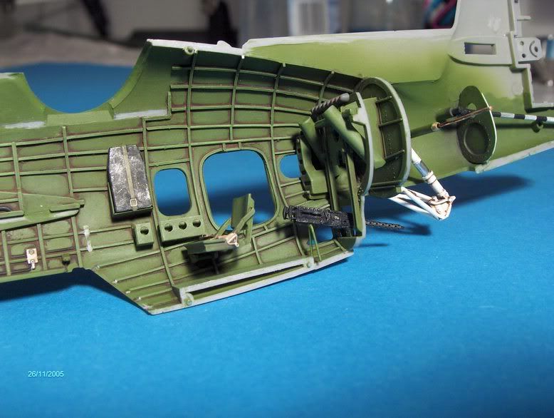

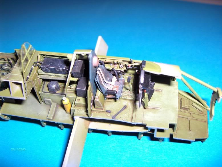

Here are some interior photos.
Hope you enjoy them.

Awesome build. The interior shots are magnificant. How did you to the interior wash along the ribbing? I’m getting ready to do an interior B-24. Have the green laid down but not sure how to accent. I was thinking about a combination of oils and pastels. I was able to see the video. Very cool[8D], it looked like it was doing an engine run up; very creative idea. Thank you for sharing.

Bablenw - I used an artists’ oil paint and mineral spirits wash for the interior as well as the rest of the plane. I mix mostly burnt umber with a little ivory black in the mineral spirits to the consistency of coffee - so that it’s very thin. I cover almost everything with it making sure the ribs and recessed areas are filled. I then let it sit about 24 hours to dry. I pile up the q-tips and then start removing the excess with the q-tips soaked in mineral spirits. But all this is after I spray with a good coat of Future. I really like this type of wash because it goes on easy , comes off fairly easy and gives a nice used, dirty appearance.

smokinguns3 - Yes, this is the Avenger with the turret issues. I had to take the turret assembly apart at least 4 times to get it right but I’m happy with the result, though the fit in the fueslage is so tight that I can’t turn the turret without scraping paint off the canopy frame. But the the machine gun does elevate.

Very nice work on the Avenger. The interior work is extraordinary and really shows off all the effort that you put into it.
