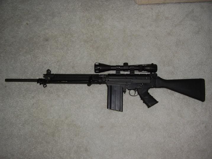

Here is a picture of mine:
Wish I had a picture of my dads, much nicer than mine.
Josh
Nice blaster Josh! Gotta love the mighty FAL.
