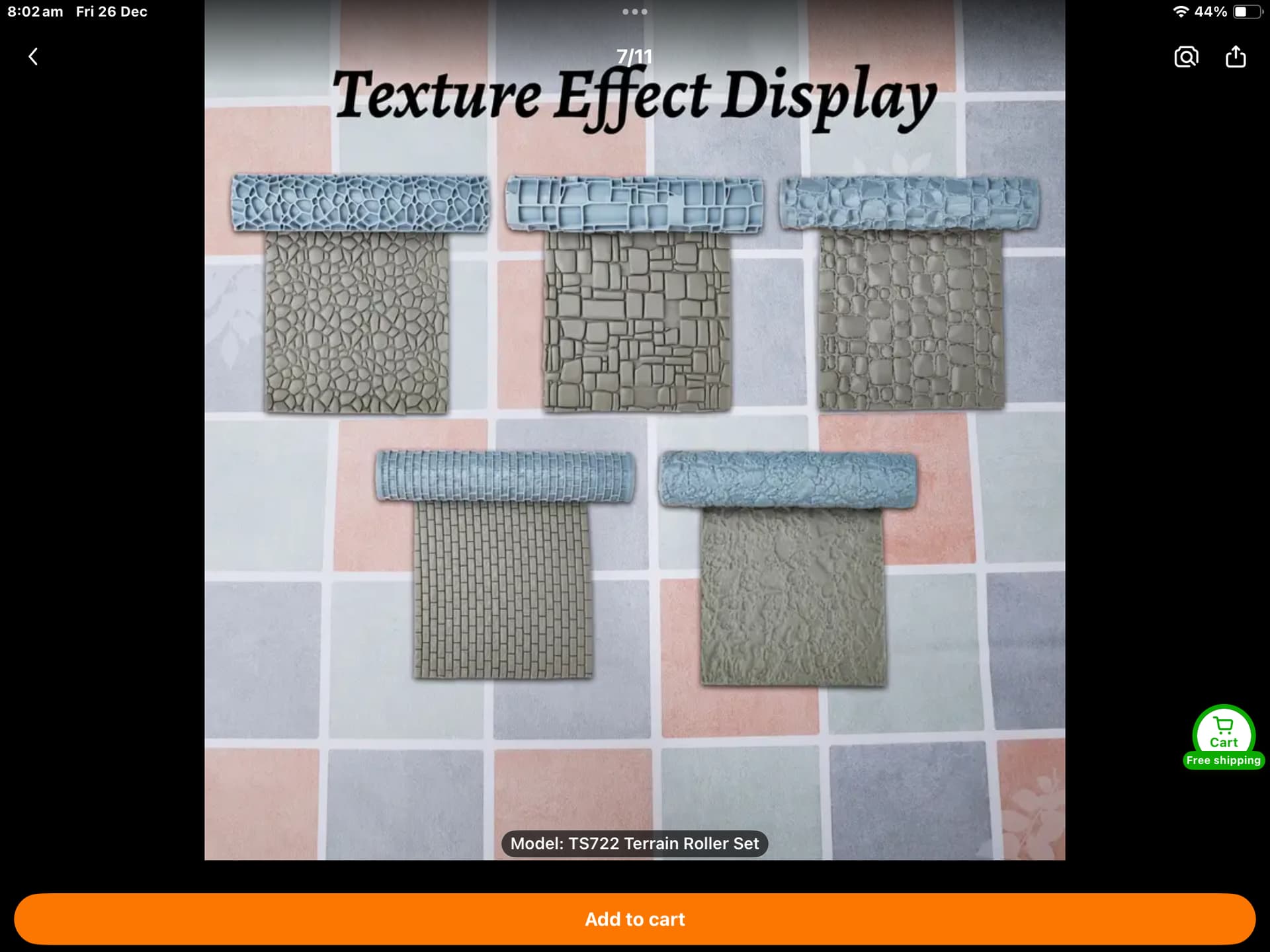

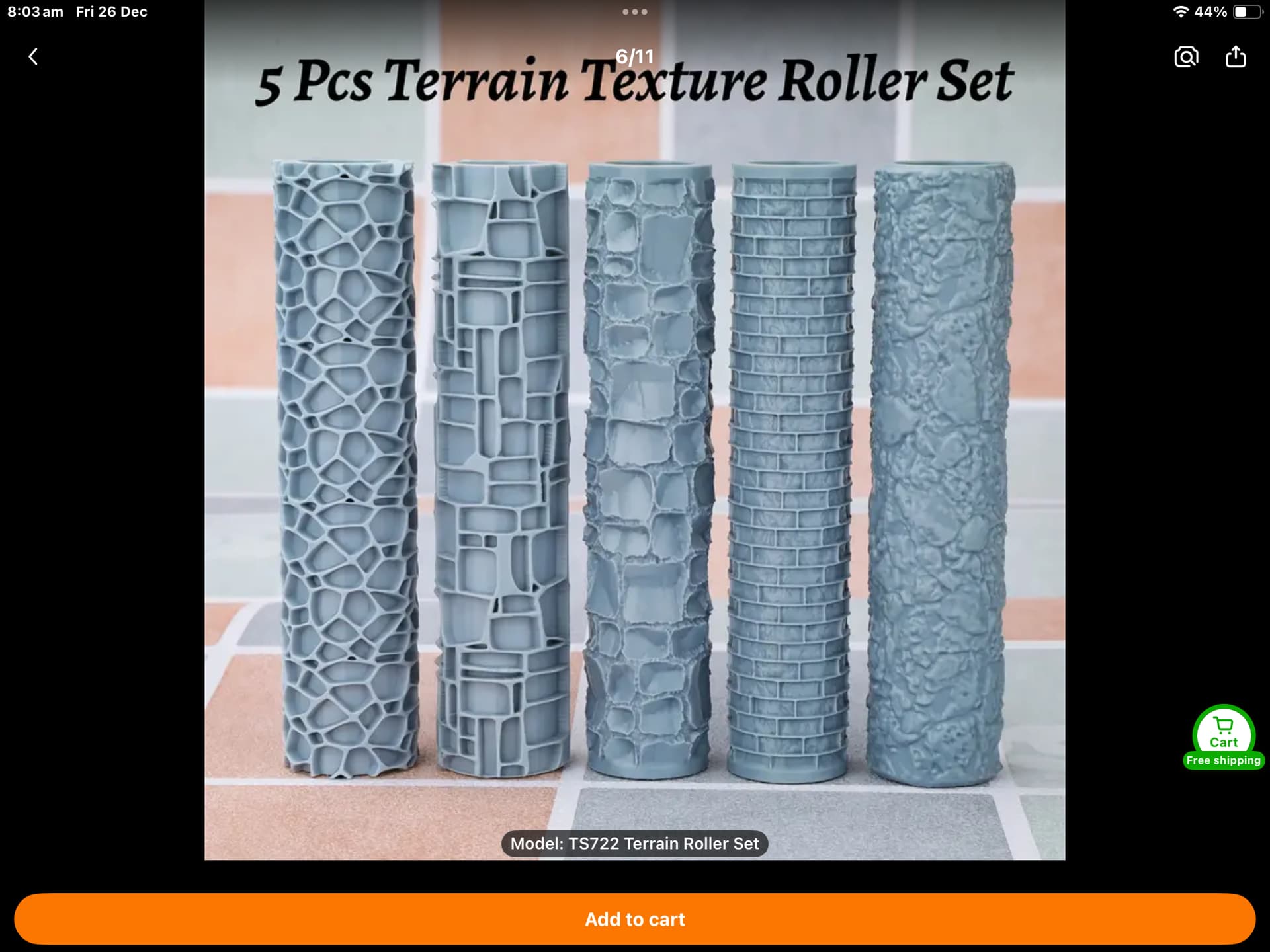

These are good to use with plaster and come in a variety of textures I found a lot of diorama items and at a good price on Temu .
Welcome to the forums dsbcahyadi. The terrain rollers suggested by Kitzo are the hot ticket. Can’t wait to see what you build.

Thank you for your input, but i have dumb question, is this mold to create the plaster?

You lay the plaster or putty down on your board or foam you are using as a base and then you roll the stencil over it and it will leave the pattern on it . Making the wall , roads or paths using foam only also look good but can be a bit more time consuming .
