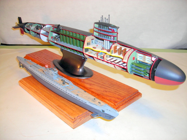

nino got me interested in this model with pictures of a finished kit. I needed a break on the Victory & built this . It has been fun & interesting. I got interior colors from Bill, warshipguy, & I hope I did it close to right.
Ther have been some really nice models of this already & I got a lot of ideas from them. They helped a lot. Here are some pictures.
I also have a George Washinton that I am going to do closed because it does not have all the parts.
This last picture is the 1/200 Ethan Allen with a Nicnimo IXC 1/200 unfinished to show the size difference.
I had to add this because I spent 5 days doing the IXC Nichimo. It really is a beautiful little model.
Niether one is mounted on a base yet & I am going to do a Riich 1/200 1944 USS Gato to complete the 3 set.

Steve, this picture I believe shows how I did the cut. I started & went in & out where the desk is & in again & cut a little off the partition outside the door & then in again & out before the next partition. Look at Phillip 1’s build, he did it a little differently. His is a beautiful build of this sub. I cut it rough with my Foredom drill & then used a sanding wheel to smooth it. Just be careful.
Steve, here is another that might show it better.

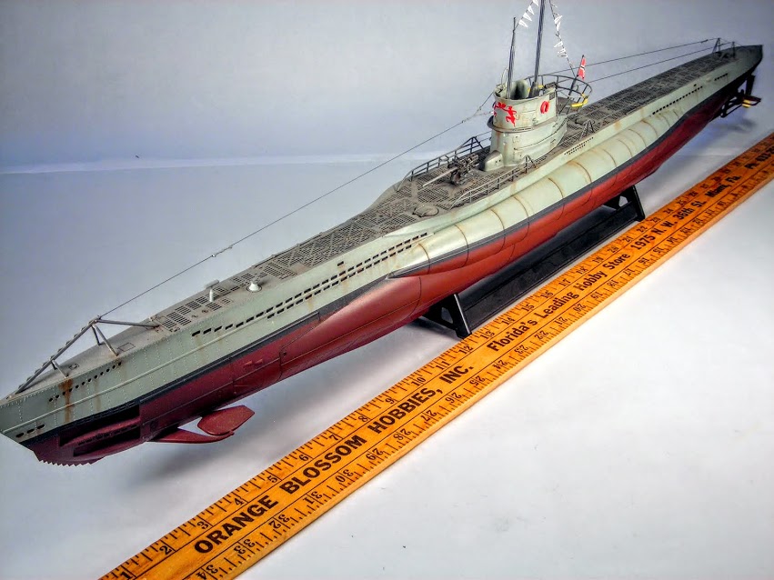

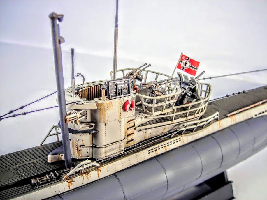

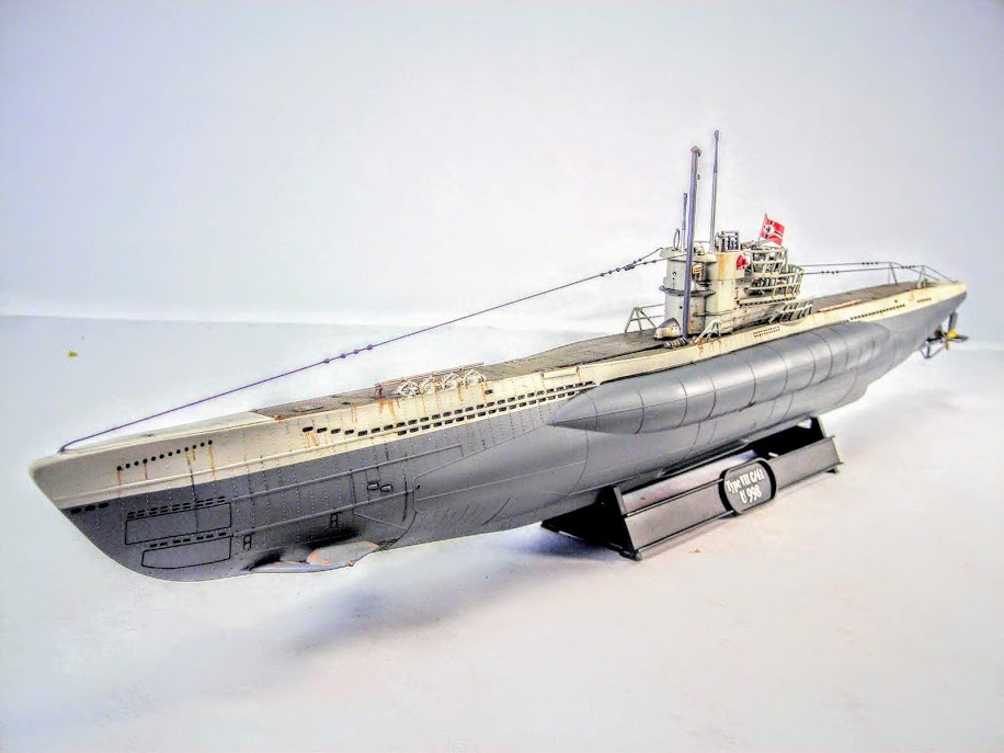

I have another of this kit Revell 1/144 VIIC 41. I built a bunch of subs about 6 years ago & loved them. I told a guy on the forum about your
beautiful R E Lee
VIIC 41 with a wooden deck.
My 36’ Revell VIIC

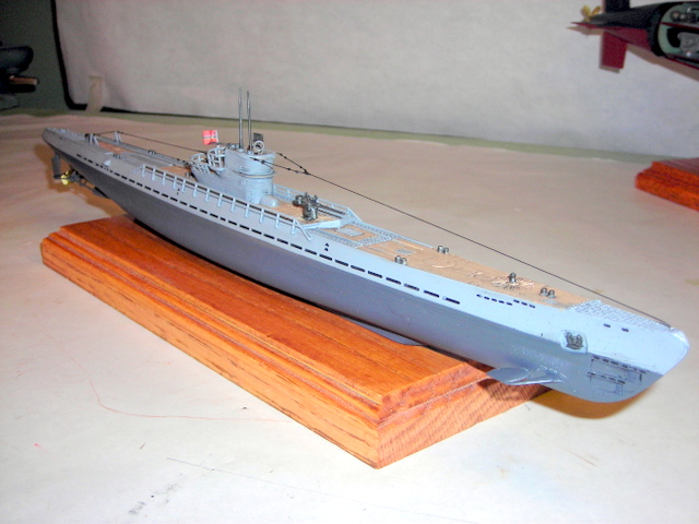

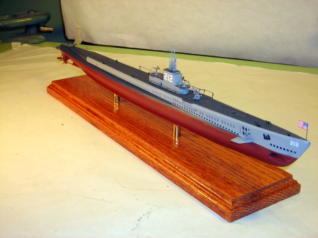

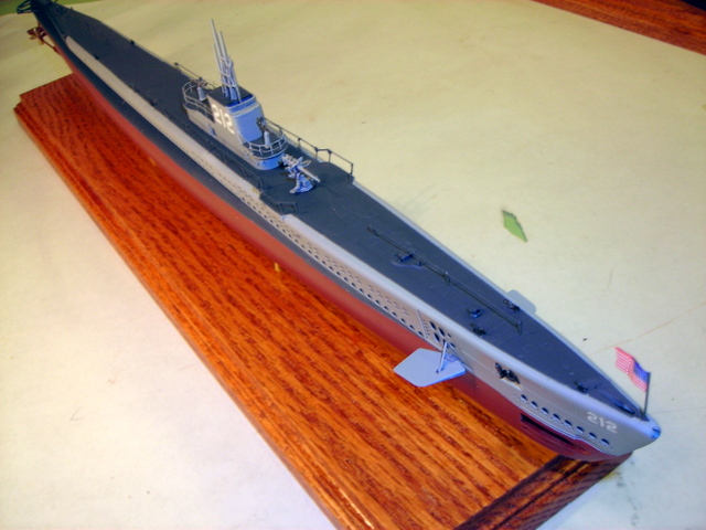

After I finished my Ethan Allen, I went ahead & built the little 1/200 Nichimo IXC U Boat. It is a beautiful little kit & has some very nice casting on it. Then I had just gotten a 1/200 Riich USS Gato & now I am just about finished with it. Nino gave me a 1/200 Russian attack sub & I will put the 4 together 2 from WW2 & a big size difference there too, but the difference in 15 years to the Ethan Allen Nuke is huge.
Here is the new Gato nearly finished .
Here you can see the difference in 1/200 sub size from 1945 to 1960.
I will do a few more of my Nichimo IXC & this Gato on another post.
Here are a few more of the Nichimo IXC.
These are really fun to build, but it is time to go back to the Victory. I will do some 1/144 subs after the Victory as the Revell 1/144 kits are my favorites.
