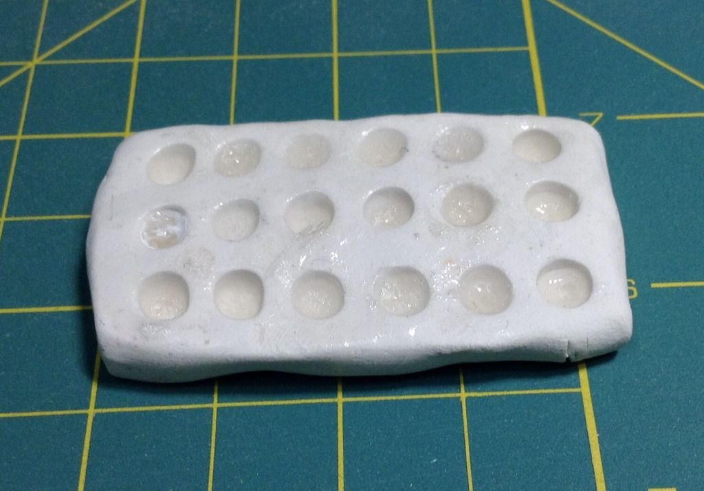

To minimize waste I use the smallest container possible to hold either CA or accelerator. I make the below from Sculpey polymer clay that is hardened in the oven. The indents are made using the end of a paint brush. This one has lasted for a number of builds. If you dump or clean out the glue it takes a long time to fill in the wells.
