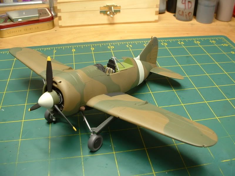

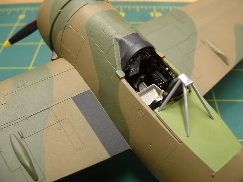

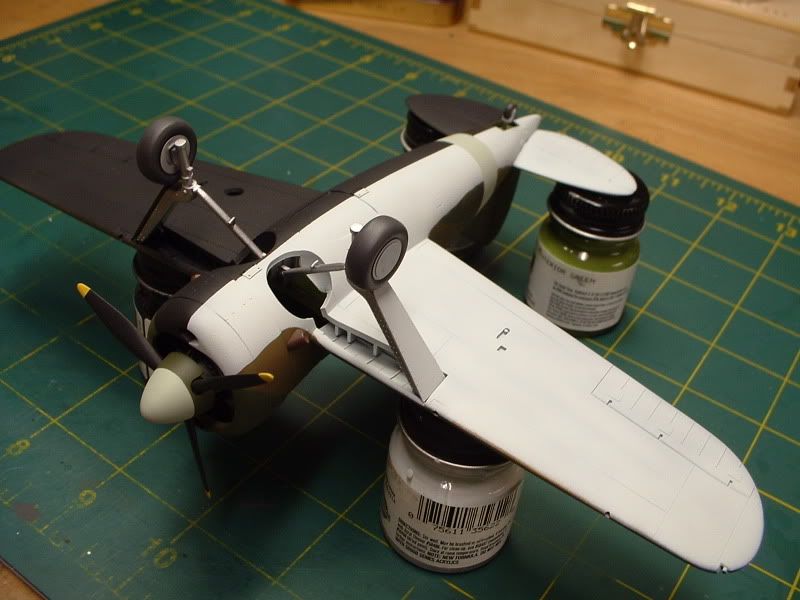

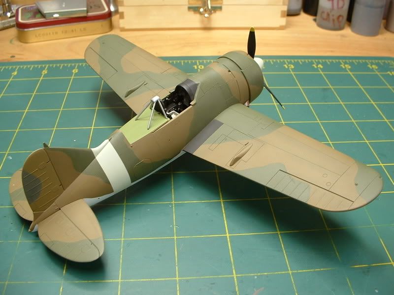

Here are some WIP shots of my 1/48th Tamiya Buffalo Mk.I/ B-339. The paint is all done. Just needs a coat of future, decals, washes,weathering and the canopy masked & painted. Decals will be from Aeromaster.
Very Nice work Mike! Really clean build looks really nice I guess I’ll have to build one of my 3 1/48 scale ones also now[:)]. She’ll be a knock-out once complete!
Tracy
WOW ! Sweet Build [tup]
Bud
That is nice Mike. What type/brand paint did you use?
-dave
I use Testors Modelmaster Acrylics & Polly scale. For anything metallic I use AlcladII.
Thanks for the info Mike. Just by coincidence, I ordered some Testors acrylic and Pollyscale paints this earlier morning to try out on an upcoming build.
-dave
