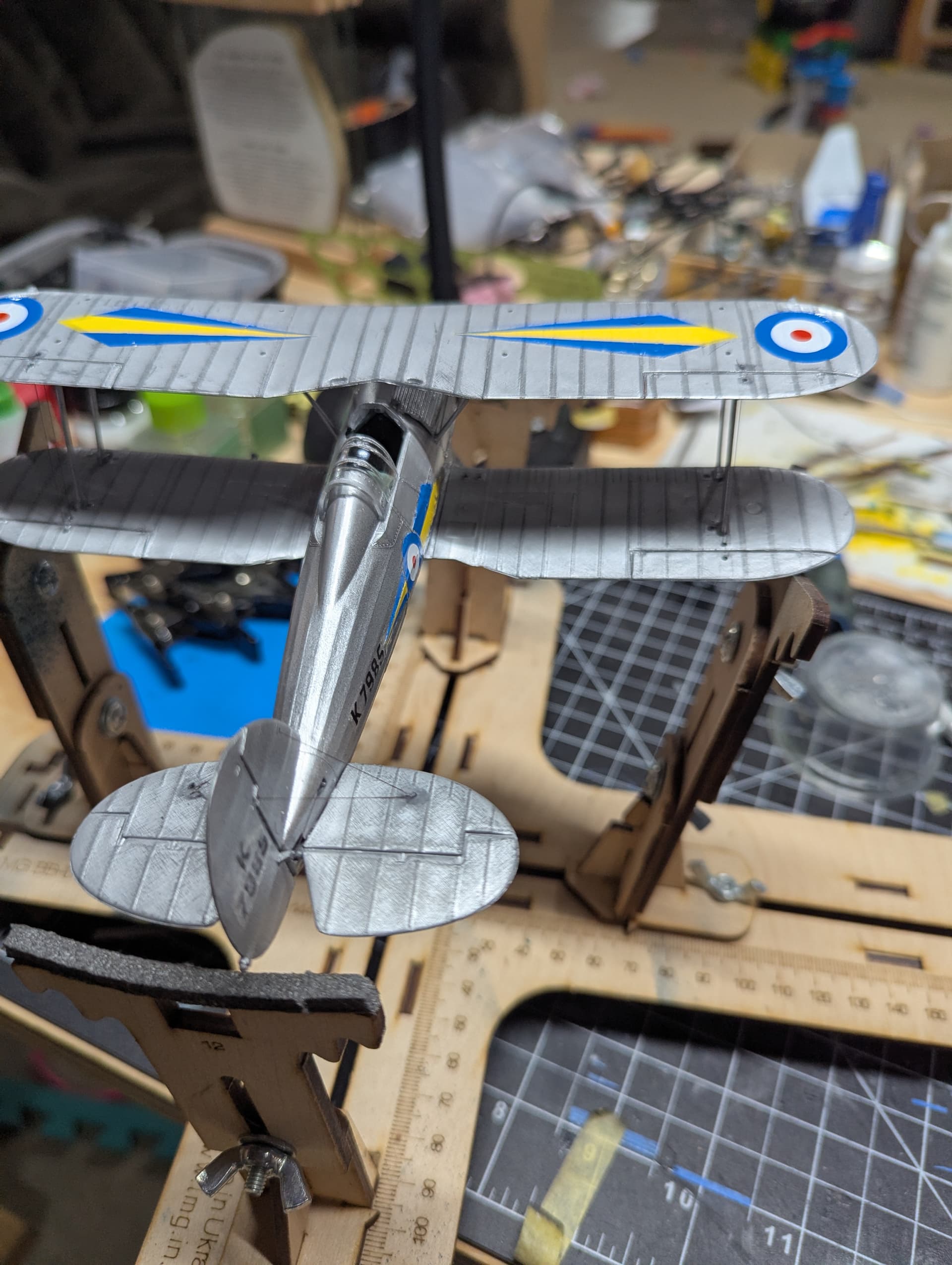

I did this with EZ Line and I like how it turned out.
I need to go back and take pics of the finished model. I thought I had but I can’t find them.

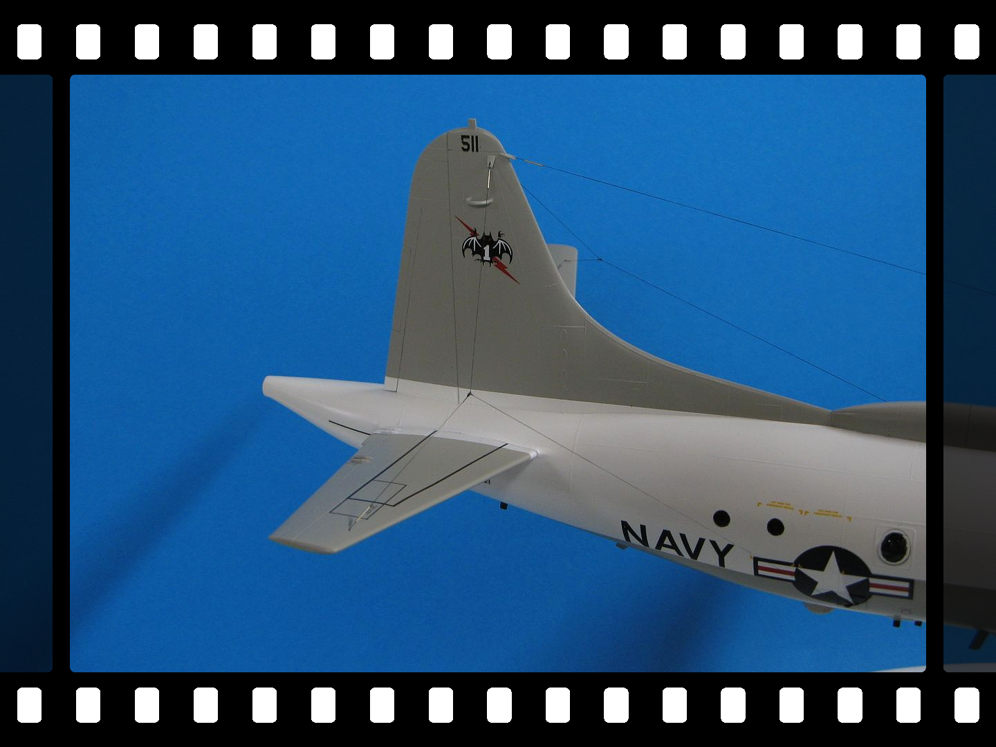

I started with E-Z Line for my EP-3 but, didn’t like the look when I stretched it out. It kinda had flat spots to it when viewed at certain angles.
I went with the AK Hyper Thin for 72nd, turned out way better IMO.
