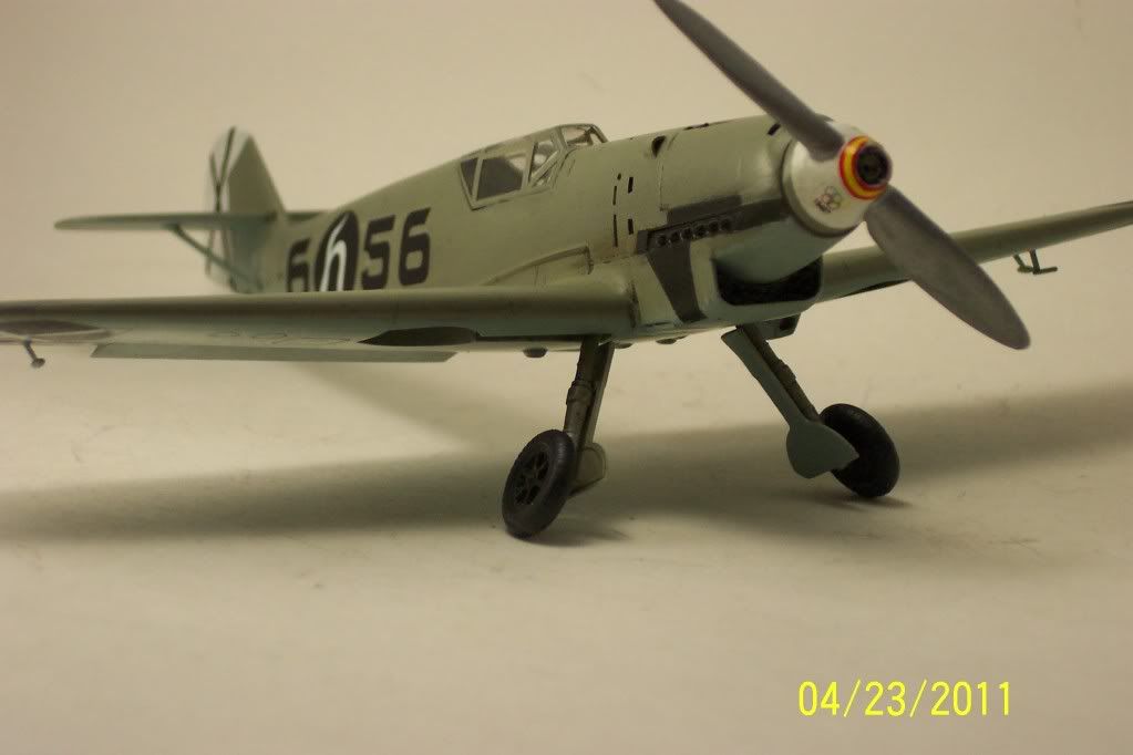

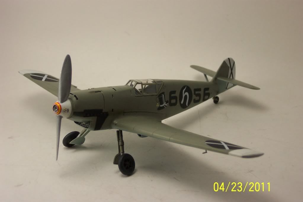

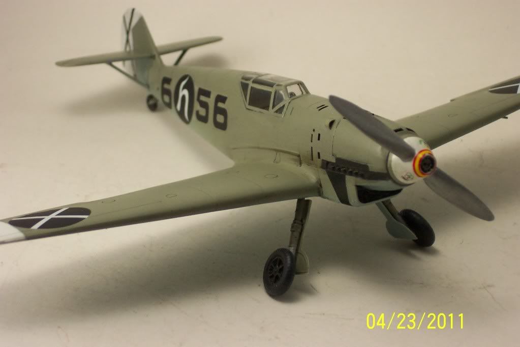

Hello, I did this build for the fun… picked up the kit at Downeast Con… 1/48 Scale, Academy Kit. .it looked like all the parts were there when I opened the box, but it was missing the correct prop, 1 flap, and the cowl carb scoop…

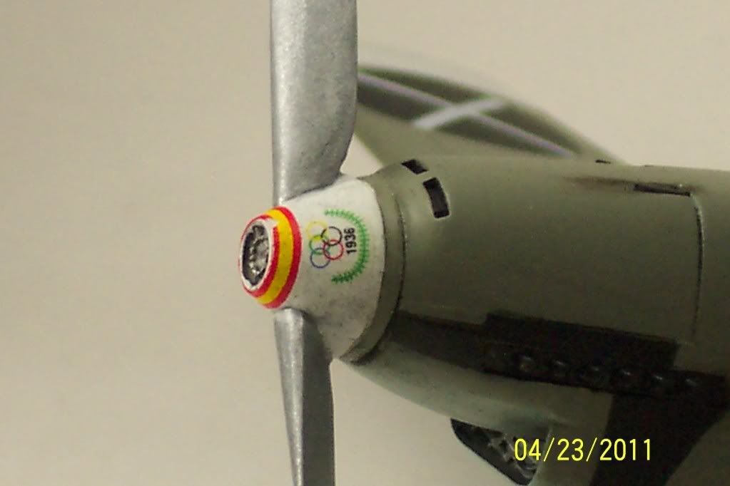

I reshaped the wooden prop as best I could and attached it to the metal spinner, scratched a scoop from card stock, and same for the flap…
I did a light wash, and mild weathering… from the few pics I saw, this plane was usualy clean, or did not get much weathering in the field…
Comments… suggestions… critiques… welcome…Photobucket:550:0

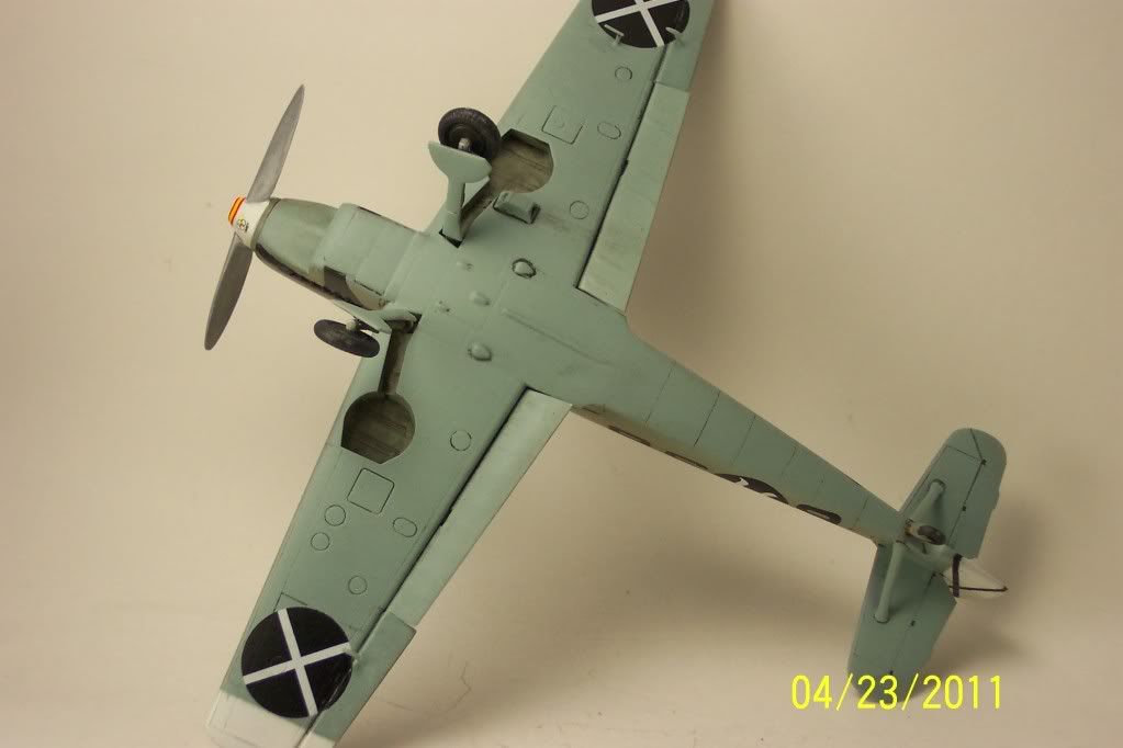

oh. I also added a screen to the radiator…
Superb, ol’ buddy. I remember seeing this version in an old aircraft profile booklet 'way too many years ago. I like the clean, crisp look to your Bf-109. I don’t want to marry it, but dinner and a movie would certainly be possible! [:D]
Clean, neat build !
Very nice job of replacing missing parts with scratch built items.
Always good seeing the early mark 109s as most of the kit builds seem to be of later versions.
For those of us who have not yet built the kit, what did you think of it?
I note MajMike has been learning Manny’s technique …wink, wink, nod, nod …say no more, eh?..[;)][;)][whstl]
nice job loved the pics.
Ron

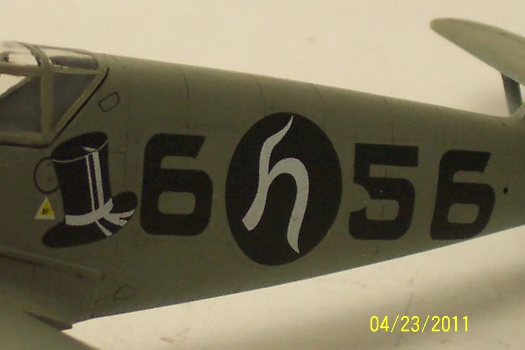

As for the kit, it was nice… easy build, good detail,( but not alot of extras) some other options are provided to build a C and other D’s, mainly exhausts. It fit nice and the detail was crisp, I did have to rescribe the panel lines on the belly and spine after sanding and putting the seem, not a major deal. It also has other decal choices, including a Mickey Mouse emblem,that was my original reason for picking up the kit. But after I looked over the choices, I went with this scheme… I also added hypodermic needle gun barrels, as this kit came with none for the cowl.
I used model master acrylics( I’m not an acrylic fan) , washed with Pro Modeler wash, Tamiya pastels for exhaust, and then Testors dullcote… (IMHO) the best dullcote to use…
PS… some have commented about the Landing gear looked a bit more splayed than normal… after comparing it to another 2 109s I have, it was…
there was some flexing in the join between the LG and wing, so I pulled them in a bit, dabbed some CA then hit it with an accelrator… that seemed to fix it… [Y]
Nice job, (as you stated) the gear might be spread just a touch too much, but the bird still looks great.
Thanks for sharing
I love it! But then I am a sucker for 109’s. I would marry her… only if my “Emil” left me. [;)]
