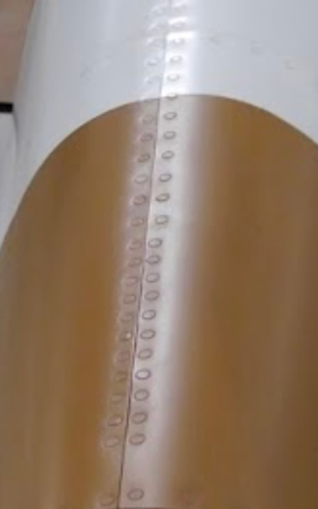

I was planning on replicating the top and bottom rivets that run along the spine and belly of the 109.
Now I think I’ve worked out there are approximately 22 rivets per panel X 6 = 264 from tail to canopy,then the same on the belly would= 528,that seems a lot of rivets to do individually.

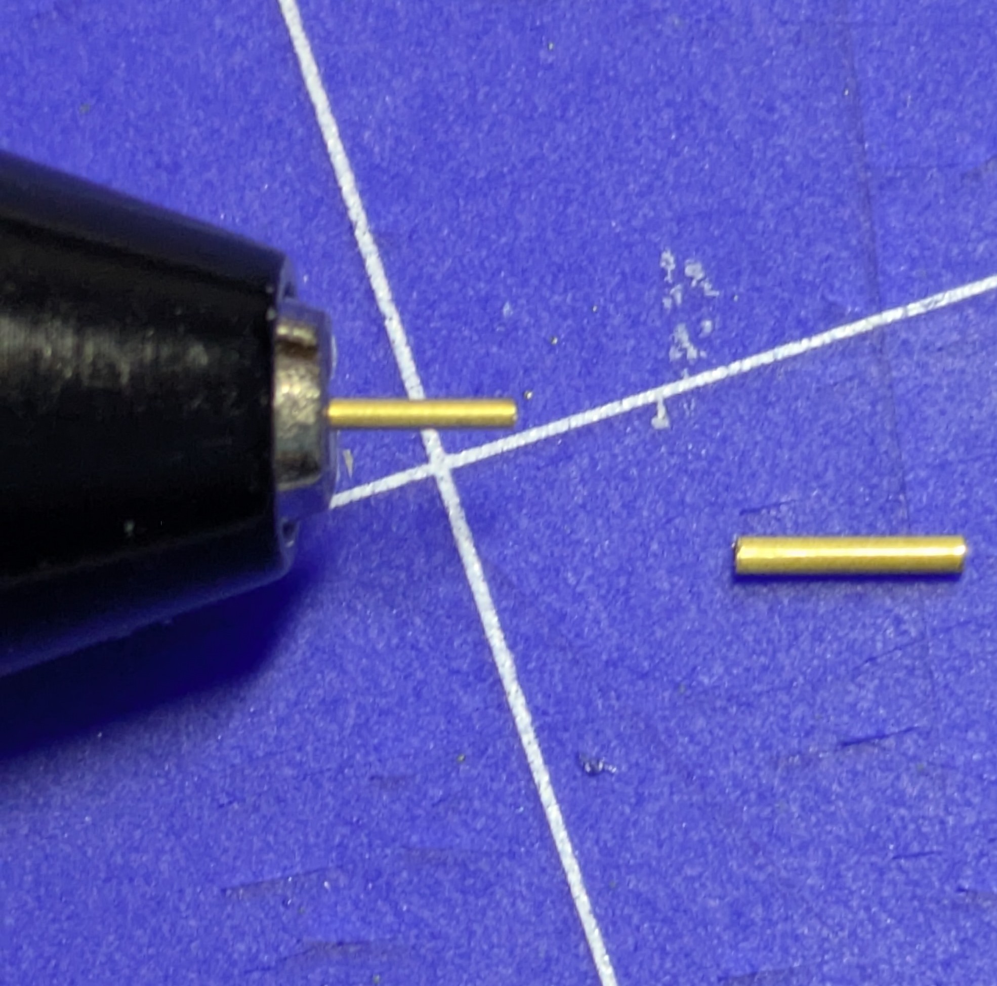

I won’t be using a rivet tool but a 0.3mm brass tube as when pressed into plastic gives a great impression of those rivets.

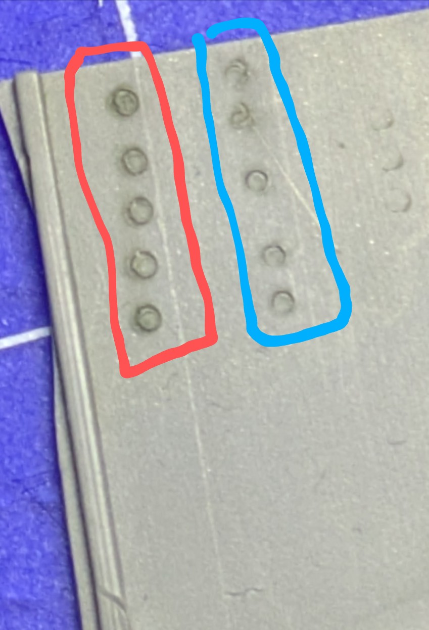

I will demo it on a scrap piece of plastic and upload a photo in a while.

Just did a rough try on some plastic.
Red area 1mm brass tube
Blue area 0.8 mm brass tube
