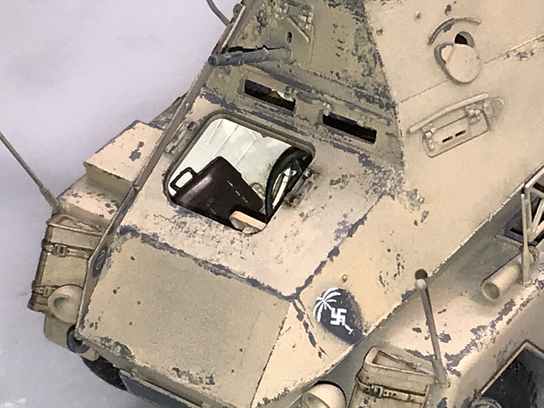

[dto:] Although I’m not a fan of acrylics I used the Vellejo Air RAL 8020 and it sprayed and covered very well on this 8 rad I’m working on. Vallejo has an extensive RAL selection which is a plus.
