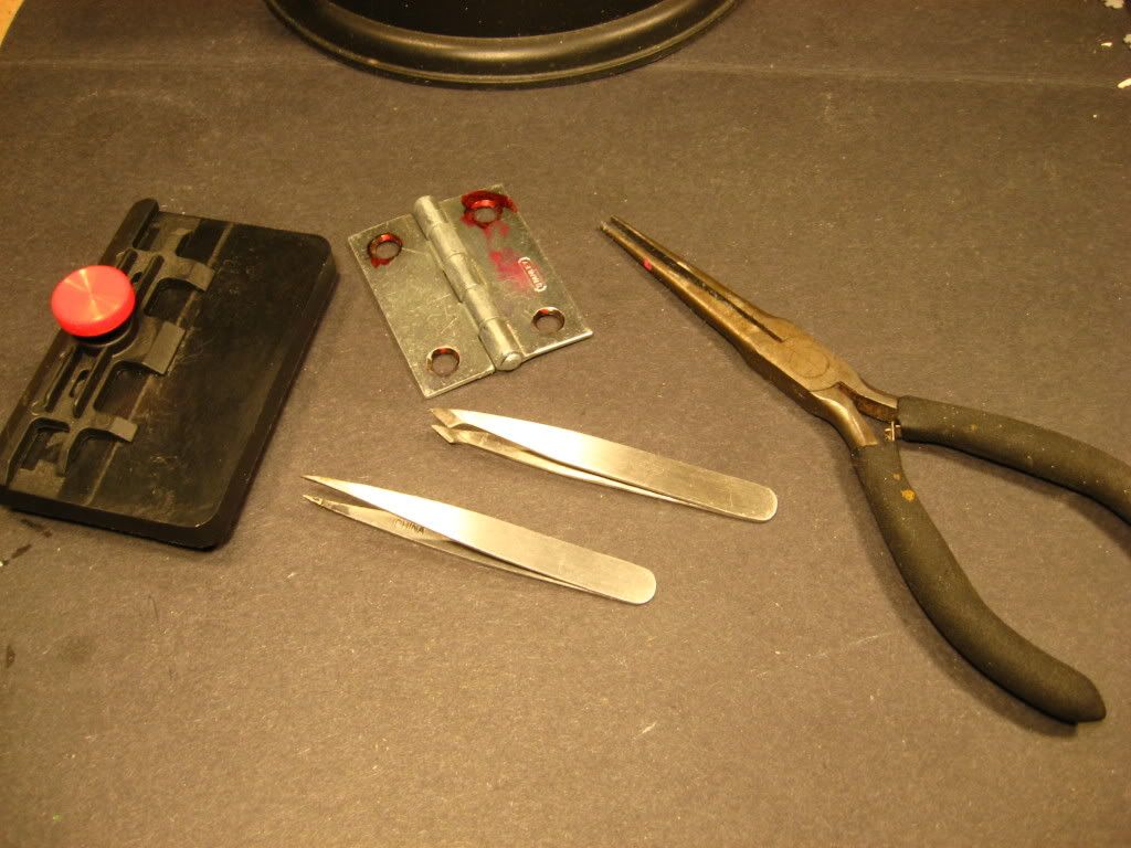

Honestly, my best tool for PE is my Optivisor. I can pretty much bend mostly anything as long as I can see ir well enough. I use straight-edge razor blades, several exacto blades, a shaprening stone, and a steel ruler.
Hey Boyd here’s a picture of some of my high tech pe tools.
And yes that is a cabinet hinge. I have three of them all different size’s and they work great for bending the longer pieces. I use these more than the pe tool itself.
Total cost for all my pe tools twenty dollars.

It is ironic that you posted this. After I wrote this, as I was driving home, I began thinking about how I could make a more efficient ‘DIY’ photoetch tool. I said to myself, “Hm, Self, you know what, I bet a set of different sized hinges might work pretty well…”
Thanks for confirming my suspicions!
