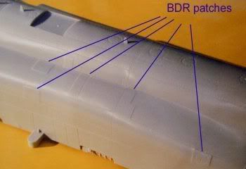

All come with boiler plate size patches all over the fuselage so these will have to be sanded away.

Tamiya is the way to go for Phantoms as far as I’m concerned although I do seem to remember that the F-4C/D version has a strange problem. If I recall correctly; they based the kit on an aircraft that had had battle damage patched up. These patches are raised panels that would not be found on any other aircraft. Of course my memory may be playing tricks on me. Perhaps someone more knowledgable may able to confirm, or refute, this.
Your memory is correct. The Tamiya F-4C/D/E & J have scab patches all over the fuselage. They all suffer the same “Boiler Plate” size patches. When scaled up they would be the thickness of armor plate or boiler plate.
This is what Berny’s refering to. Some have called them BDR patches (aka battle damage repair) but I like what Berney said, “Boiler Plate”. Whatever they call them, they should be removed.
