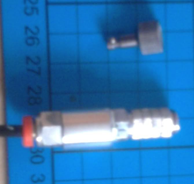

I have recently bought a Badger 105 patriot airbrush and I’m looking to find an adapter to fit my hose.
I haven’t a clue with adapters and hoses so any help would be great.
Below is an image of my current hose (air brush end) and a quick release that fits it that I use on my current air brush.
http://i651.photobucket.com/albums/uu235/Dahlvash/1-1.jpg
Any help would be great!
You should be looking for a quick connect adapter suitable for Badger, the thread is Badger specific so you will only find it in airbrush outlets. Here’s one, but there are plenty other sources;

What you need is the Grex AD19 Quick Connect Plug (nipple) for Badger Airbrush from Chicago Airbrush Supply. It is only $3.50, but you will pay 2+ time more for shipping. The Badger makes a similar part too, but it is almost impossible to find.
It is best to ask your Patriot seller to order one for you. Local pickup may the cheapest way to go.
