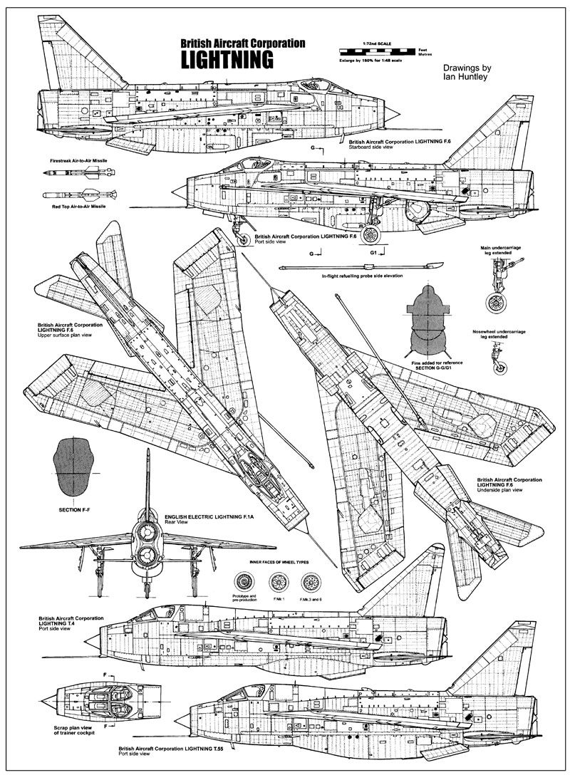

…I’ve found on a pubblication this:
fot the tail all is ok…but for the cable ducts…what are these particulars???Are internall???Ciao Enrico
You can see it here- it’s that long half round shape that is just above the fuel tank. It runs from a point just forward of the moving tail plane, to a point below the cockpit. Port side only.
hi Bondoman…I’ve understood…but are you sure “port side only”??I’ve some design of an Mk6 and in there the ducts are present both sides…This image is property of WARPAINT SERIES N°14 and has posted only for modeller discussion.
The cable ducts are fitted on both sides, on the F.3 the cable ducts are the longer ones which extend past the front wing root as shown in the F.6 diagrams at the top of your page.
