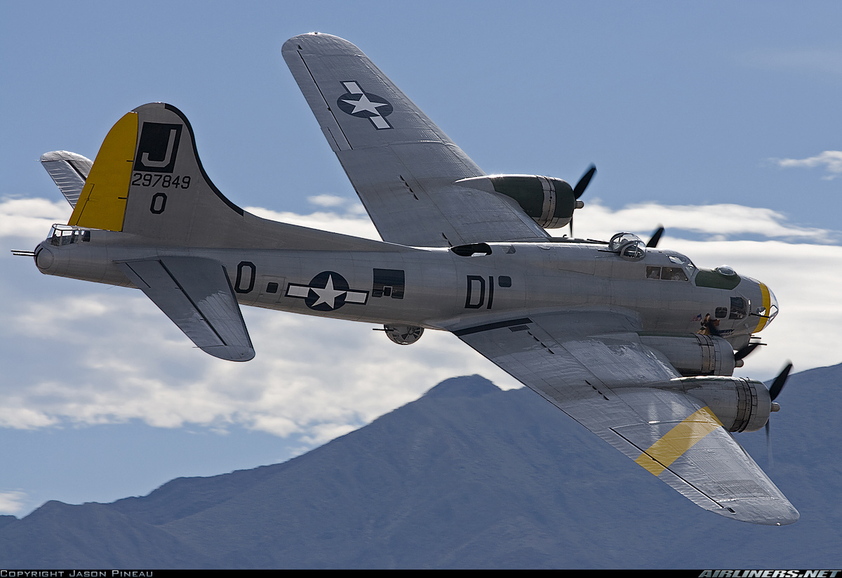

Probably minor oil leaks as seen in this modern image from plumbing for landing gear and the intercooler. Although modern B-17s don’t see the usage that a wartime B-17 had.
Then you have HEAVY staining on the bottom from oil and exhaust.

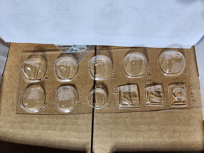

Yes, I got the old Koster B-17F Nosejob vac-u-form kit.
I doubted that I could get it done in one try and I did not want to damage it. Having never done vac-u-form before, I thought I’d better try to save the Koster original.

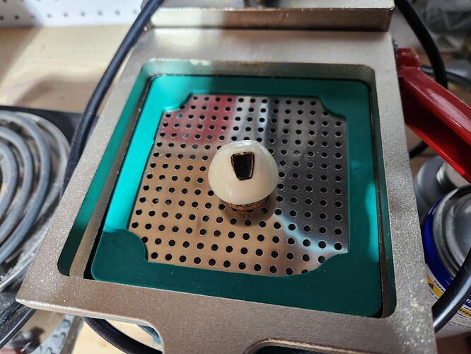

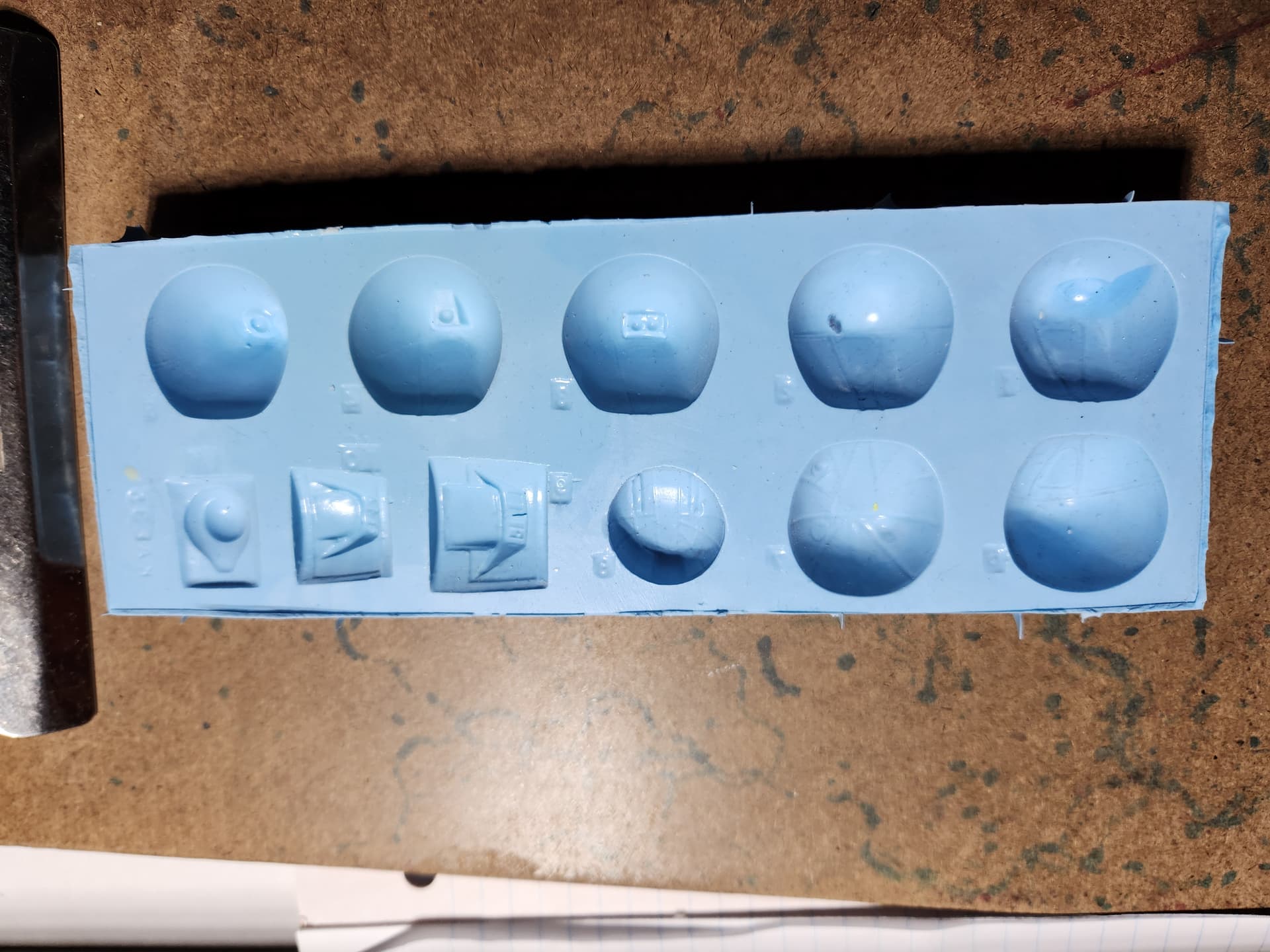

So I made a rubber mold of the whole thing.

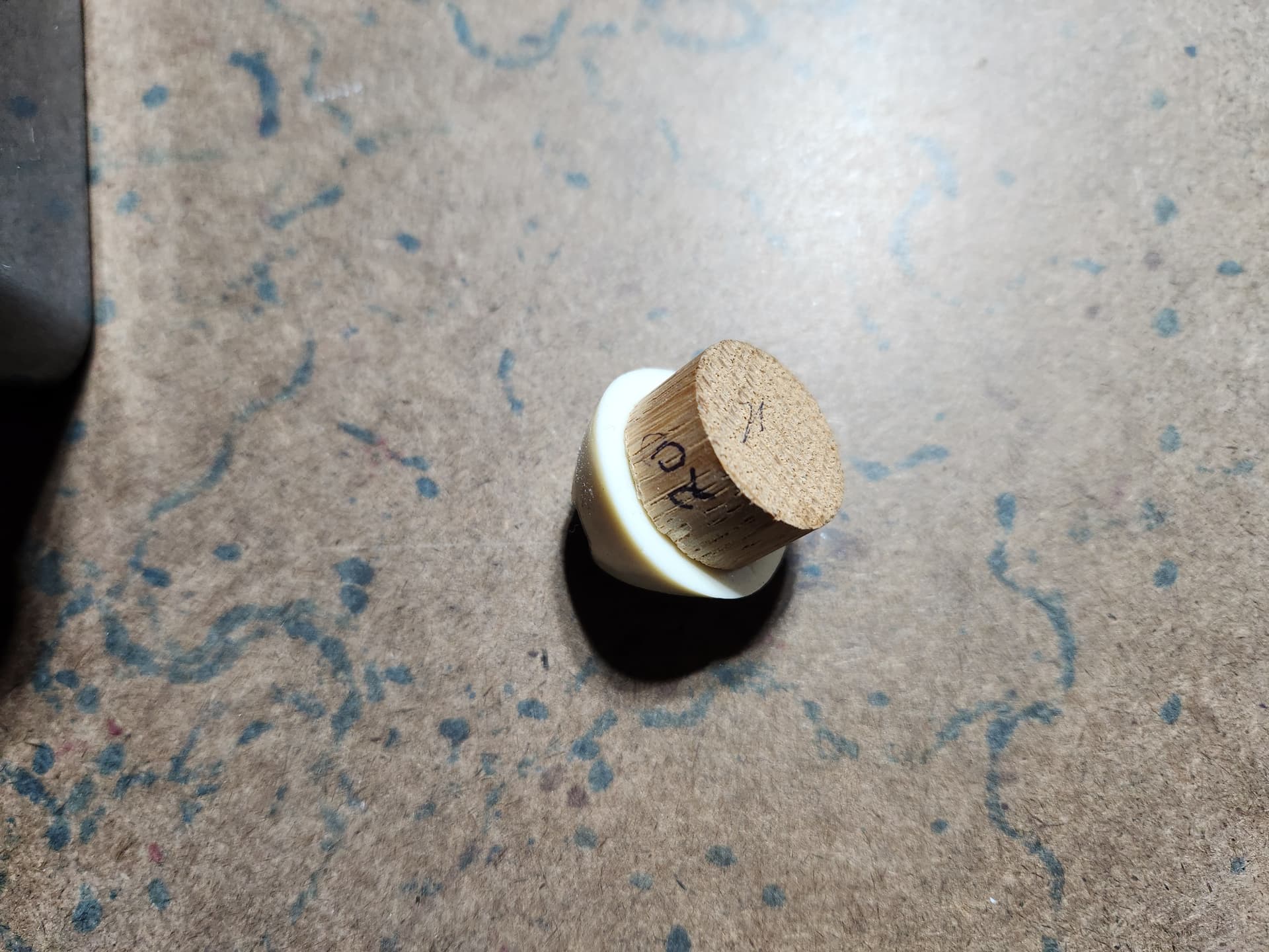

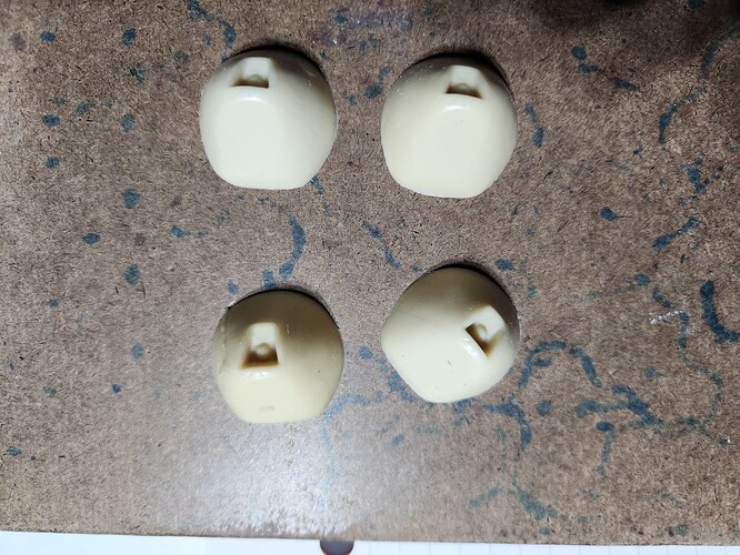

I filled the mold I wanted with resin and made several slugs.
I attacked a piece of dowel to each slug.

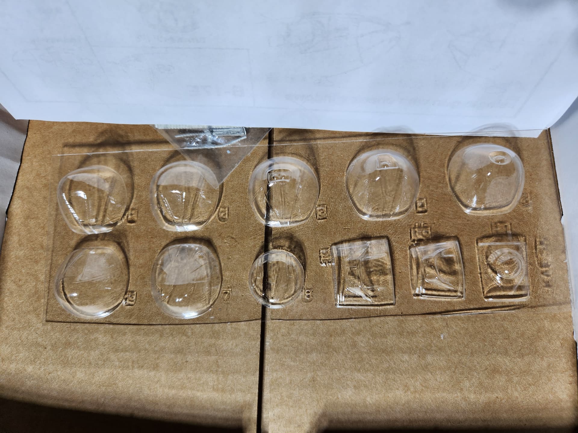

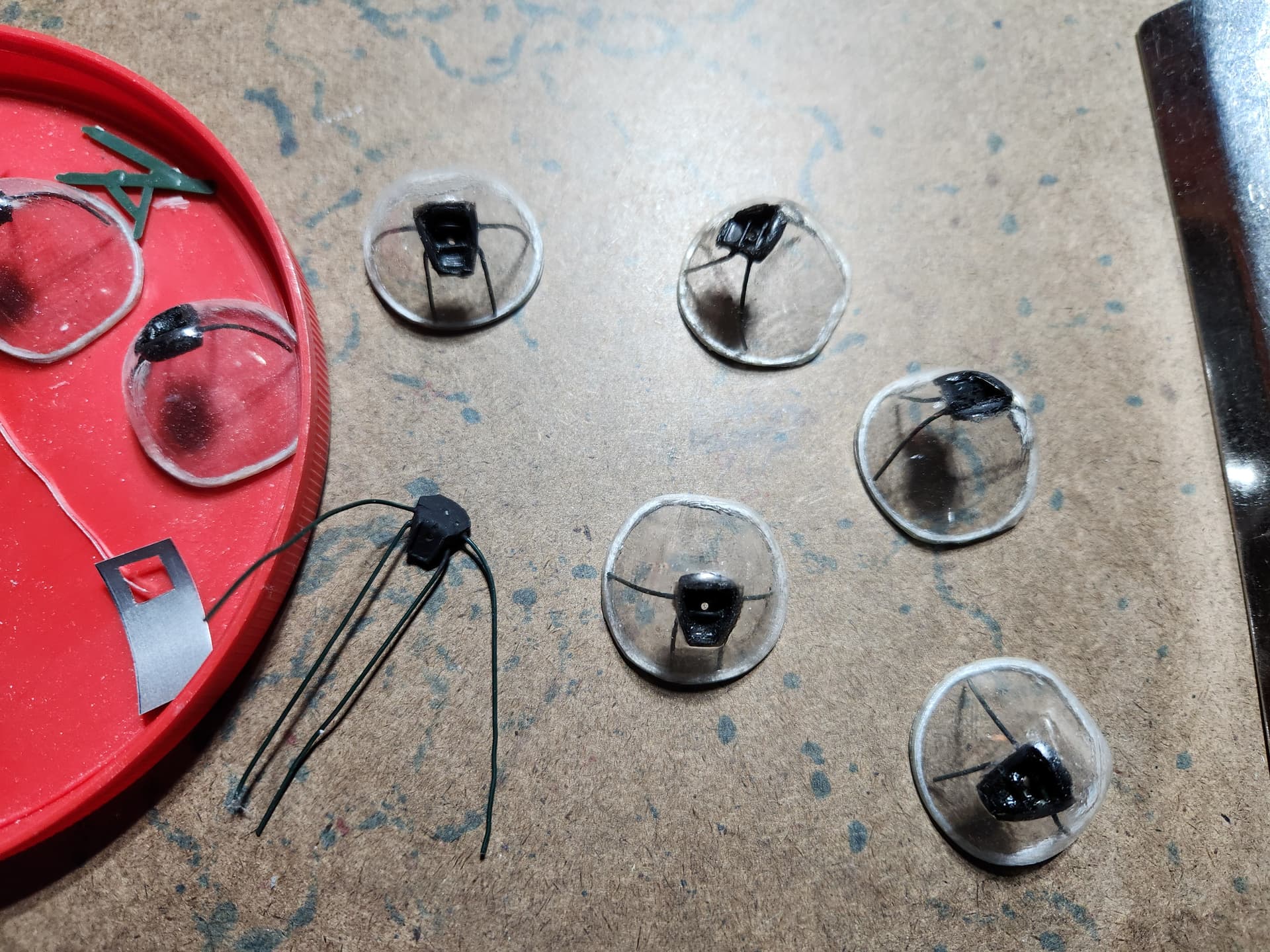

I then used a vac-u-form machine to make ten copies.

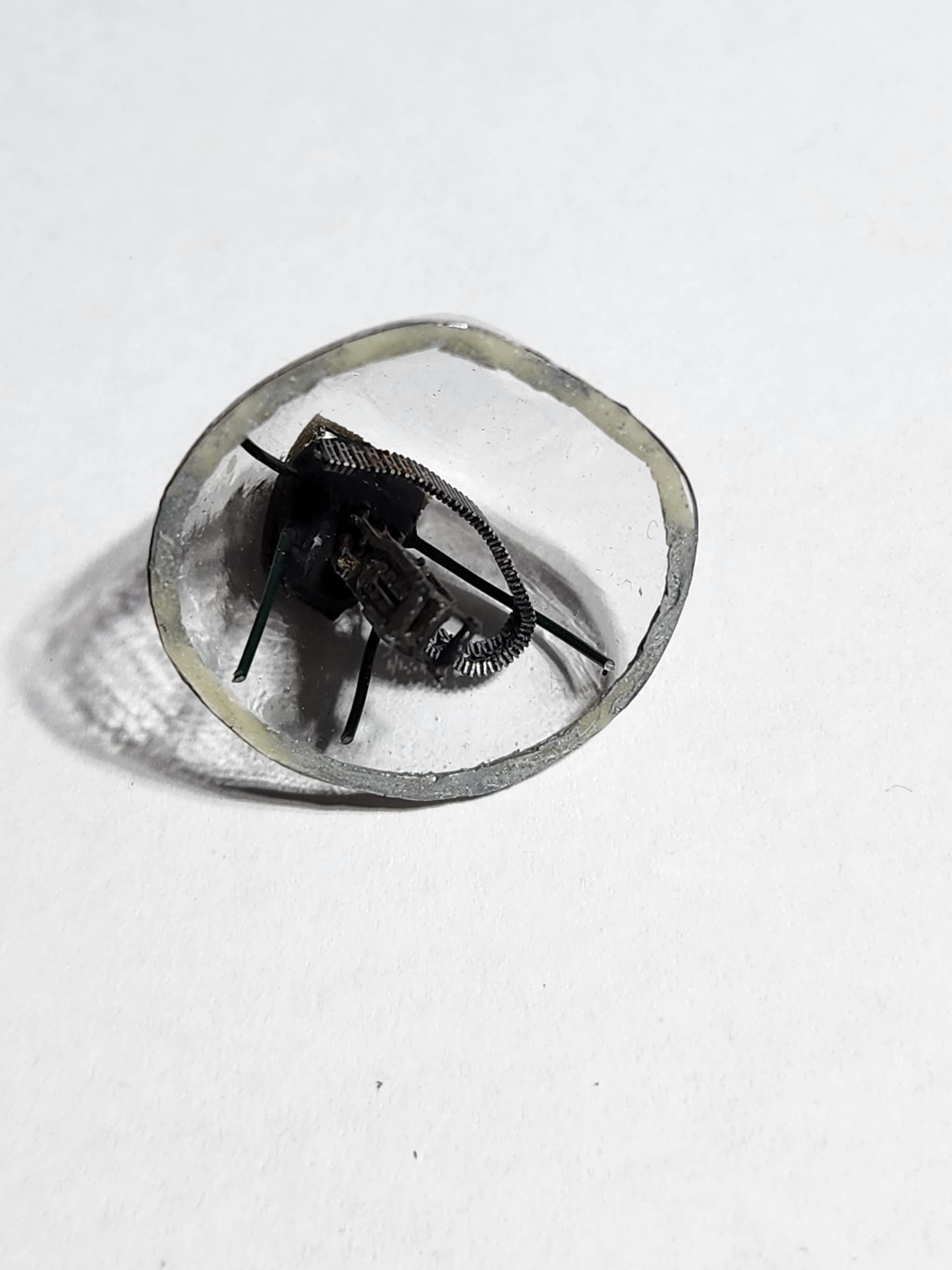

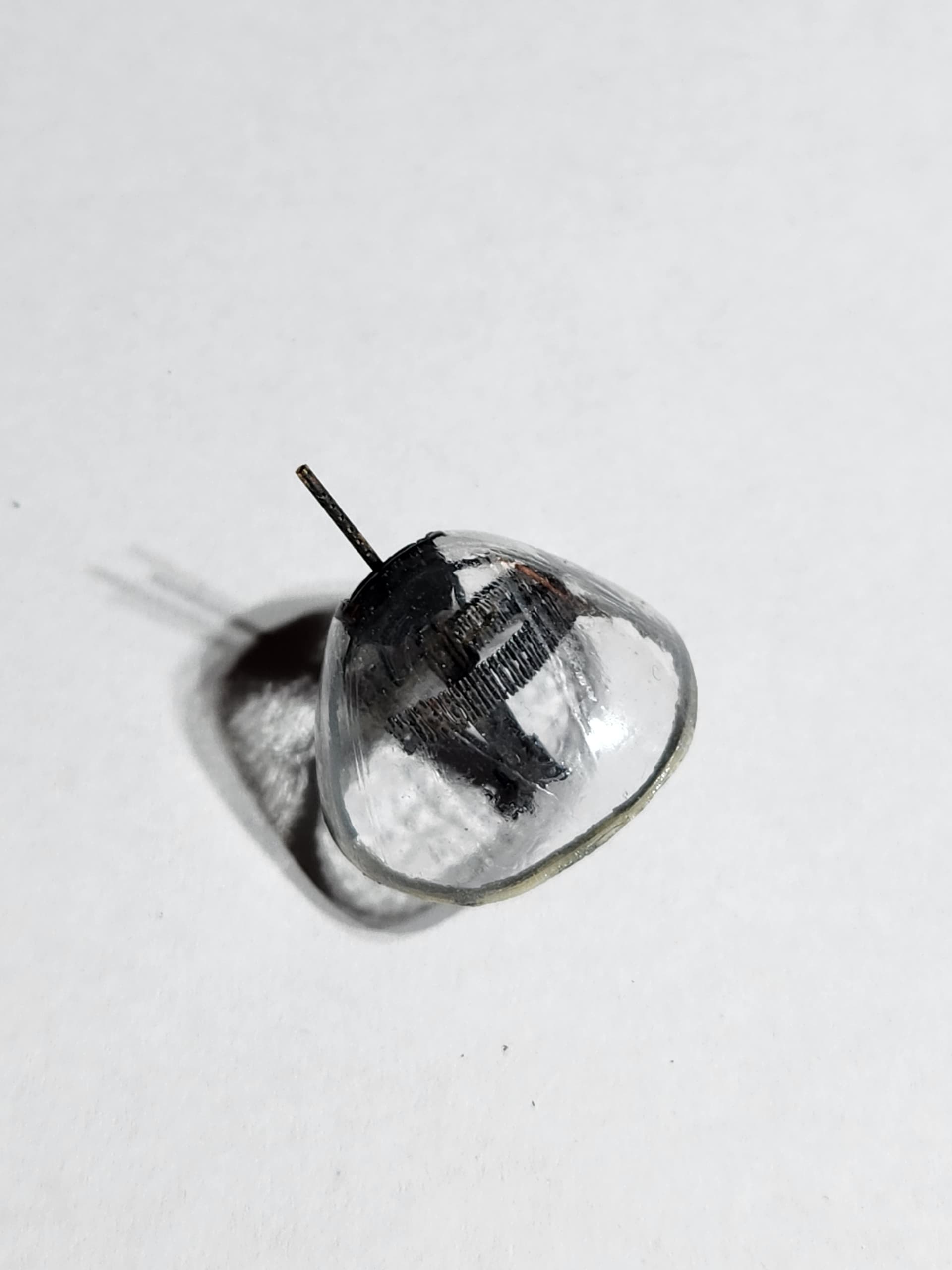

I cut each copy loose from the slug and base which gave me ten copies. I constructed the wire bracing from Christmas ornament hanging wire for each copy. So I had ten to work with.
I made them all identical and made a circular base out of sheet styrene and attached it to the bottom of the best copy. This is the result with the machine gun. It is ready to be attached.
