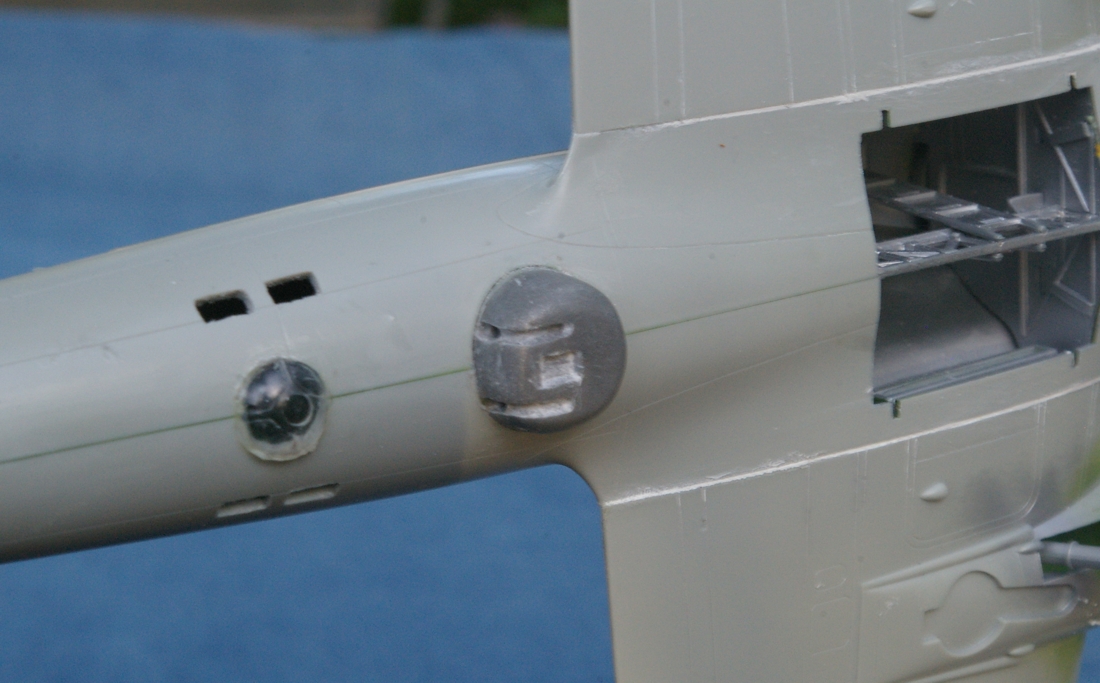

Well I finally got the side windows gnawed in, just need to clean them up a bit. Not sure what I am going to do for glass yet. I heard about something called Krystal Clear to make them or may just use clear sheet stock. I am covering the ball turret opening from the inside with sheet plastic. Then I am going to attach the top turret flange from another F kit and fill in around it to make the mounting for the Bendix turret. Then finish it off with a highly modified F top turret. It is difficult to find decent pictures and diagrams of the underside of an early E. I even have the Army operators manual pages to look at and it shows just a general representation of the turret and windows, so I had to improvise.
Here are some shots of the belly turret prep. I covered the ball turret opening with card stock from the inside, then glued the new turret ring in place, then cut out the center. Then I took my almost dried out tube of Squadron green putty to fill in the gap. Still have some filling and sanding to do but did some dry fitting of the turret to give an idea of what it will look like:
Not sure if it’s worth posting, but here is the latest progress. Wings assembled and painted and fuselage is assembled and the underside painted. The finish will look better once the dullcote is applied and blends it into an even sheen. I could not find any close up photos of the Bendix belly turret, although found several drawn diagrams, all of them different. So I punted and went with my best interpretation of what I think it looked like. I am painting it in the markings of the 17’s that participated in the Battle of Midway. Here again there are no clear photos of the actual aircraft and only a couple side view drawings and a couple models I found on the internet to use as references, all of them different. Again I took them all and put them together with my interpretation of what I think it should look like.
