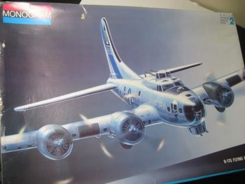

Hi all, I have got hold of a Monogram B17 kit and want to add quite a few extra details and was wondering if anyone knows a good site to order them, I have already ordered some bits for a different project from Hannant’s and after looking on their site I think I should be able to get quite a few extras from there unless anyone has better advice. I have seen they do engine detail kits, but wanted to ask if the set is for one engine or for all four?
I best point out I dont have the skills to scratch build anything and believe me I have tried, lol

Well , I spent a few mins looking through the kit and I’m not impressed, there seems to be a heck of a lot of flash on loads of the parts, think I will change my mind about all those extras tilI get a better kit,
Flash is really not that big of a deal, a pain to clean off but not hard to do. And unless you get one of the newer releases of that kit such as the visible kit or the pro-modeler kit, there is no better B-17 kit in 48th scale, unless you wanna hold your breath waiting for the very long anticipated tamiya B-17 with rat a tat tat machine gun action. Seriously, this kit dates back to the 70’s and it’s not a shake and bake tamiya kit, modeling skills are required.
