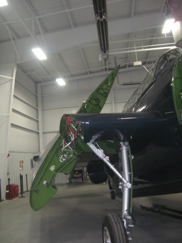

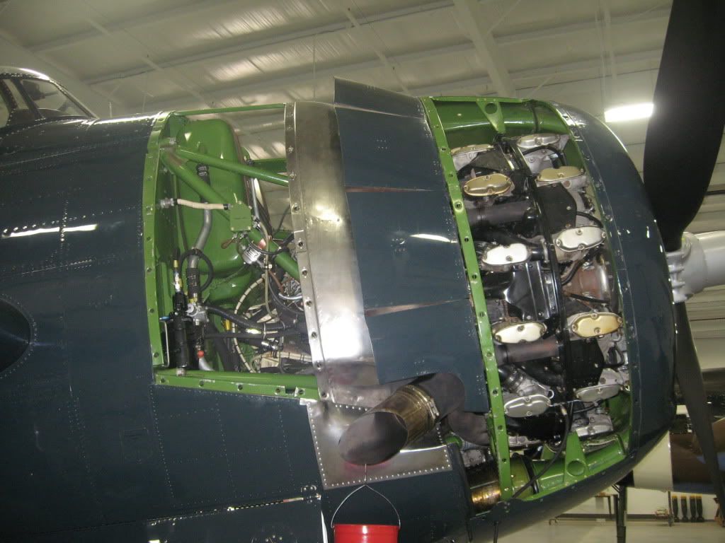

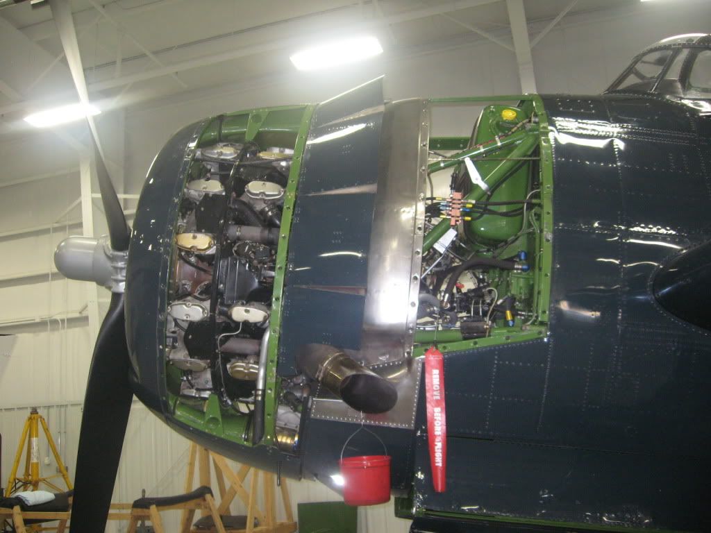

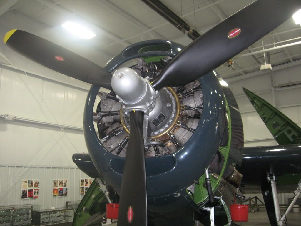

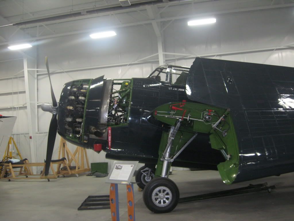

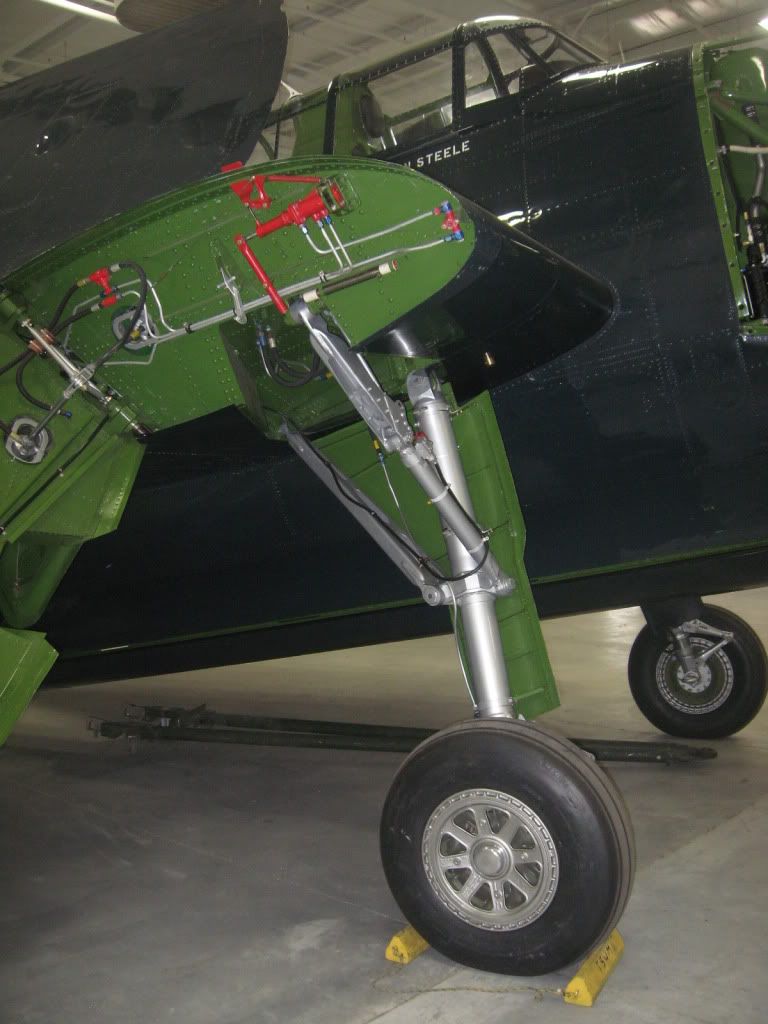

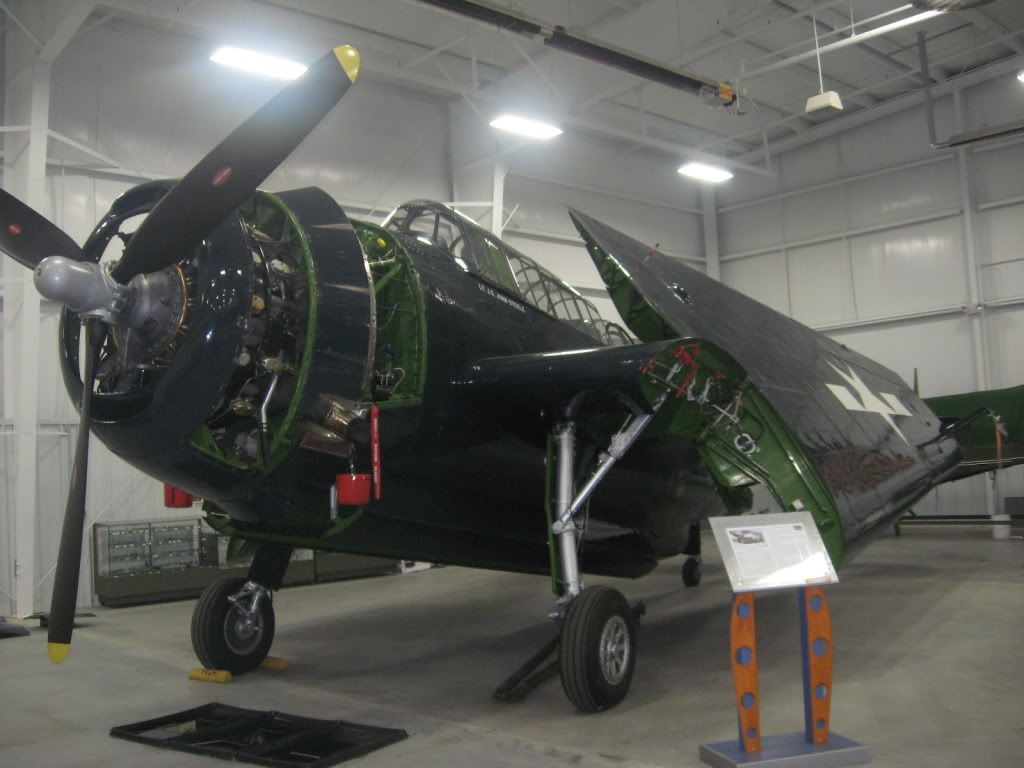

Thanks for the color tip, for I am planning one of each. Here are some photos for you, and all who responded to this thread (in humble appreciation), and, what-the-heck, all y’all Turkey lovers out there (TBM-3 from the Tri-State Warbird Museum, Batavia, Ohio - this bird flies). Enjoy [:)]:
She sure is pretty Ordie. Not historicaly accurate on some of that green, but just the fact that she is an operational airworthy Turkey makes her gorgeous!
TBM Avengers warming up aboard USS Enterprise (CV-6), May 1944.
Stik,
Yep, she’s gorgeous all right. Being fair to the Tri-State Warbird folks, they bought this one already restored and airworthy - they try to do better with details, like paint, in their own restoration shop, though I believe the results do sometimes vary with circumstance. This one has been in some TV documentaries featuring TBF/M’s in flight, BTW.
Edit - As for color, I know that Navy birds usually reprise the base color of the A/C - or, rather, the bottom of the A/C - on the inside of the landing gear doors and in the wheel wells, which would be wrong on this TBM. Where else do you see an issue with the green? Shade seem OK to you? - end Edit.
2nd Edit - OK, I put on my glasses. I see the inside of the wing fold in the historic photos appears to be painted the underside base color, also - end Edit.
I’m always amazed by your alacrity in finding appropriate historic photos and/or information on various topics. Thanks!
Ordie
That looks like it is a TBM-3E, the E model had the stinger gun deleted. The gear bay and inner door should be matching the color of that particular paint scheme. All others where white.
