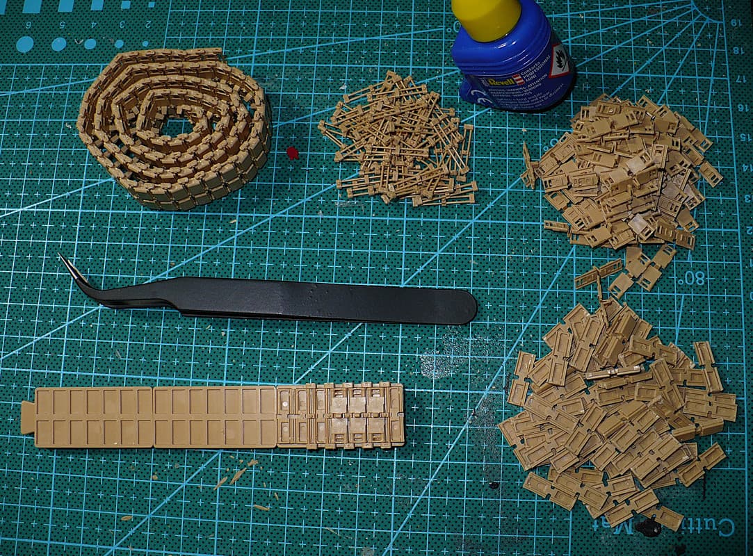

I’m working on Takom’s Tiger I and it has link and length tracks with separate guide horns. They have you attach the horns to the track in groups of ten. Once they are dry, snip off the attaching bar, and voila, half of the horns fall off. There is no place to put the glue except a pinpoint size attachment point on each side of the horn. After almost 2 days of trying different methods of gluing and snipping, I’ve assembled the 8 links I need for the turret, but I’ve given up on assembling the rest of them. I’m ordering a set of Friuls for this guy.
My question for anyone who has assembled these types of tracks is how do you do it? I know several manufacturers have kits that feature these tracks and am curious how others have attacked them. They can’t all be as bad as these, can they? I doubt I’ll be trying another set of these anytime soon.
I put together a set of Modelkasten track for a Type 3 Chi Nu IJA tank, and it had separate guide horns that attached to the tracks just along the perimeter of the contact surface, much like your Tiger.
I just set the guide horn in place and then dabbed a bit of Tamiya Extra Thin cement on the joint. I did a little adjustment before the glue dried, then cleaned up the sprue stubs afterwards. It was tedious, but relatively straightforward.

Meng Bergpanther two horns per link which weren’t tooo horrible but note where the three HUGE sprue attachments are located. Yes they put them inside the concaves that are supposed to mate up with the raised section of the next link. Had to get in there as close as possible with the snips and then carve each to proper shape. 522 times! It took me days.
On the flip side the RFM Leopard was genius with the attachments on the flat ends and all you had to do was trap the pins between the top and bottom parts of each link. They even provided a nice jig to make it even faster and easier. The whole works was do in a couple of hours.

It’s a love-hate relation for me. I want the higher level of detail the aftermarket tracks offer, but do not enjoy the tedium of assembling 180 links with 5 parts each. Some are better than others. Modelkasten makes beautiful injection molded indie link tracks that usually assemble quickly, but they are fragile. Mini Art’s tracks look terrific, but some have that “pancake batter” flash that has to be carved away. Metal tracks are a little coarser in detail but are super durable.
