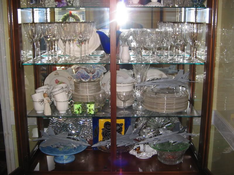

You need to find yourself a loving wife willing to accept your hobby. Once you do that then you can do like I did. Remove all her fine bone china so you can properly display your creations in a prominent dust free environment.

007.jpg picture by fermisb
010-7.jpg picture by fermisb
