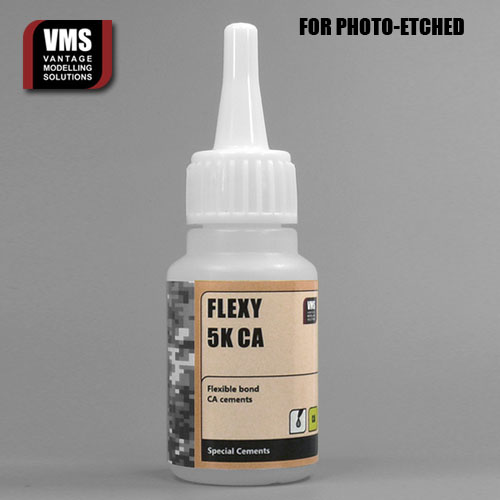

I use a scrap piece of wire myself. I use this CA glue because it’s far more stronger than the other usual brands.
Great stuff but so expensive! I just buy the little tubes of super glue regular and gel in the multi pack. I dispense on a plate, use some wire to apply. It costs $3.00 at hobby Lobby for 3 tubes.

I agree they’re expensive but I find it laughable to your comment. It’s like calling the kettle black. It’s no different than buying the best brand in kits, paint, and tools. Just saying…
