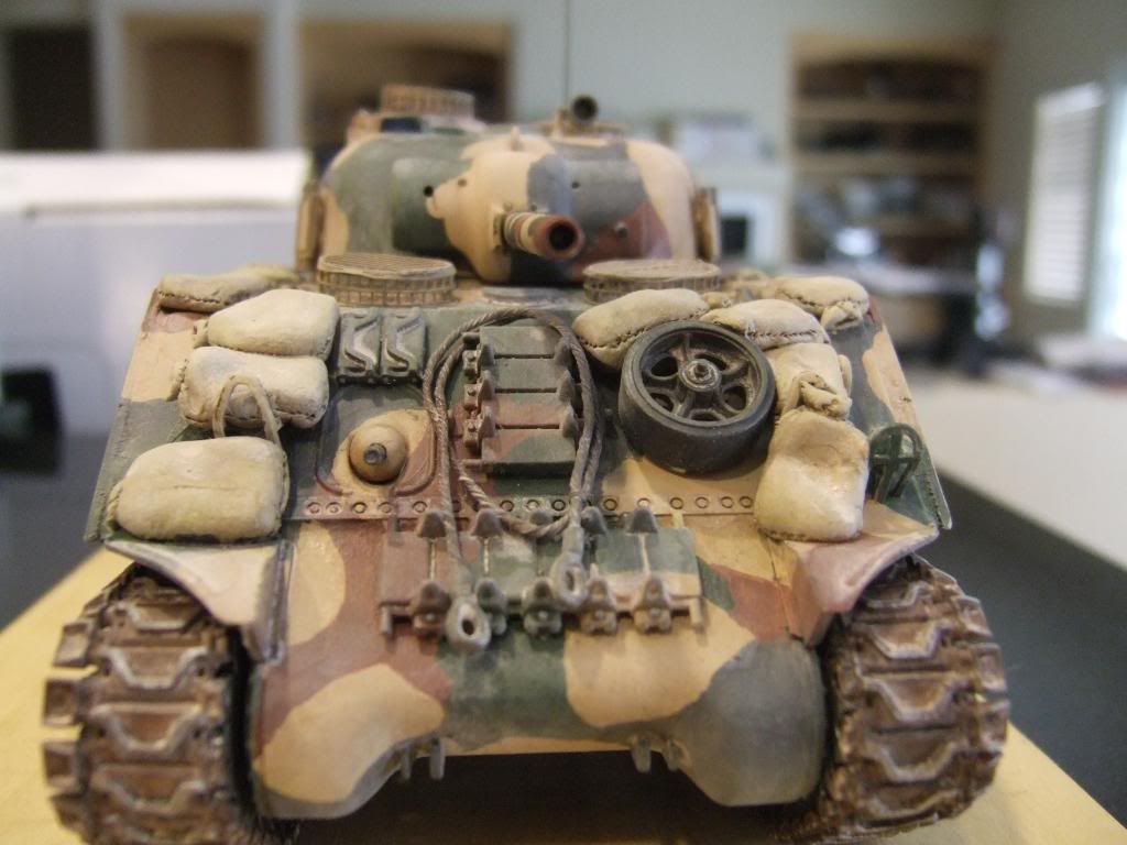

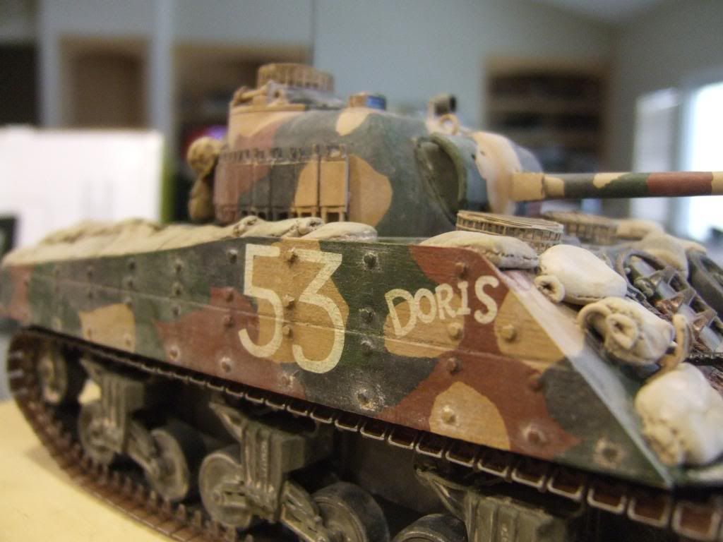

Here is the next Sherman from Iwo Jima.
This is “Doris” a D Co. Tank from the 4th Battalion. As you can see, the battalions really modified their vehicles quite differently. Wood, concrete, chicken wire and sandbags really set this apart from the 3rd Bat.
Basswood armor, apoxie sculpt filler for concrete as well as the sandbags. Bridal tule for chicken wire.
Tamiya’s old kit need some “tough love” and a fair bit of scratch building. Wading stacks and spare links courtesy of the Tank Workshop. Eduard PE for the hatch covers.
Color by Vallejo.
G
At the risk of boring Pvt Mutt, here we are finished. [:D]

She’s a stunner. Nice to see a Sherman in something other than OD. [;)]
Nice work with the add-ons - the “chicken wire” is very effective. Those track links were welded on as applique armour and not carried as spares right?
[Y][Y] I love those Iwo Jima Shermans! What did you use for the cages around the hatches?
You really know how to make a re-entrance Wayne! [Y] [B] Nice to have you back on the dark side.
Thanks guys!
The cages are from the Eduard set.
The spare track links were all steel and spot welded grouser side in for two purposes. One, they made good supplemental armor, two, they could be taken off and used as spares in a pinch. With the welds on the outside (grouser side), it wouldn’t effect the rubber road wheels.

One little criticism, though; when looking straight into the bow machine gun muzzle, it looks a little too pale in there, maybe a tiny bit of flat black in the barrel might do the trick.

ANNNND… … (to add more sweetness to Doris) with all that salt water around, you could get away with some vertical rust staining on the retaining bolts that hold the wood siding in place.
