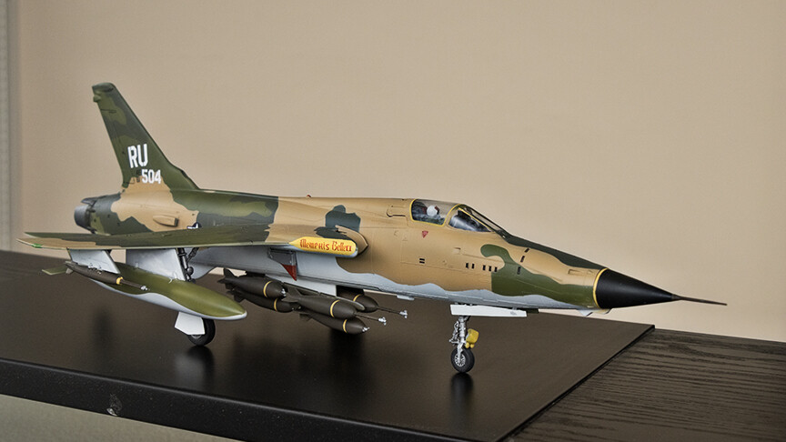

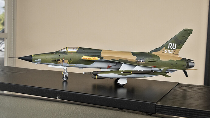

Well, I finished a build today. Woohoo! I’m clearing out a bunch of Closet Queens, to make room for more Closet Queens when we get back from Modelpalooza next month. New on the shelf is a Revell 1/48 scale F-105D. The build is my rendition of Major Buddy Jones F-105D, Memphis Belle II. This build is my first attempt at painting an SEA camouflage. I used Aero Masks F-105D masks. Those masks made painting the camo pretty simple, actually. I liked the kit’s low parts count and the fit was generally good throughout the build. Not too much filler needed at all. So, without further ado, here’s the Memphis Belle II. Oh yeah. The decals are from KITS WORLD. All the way from England.

Great looking build Frank. SEA is a bit of work given 4 colors but sure looks good. How did you do the yellow canopy framing?
Landed with a “Thud”! Very nicely done, and great job with the SEA camouflage!

Outstanding work, Frank. That really is a beautiful build. The SEA camouflage came out especially well, and that’s actually what caught my attention.
I’m really interested in the Aero Masks you used. I’ve got at least a couple of SEA camouflage projects coming up, including an F-100, so this could be very useful to me.
One thing I can’t quite tell from the photos: did the masks give you a hard edge between the camouflage colors, or is there a slight soft/feathered edge? And if it is feathered, did the masks create that themselves or did you have to lift them slightly off the surface?

That is pure Beauty too me…
Yeah, the Aero Masks will give you a hard edge. I couldn’t think of a way around that.

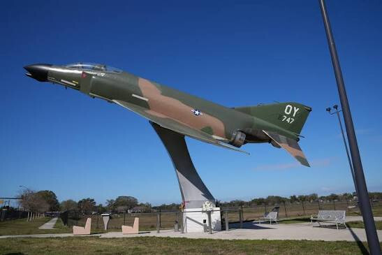

Also, look at DN Models masks. They may offer a little more flexibility. This F-105 build was practice for an upcoming Academy F-4C Phantom build. The idea is to build a replica of the F-4 on display on the southeast corner of Orlando Executive Airport. This is an F-4 flown by Joe Kittinger. BTW: Kittinger was the first man to jump from a balloon at 100,000 ft. plus

And I love the history behind the F-4 you’re planning. That kind of connection to a specific aircraft and the people associated with it is what usually inspires me to build a particular subject in the first place.
For me, knowing the story behind the airplane makes the model a lot more interesting than just building an F-4 because it’s an F-4. I’ll be looking forward to seeing that one come together.
