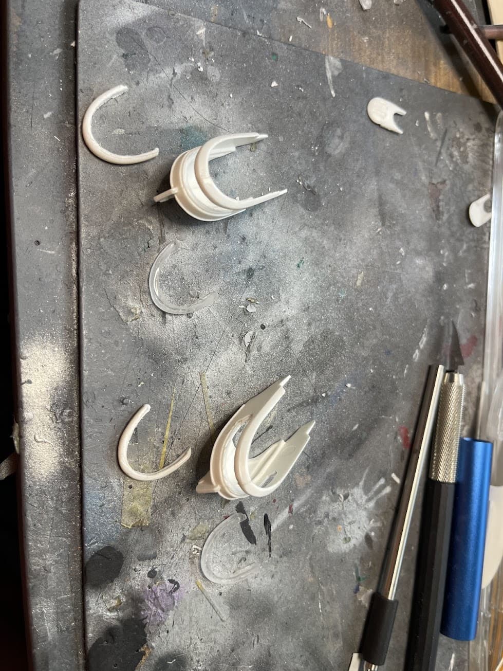

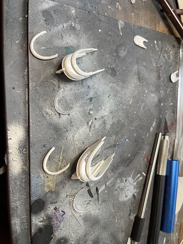

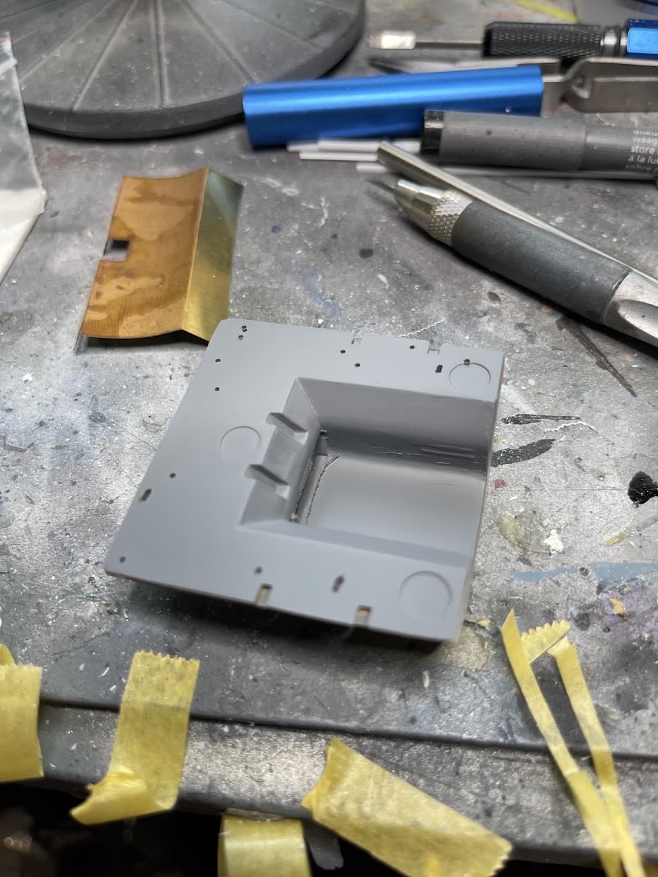

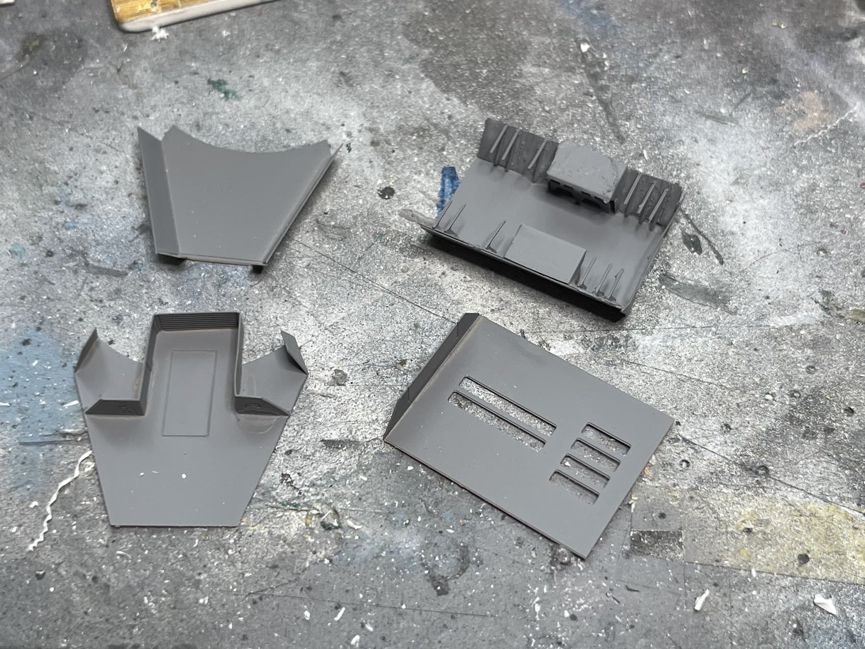

Starting prepping pieces for light blocking

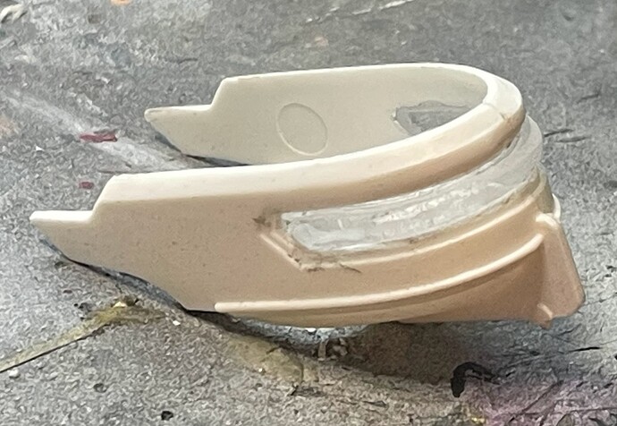

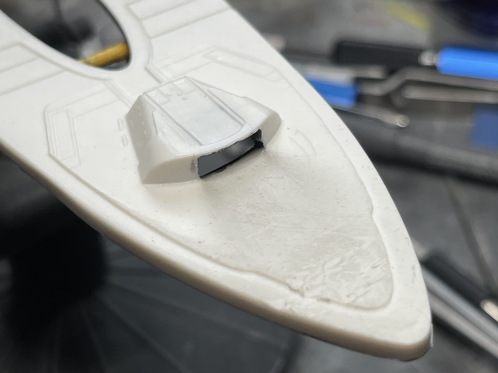

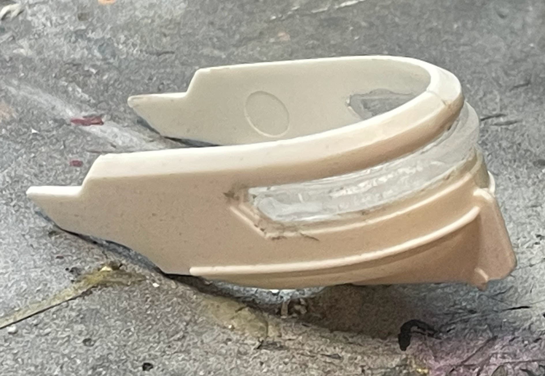

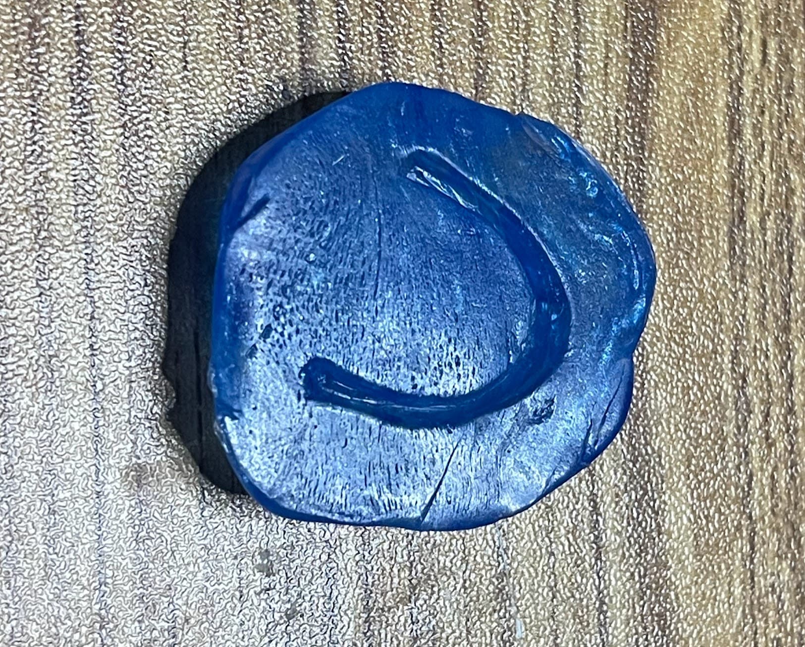

Cut out section for bussard collectors

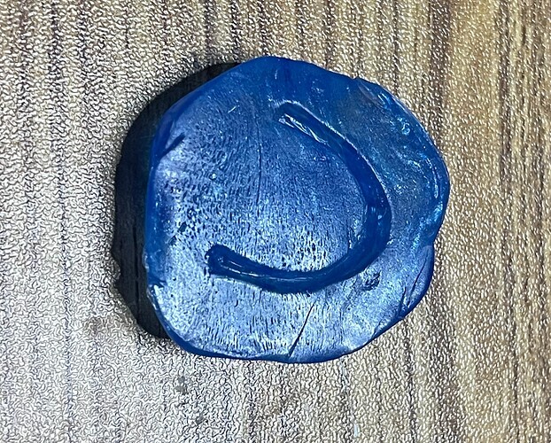

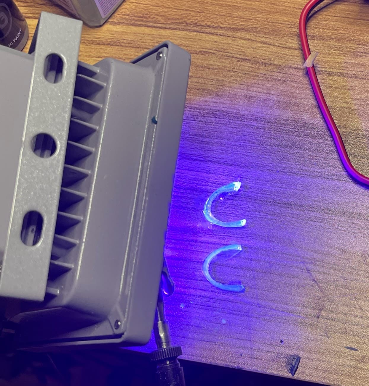

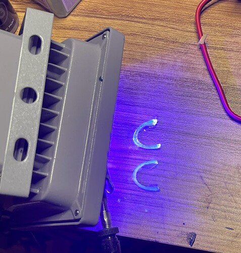

To accomplish this I had to make my first custom modeled parts using UV clear resin

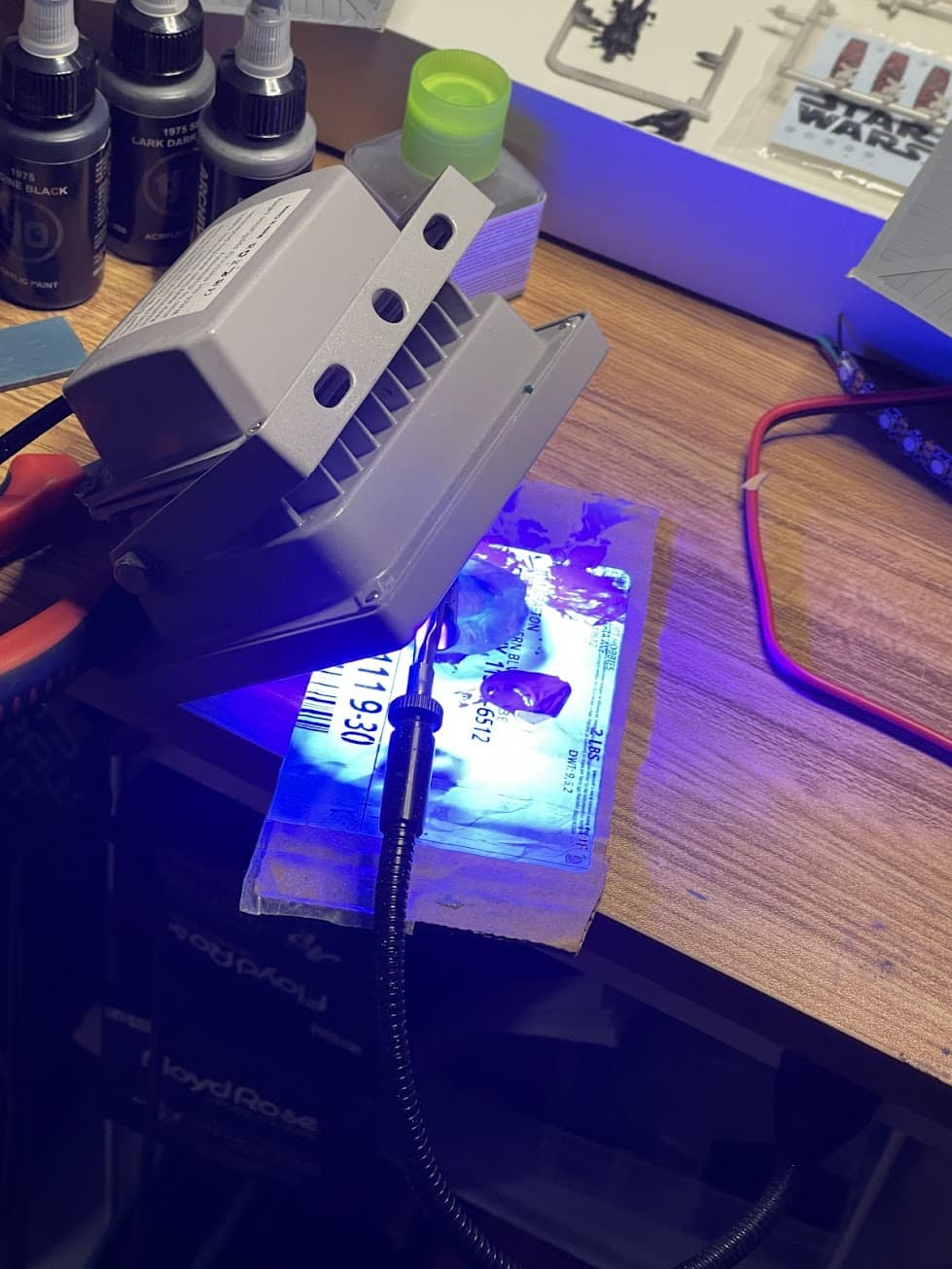

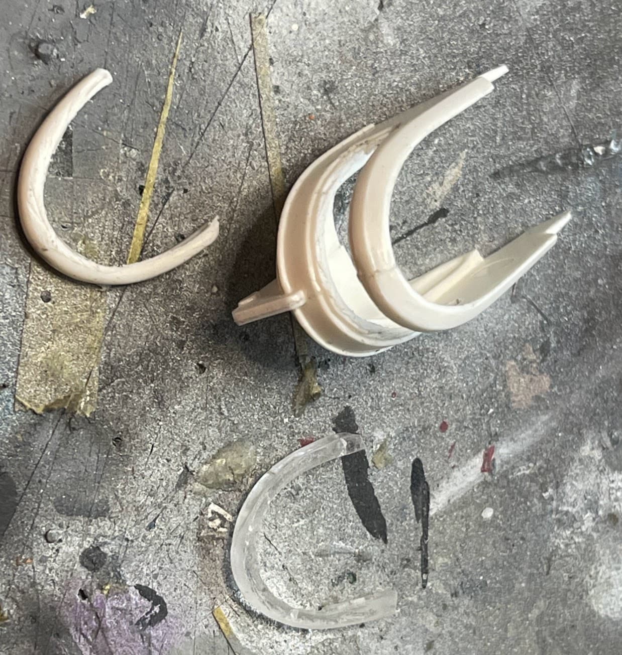

Curing the resin
Parts:

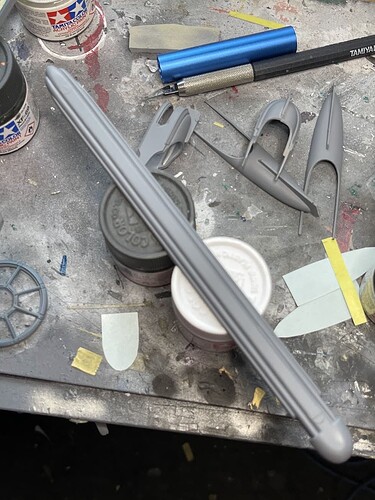

the nacelle
  • needs to be light blocked
  • interior painted white (X2)
  • exterior primed
  • lights need to be cut and wired in, wires on one side need to be fed back down to the other nacelle because the neopixel lights need to all be chained together
  • the top part of nacelle needs to be masked to allow clear section on top for lighting (not 100% sure if that’s official cannon but I think it looks cool)

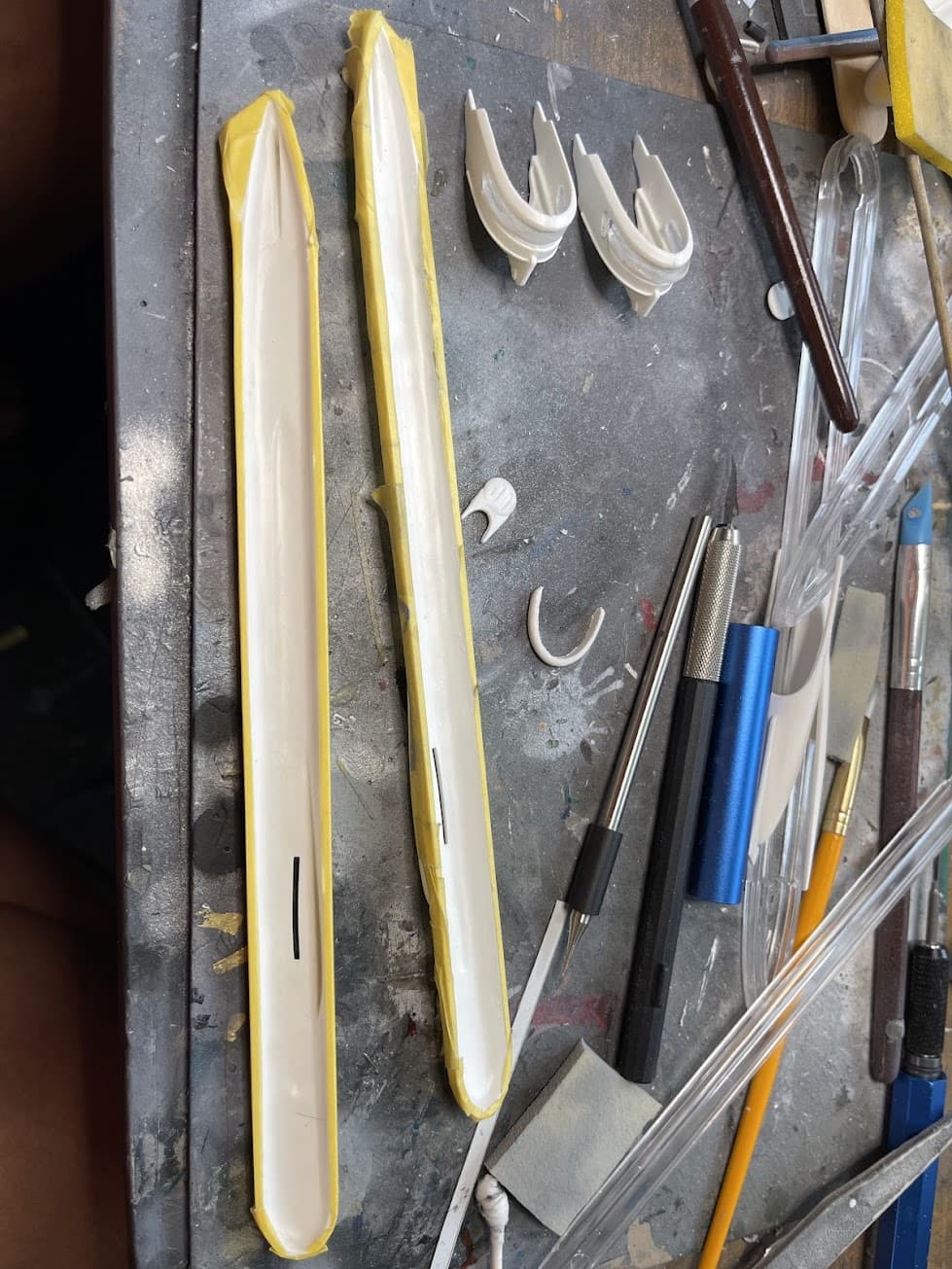

Some progress, got the light blocking paint mostly done.

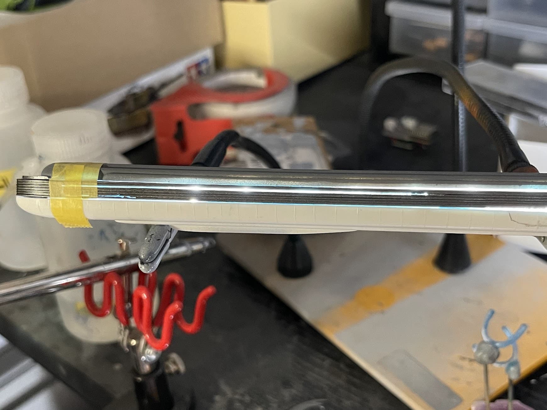

Grill painted black, will add a more metallic gun metal, then make it matte. And then scrape off paint for the lower engraved lines

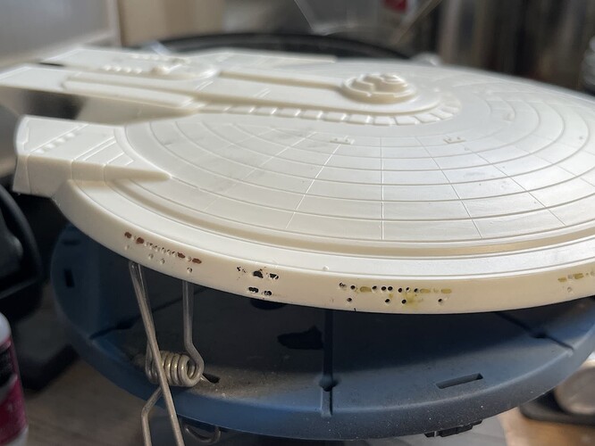

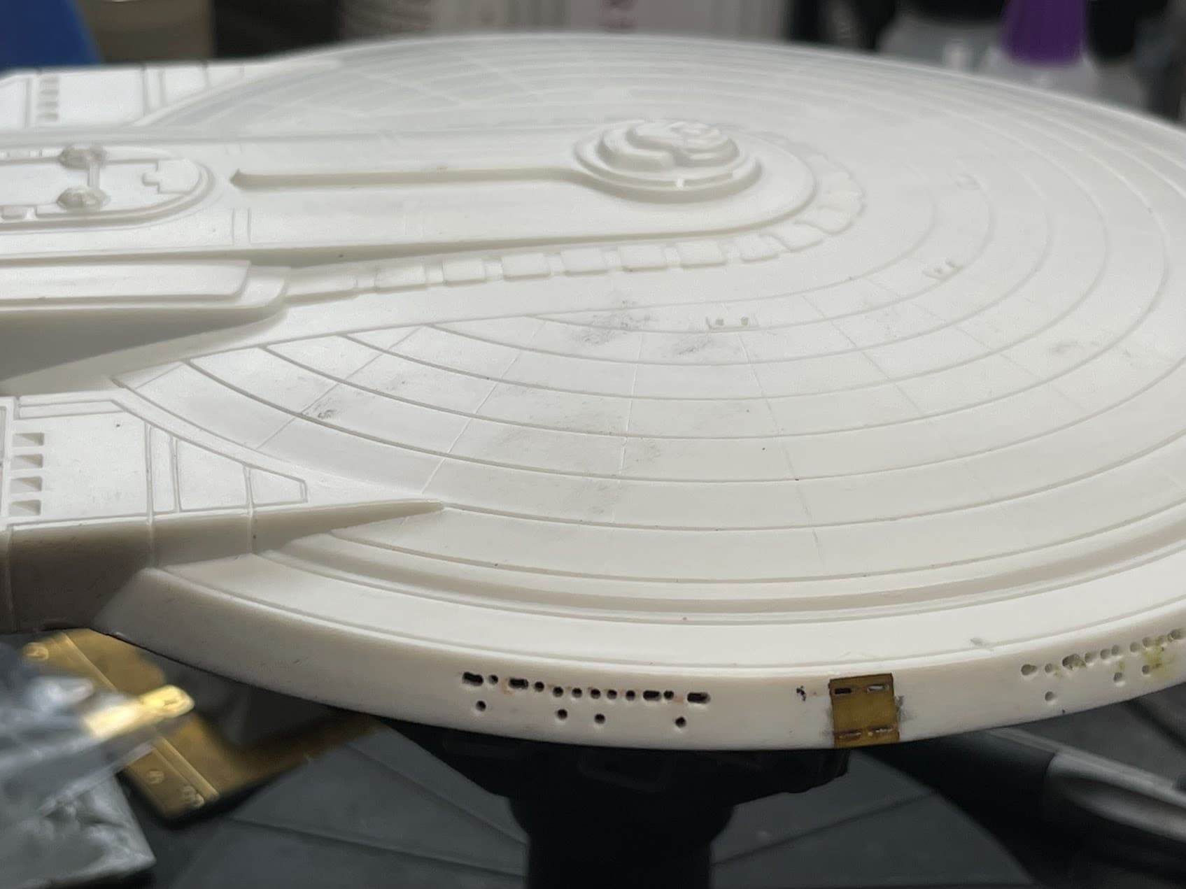

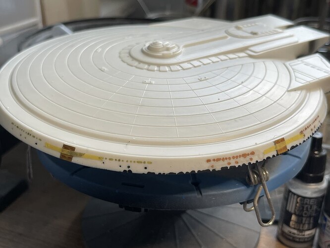

Marked lights for saucer

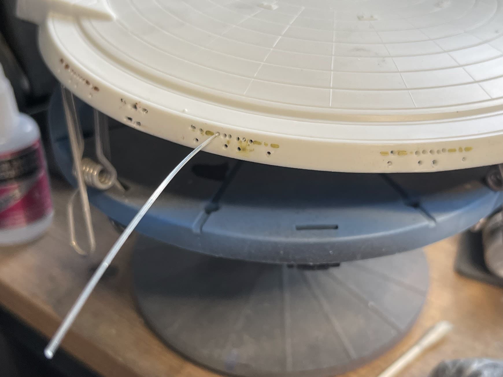

Drilling 0.4mm holes for fiber optics
Grill lights…
The upper thin line of light, that’s going to be repeated for all the inner lines, and the light will light up from front to back when it’s all working. But the light blocking and etching off the paint works.

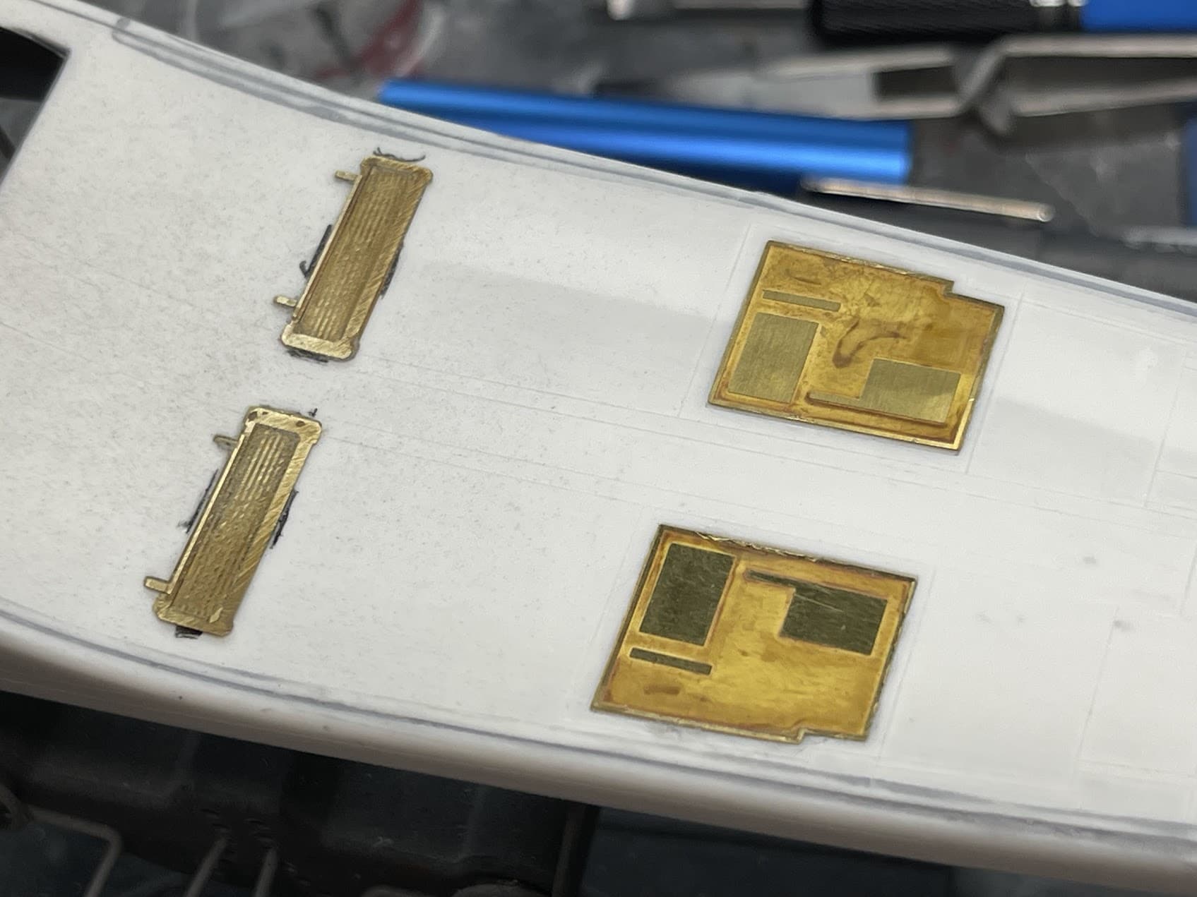

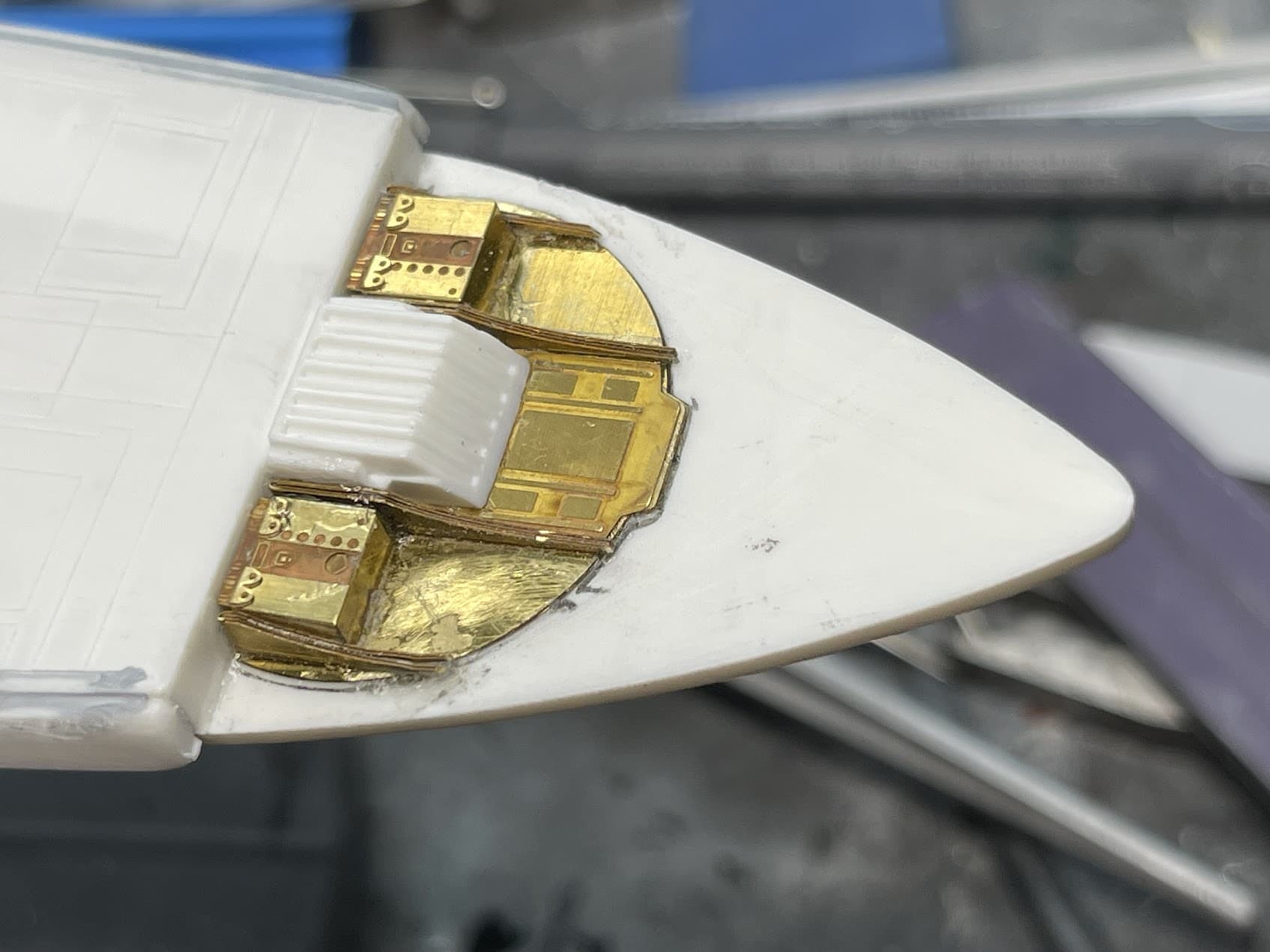

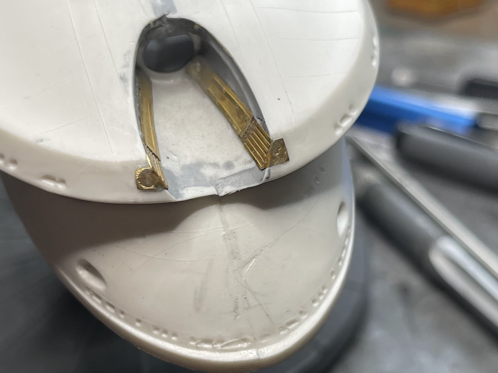

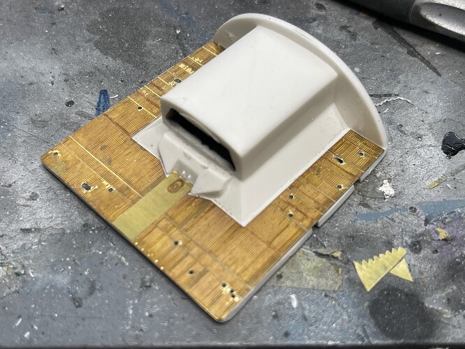

Some more progress adding on the upgrade PE parts.
Fiber optic light holes
