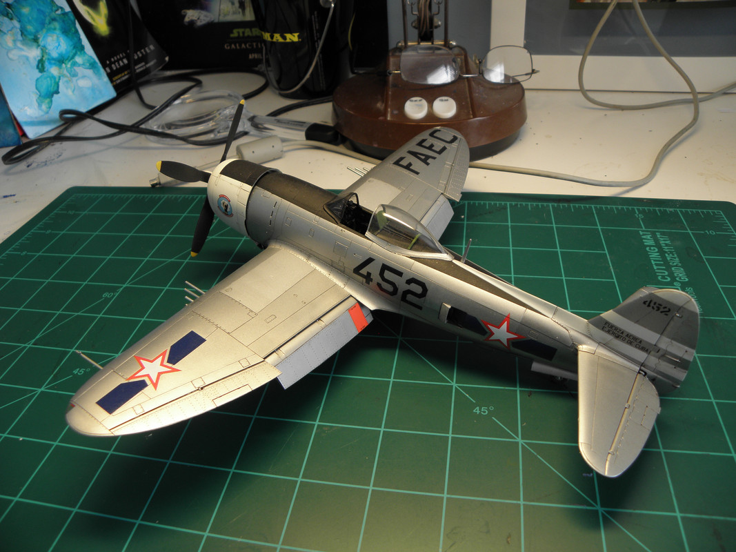

Nick!
Ya did it again! Showing a photo of one of my Favorite birds from my Childhood. She’s just as beautiful to these tired old eyes as she was to my questing Young ones!
I have only one thing to say Nick! Gorgeous! T.B.
T.B. many thanks my friend… I would have responded sooner but the Dilithium crystals got depleated and no wrap drive (504)… I fell in to that…
Yeah!
That’s a black Hole of unprecedented proportions and dimensions!
