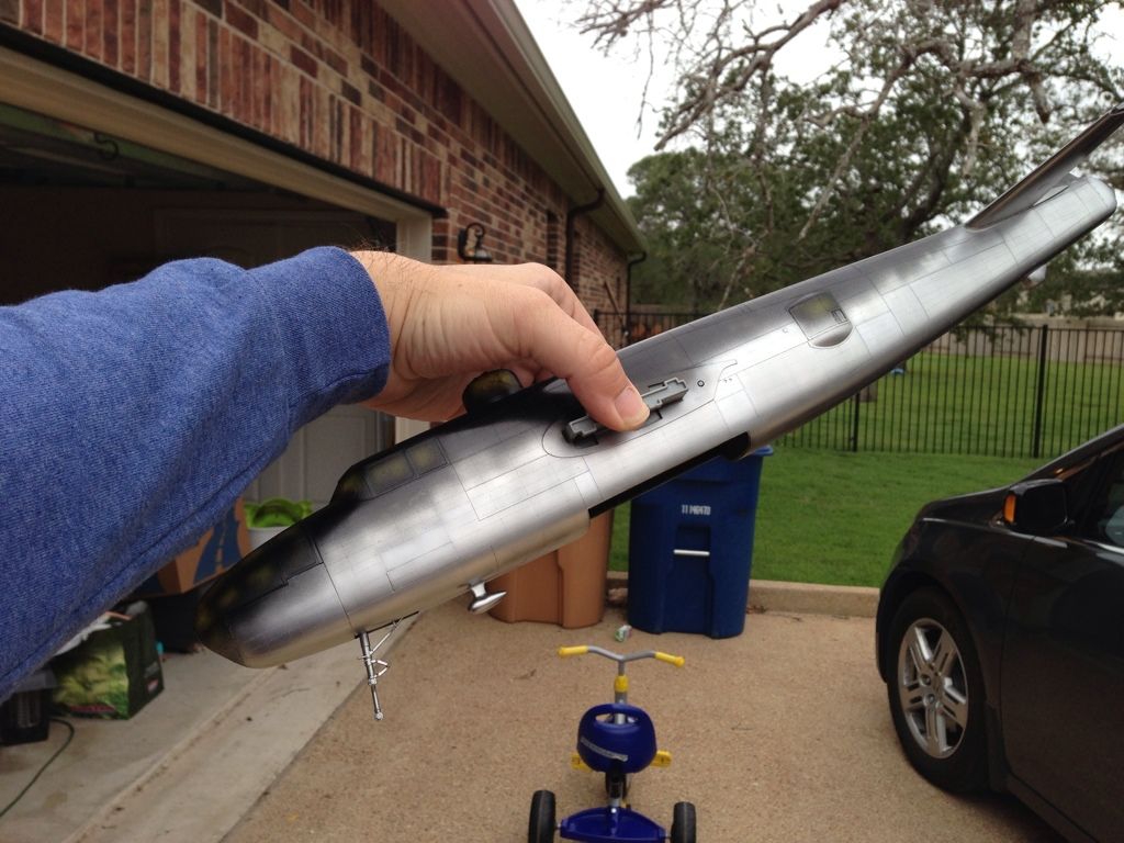

It doesn’t need to be gloss black, per se. Just very, very smooth black as a base. I’d recommend sanding with a very fine grit, and then hitting the black with a Dremel packing a cloth polishing wheel (NOT the felt ones!).
This got re-based before NMF, but gives you an idea of the mirror-like smoothness the polishing wheel pulls off:

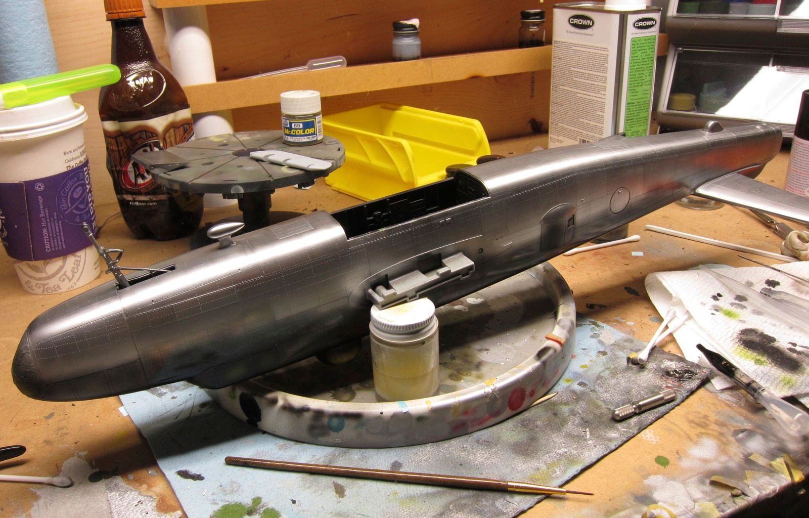

For my NMF, I prefer to start with Airframe Aluminum. The “high-shine” Alclad finishes are semi-translucent. That’s why they need the black base while the regular Alclads don’t. It also makes them darker than the regular Alclads - excellent for shading.
Next, move on to the regular finishes (unless you want that polished look). I’m a fan of Aluminum, Duraluminum, White and Dark Aluminum. Magnesium and Steel start getting too dark.
The cool thing about using Airframe Aluminum as a base is that - because it’s semi-translucent - the black base makes it darker, so you can modulate coverage of the regular finishes, go with lighter coats over panel lines, etc, and put a lot of variation and shading into the finish straightaway.
