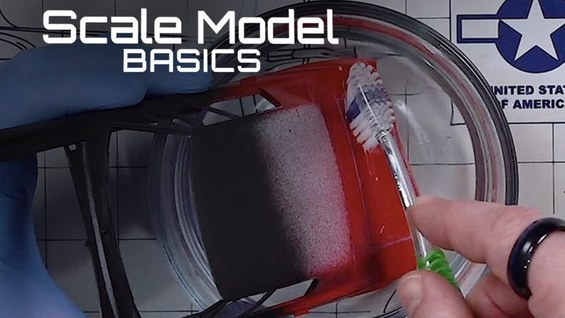

I had a severe case of the ‘frosting’ using the Tamiya clear from a rattle can. And it was over Tamiya blue. I had to strip and start over.
What method did you use to strip?
I think I soaked it in Testors ELO. Expensive stuff. I use purple power now.
I’m not sure Purple Power is available in the UK. Isopropyl alcohol will strip paint—the higher the percentage the more effective—and won’t affect the plastic.
