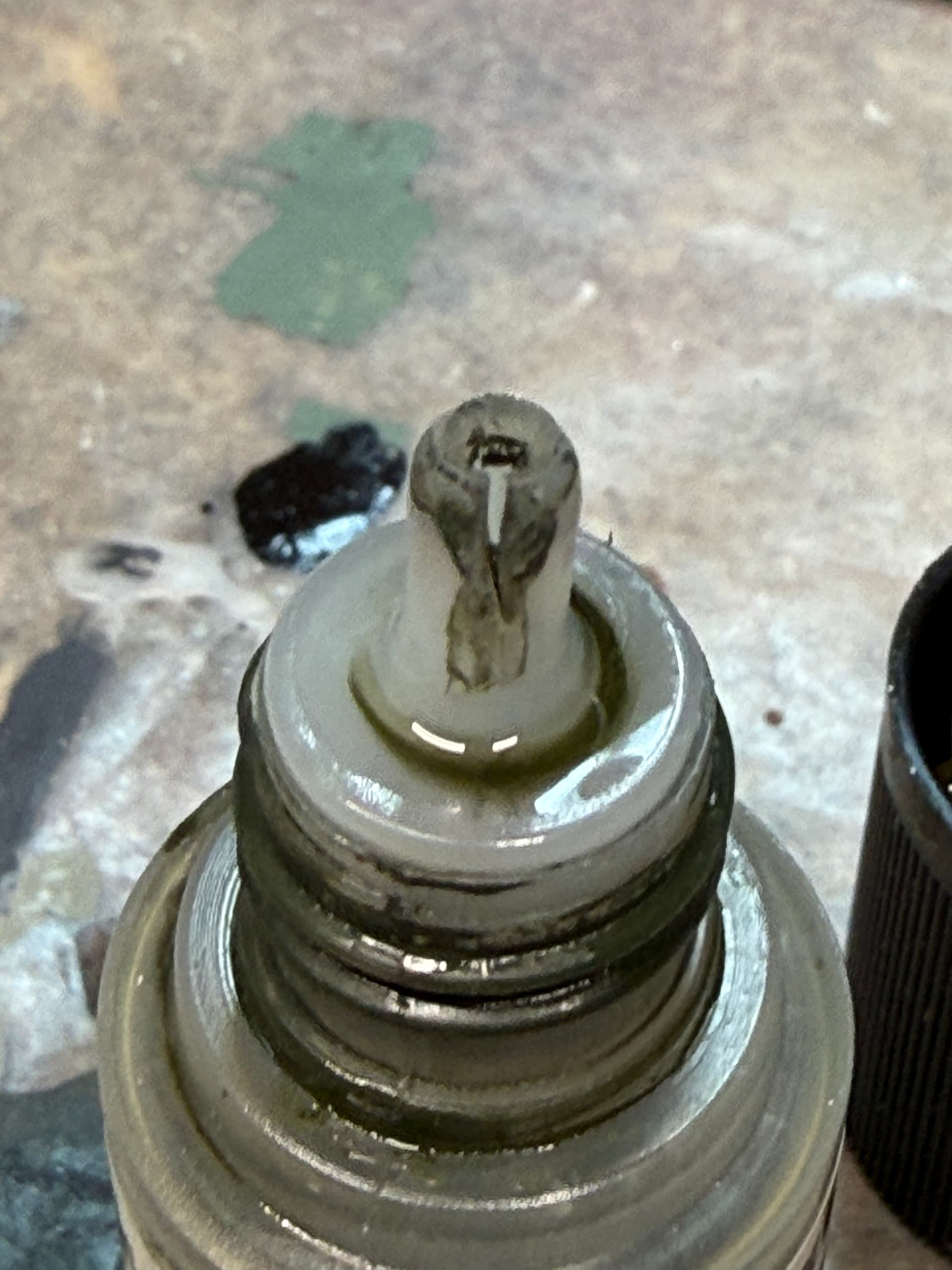

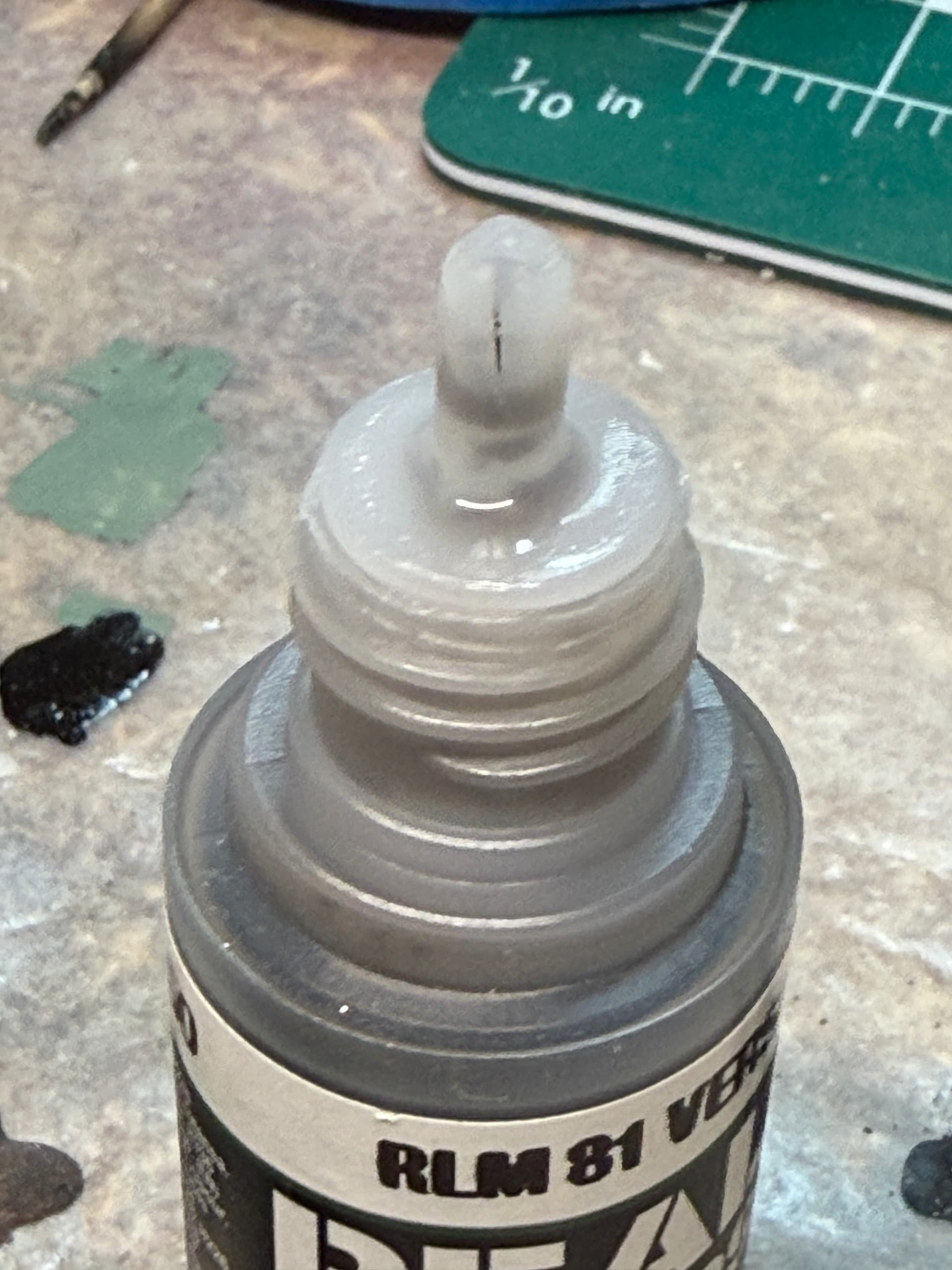

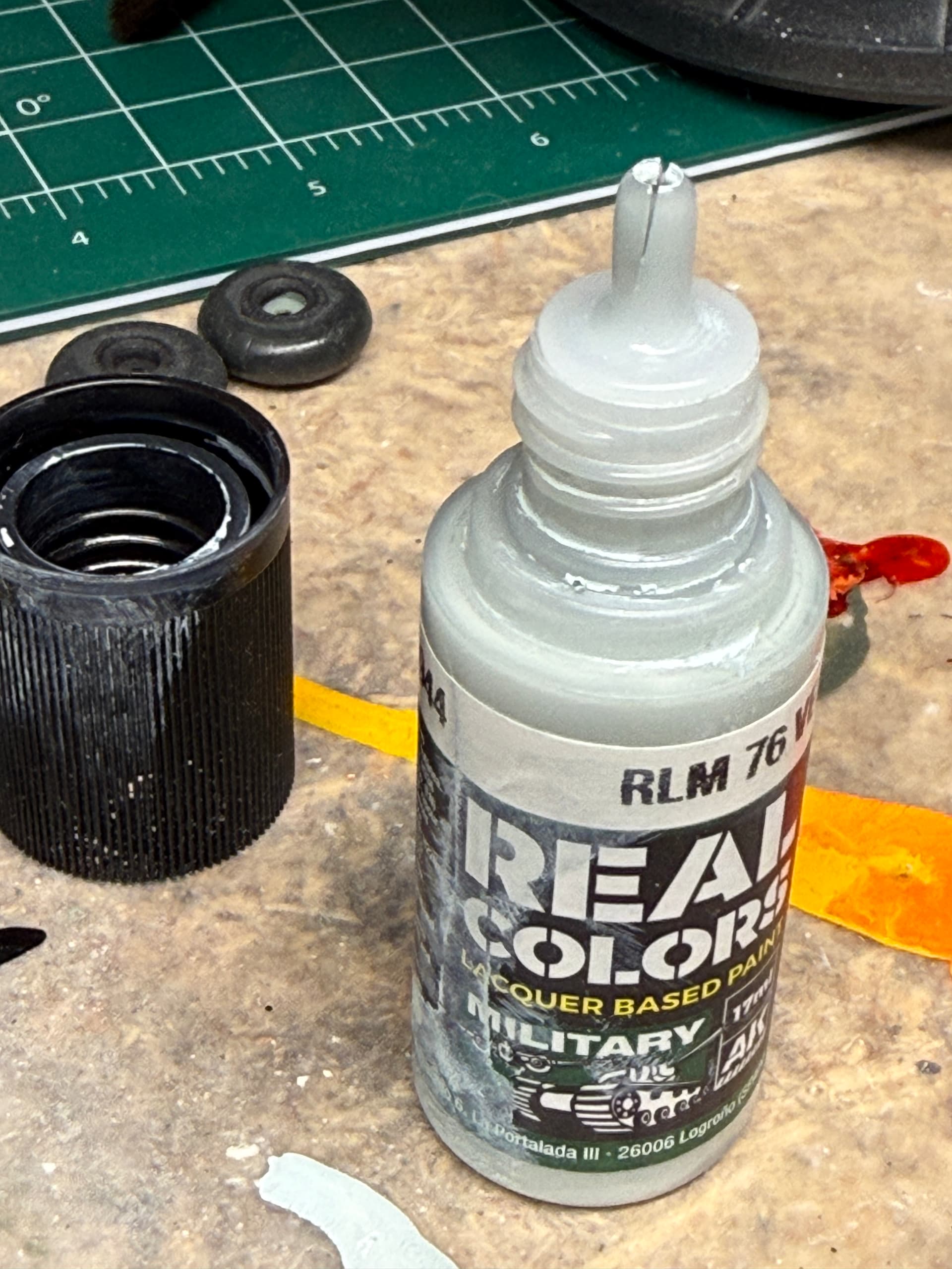

A while back I bought 12 RLM colors to try after reading glowing reviews. I just went to try one and found that the nozzle was split. I opened them all up to take a look to find that there are 2 more bottles with split nozzles. Has anyone experienced this with brand new bottles of their paint?
All are brand new, never opened and different colors. Needles to say this made a mess when I opened the bottle after shaking it and the paint was kind of thick which resulted in a crappy finish, even after upping the air pressure.

The split tops was something that happened during the filling process. AK is aware of the problem and sent replacement tips to wholesalers. You might want to check with whoever you bought the paints from. I had it happen on one bottle that I’ve purchased so far. Makes quite a mess and wastes plenty of paint on the inside of the cap during the mixing process.
This was my first time ever using this stuff. I’ve been busy with lots of other things. I’m hoping the thickness is just from the split tips letting the solvent gassing out. 3 out of 12 is a 25% failure rate.
Now I have to figure where I purchased this from since it was about a year ago.
I only have two bottles of it, but one of them does have a split nozzle. It’s barely noticeable and I had to put my #11 blade into to make sure it just wasn’t a line on the plastic.
