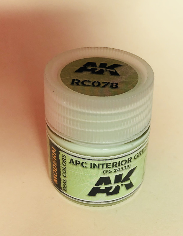

This paint line is a new addition to the ones carried at a LHS that I came across on my last visit. They have a LOT of colors not previously available such as the green for the interiors of US APCs/IFVs that I picked up.
Anyways, has anybody here used these paints yet? According to the guy at the shop, they can be airbrushed with Tamiya thinner. If they work as well as Tamiya, and are compatible with their thinner, with their extensive color selection, they sound like a great option. So please, any feedback, comments, critiques of these paints from members here?
