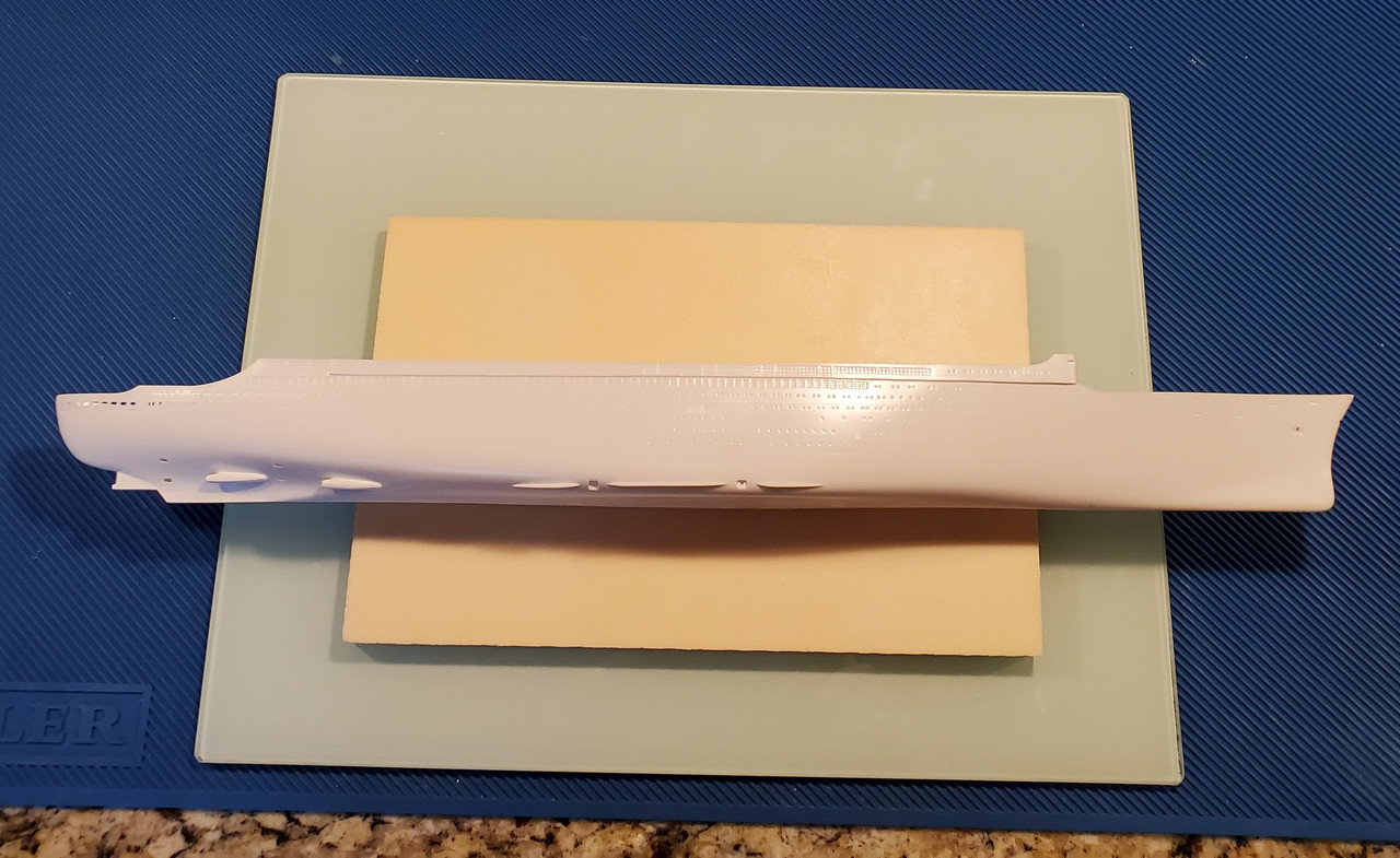

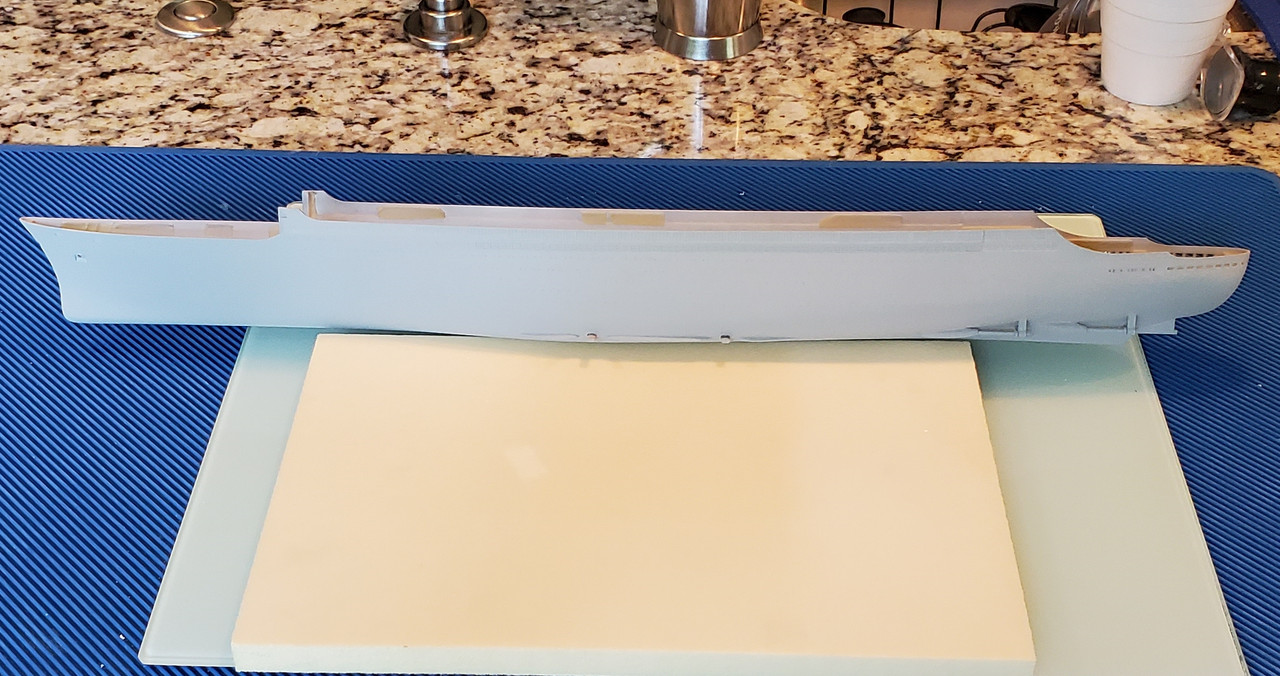

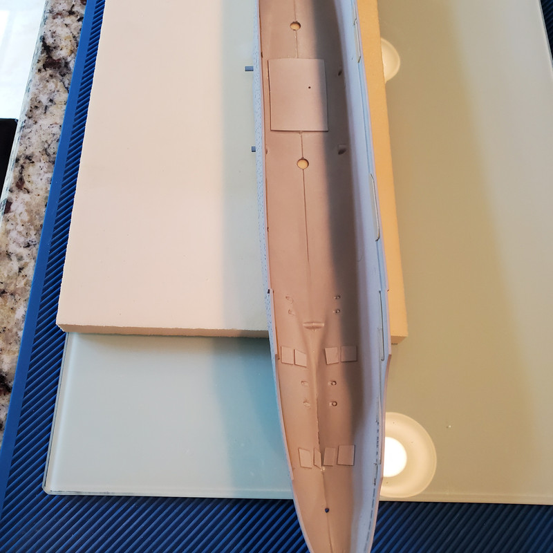

After enjoying building the Airfix 1/600 RMS Queen Elizabeth I purchased as many 1/600 Liners as I could find. The rarest one is the Airfix SS France which I finally found on ebay at a high but reasonable price. She is my current project but I have to be careful since messing her up and trying to replace her would not be easy.
So far she is in prime with the propeller shafts and stabilizers installed. I really would have preferred to leave them until near the end of the build but they needed a lot of filler which would have messed up the paint job. I’ll just have to watch out for them as they are very delicate. Once I get the hull painted and mounted on the stand they will be much less vulnerable to damage.
The holes for the shaft supports were just a mess and the hull had quite a bit of warp to it so I filled the support holes first from the inside with styreen sheet and then putty on the outside. I also glued in a brace of styrene sheet to help hold the two halves of the warped hull together. She needs a little more filler before paint.

Nice work over coming the warped hull. I sure you are going to find other surpises with an old AirFix kit.
Marcus [B]
ChrisSC,
Nice putty work and congrats on the hullfix. These old 1/600 liners are great kits. Glad you got a SS France. Keep an eye out for an SS Canberra if you have not already procured one.

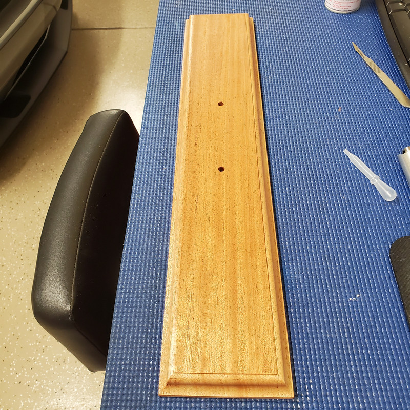

Thanks guys. I added a bit more filler and am in the process of painting the hull. Between coats I routed, drilled, and polyurethaned the display base.

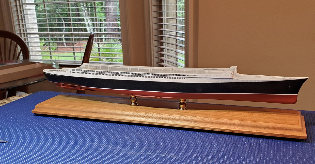

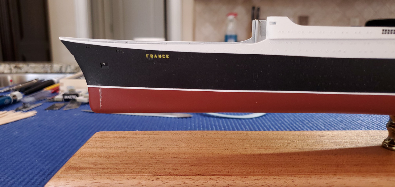

Well I got the color on the hull of my 1/600 France. Now I need to put decals and a coat of flat clear on it. When that’s done I will try to figure out how I am going to paint all these tiny windows.

Nice work on the hull. The hull has very graceful lines, looks like she would be very speedy on water.

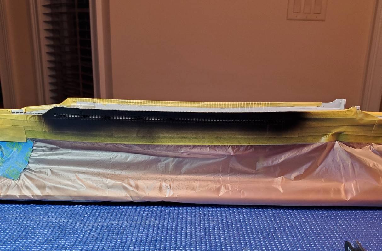

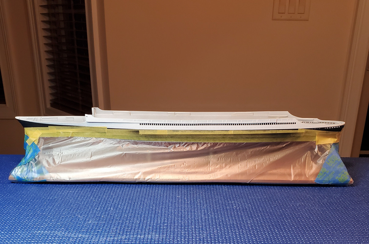

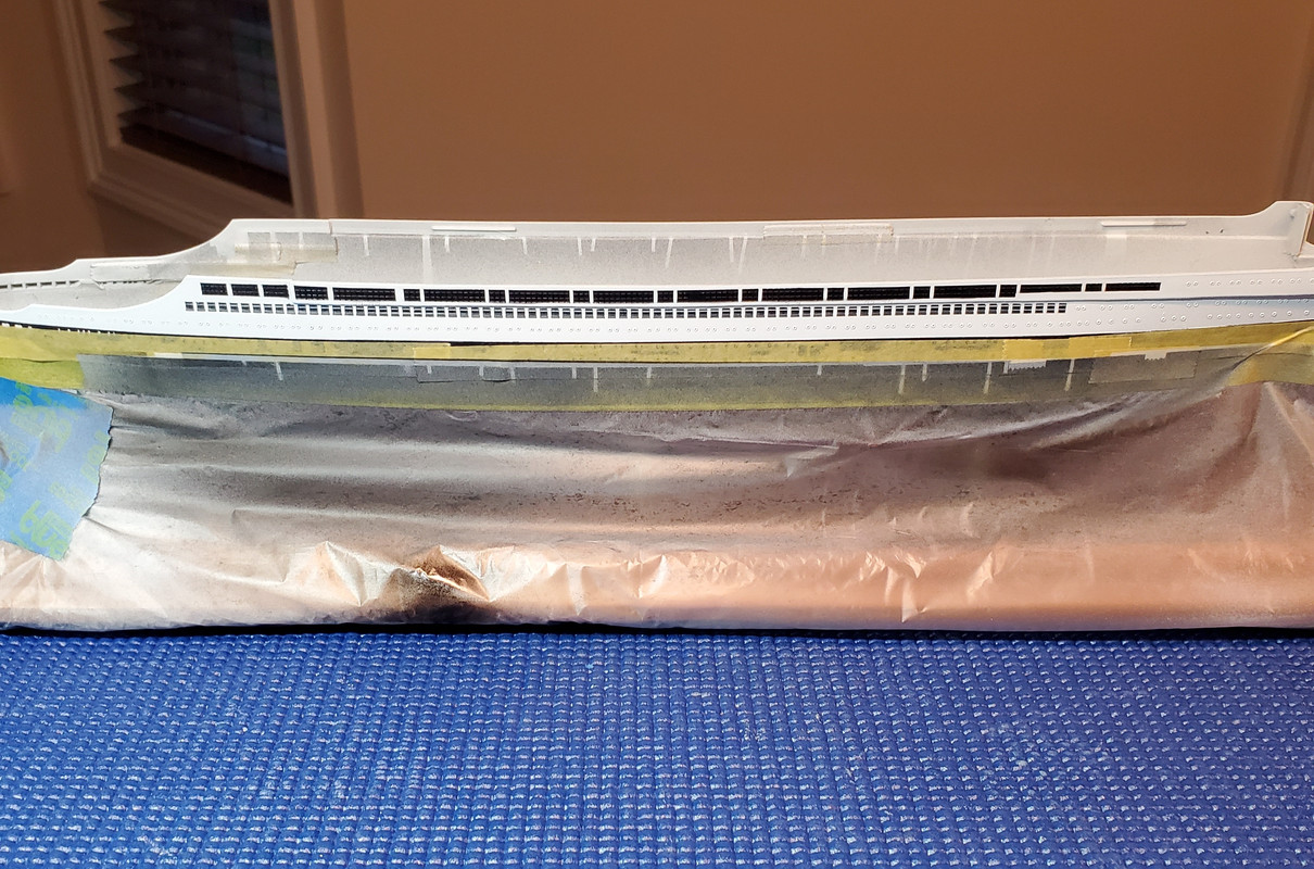

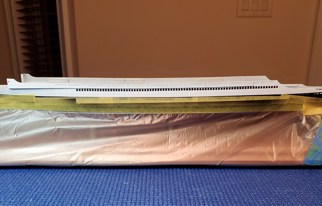

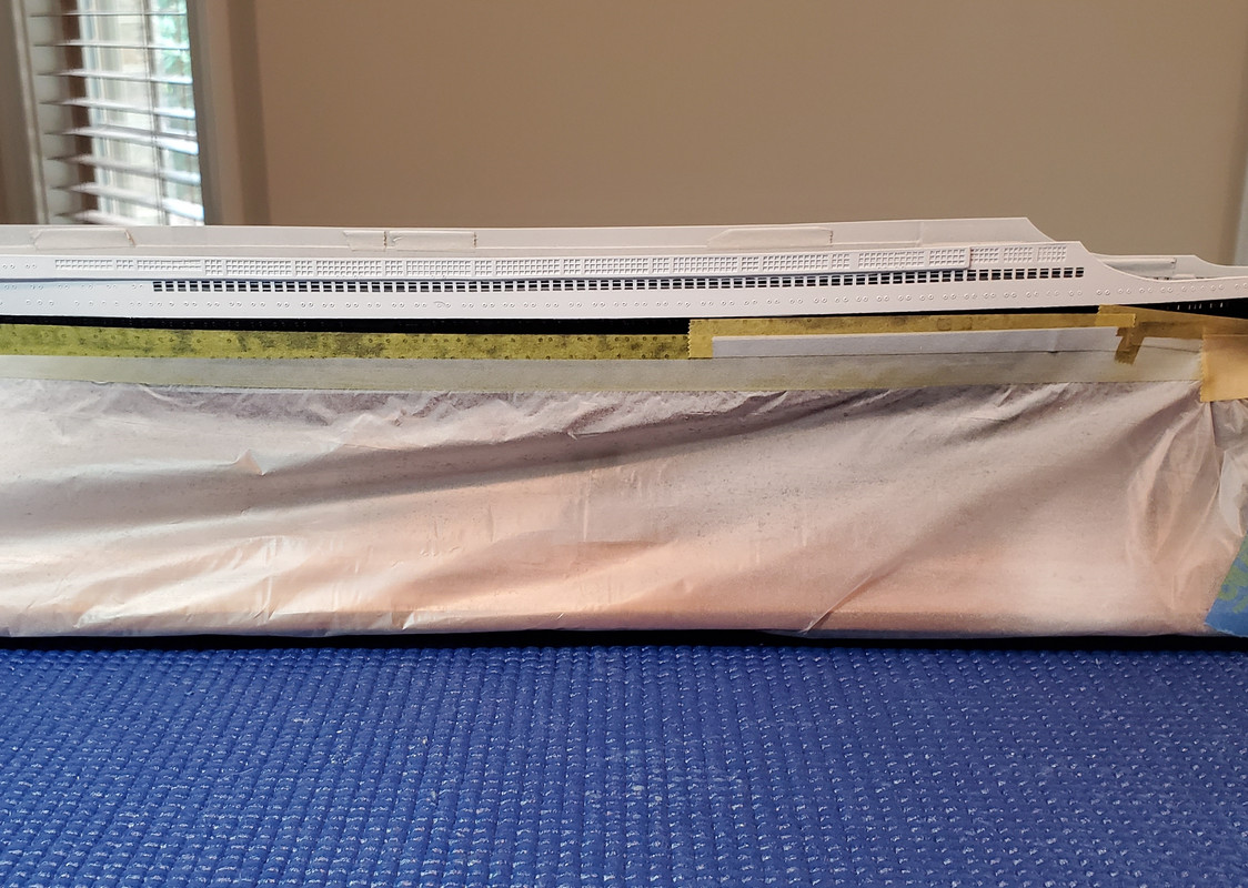

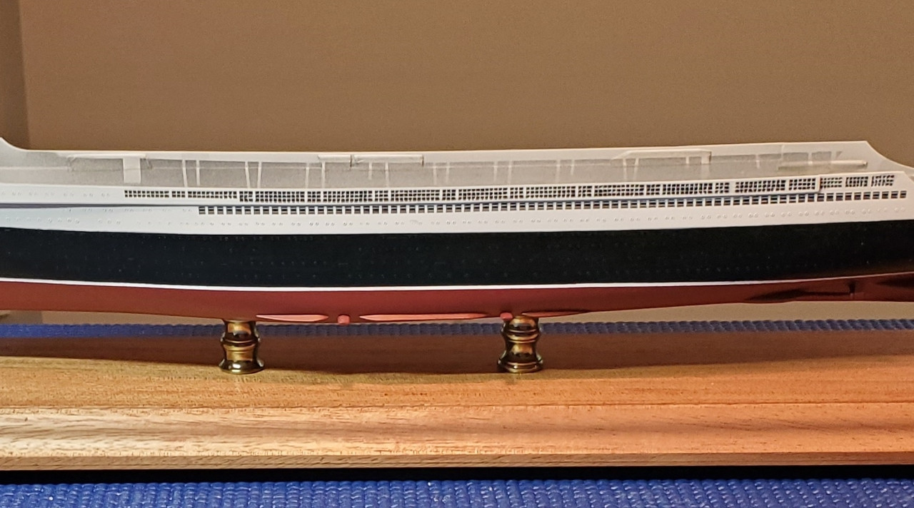

Well I gave it my best effort to get all these tiny windows painted but unfortunately the results were disappointing. The scale, number, and irregularity of the frames is just beyond my ability as a painter. Time to move on.

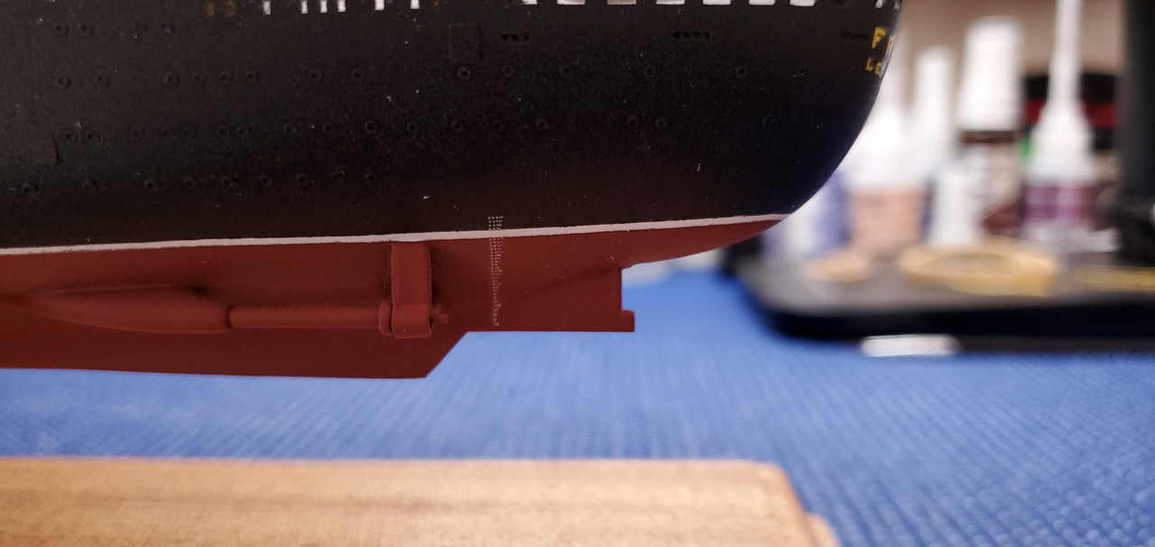

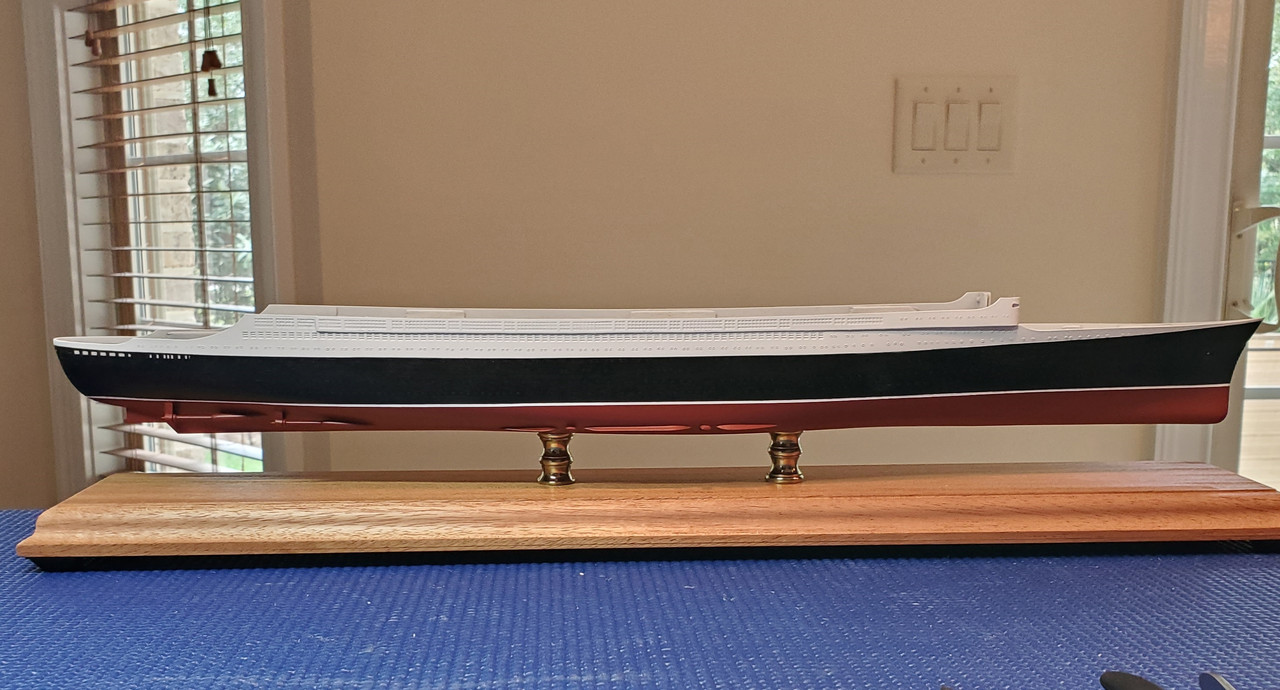

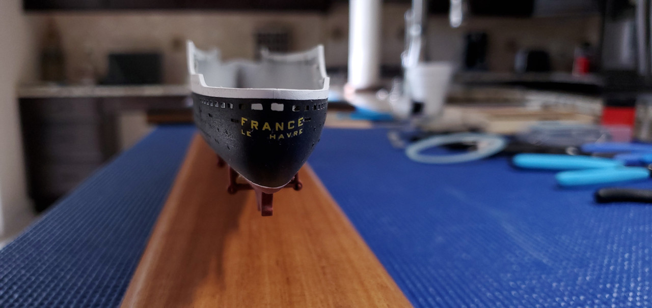

Decals are done.
Sweet! Looking mighty fine.

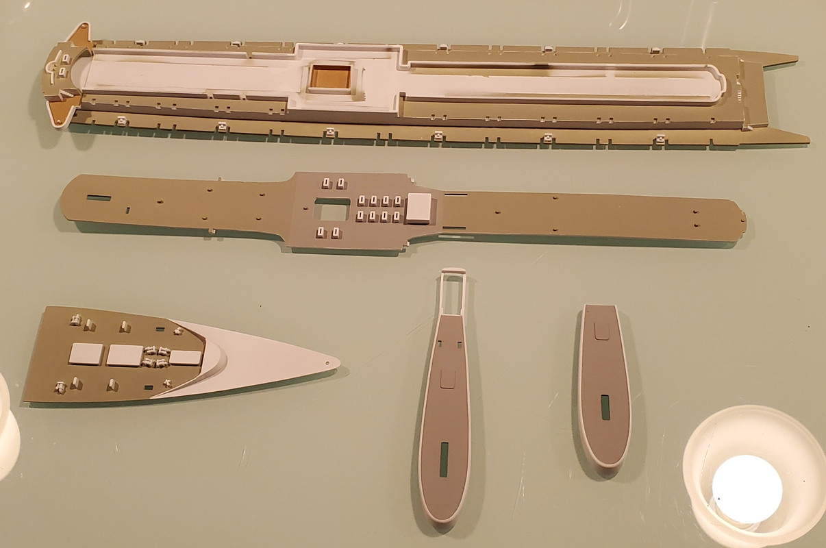

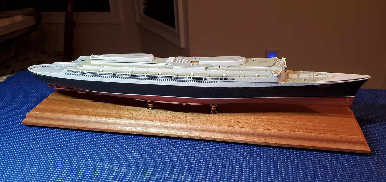

Thanks Marcus. I’ve been dealing with my Mom’s health issues so I haven’t had time to work on my 1/600 France. Today I took a little break and did some painting. Not so sure about the color I chose but the ship had green decks. This color is a gray that has a green tint. I really don’t want to paint it a dark green so this is what’s going to be on there.
Just laying the decks on there the color will be good enough for me.
ChrisSC,
Good choice of colors, they blend very nicely with the hull. I doubt the French would paint the ship decking fence green.

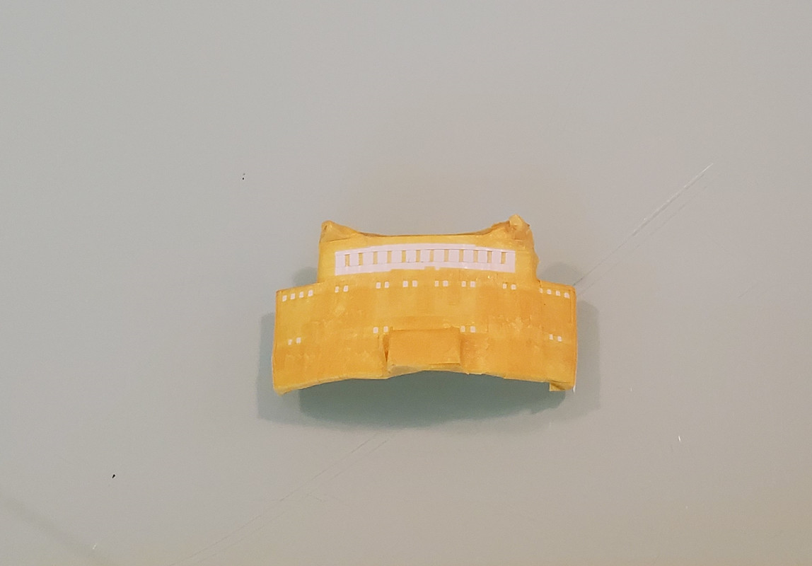

Thanks Marcus. I masked and painted the bridge windows and attached the forecastle on my 1/600 France. Lots of tiny pieces of tape!!
Here is a helpful suggestion for any and all building ship models.
The name of the ship and her home port of registry.
The name at the stern should be level with the water. The home port of registry parallel and horizontal to same.
And usually center registred.
Kit decals give it a guess, but usually might only be right if the distance above the waterline is the same as that of the location on the model.
The way to solve this is to mark a pair of baselines parallel to the waterline. Then cut the decal for each letter and apply the type on that line letter by letter.
