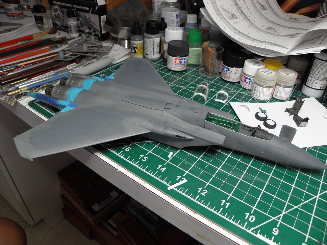

For soft camo I like to use the ‘noodle’ technique. Here I’m using Elmers tac but a lot of folks like silly putty or other clays.

HH60gblackhawk. I use .the same method as keavdog , it takes some practice but it works better than free hand .I didnt take pics of the poster tack and tape .
The nose wasnt cemmented in place yet, which F-15 kit your building ?
