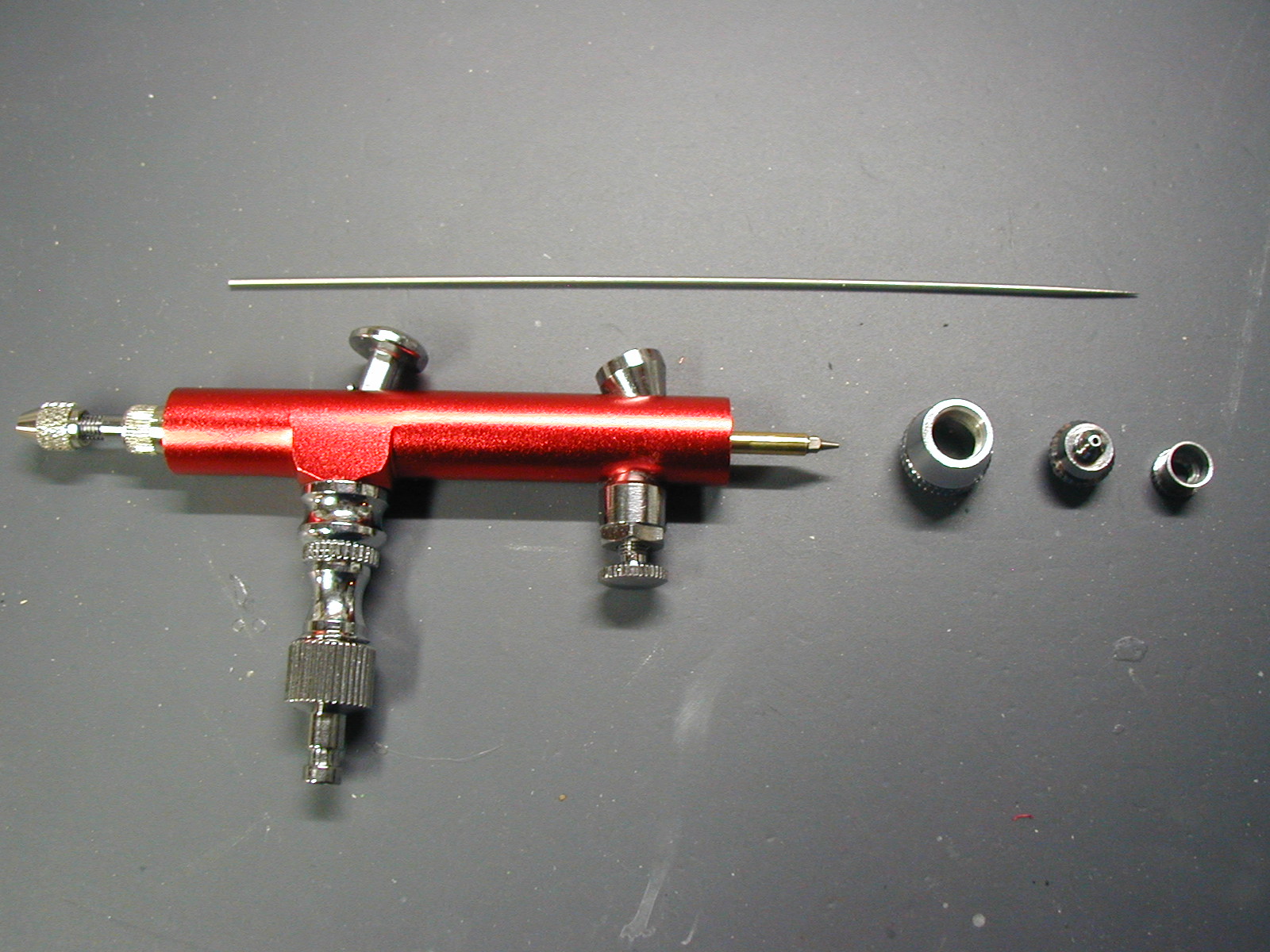

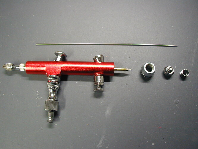

Here is a photo of the airbrush. As you can see (right to left) there is the needle cap, the air cap, and another cap that I don’t know the name for. Then you can see the brass tube coming from the front of the airbrush and the fluid nozzle screws into it. As you can see, it’s extremely small and delicate. The fluid nozzle has a O-ring to seal it to the brass tube. In thinking about it, virtually every video I saw on fixing bubbles in the airbrush cup stated that there was an air leak back into the fluid nozzle, either because of a loose part or a crack in the fluid nozzle. In my case, that seems like the only likely cause. I’m starting to wonder if the O-ring on the 0.2 and 0.3 mm sizes has a sealing problem, especially since the 0.2 needle worked fine the first two times that I used it. Since this is an inexpensive airbrush, it’s possible that there is a manufacturing defect in the O-rings causing them to not seal correctly, while the 0.5 mm needle does work. I ordered up some bees wax from Amazon as well as an airbrush repair kit with extra needles and fluid nozzles, so I think that I’ll wait to do any more troubleshooting until I get these items. Thanks for all of the help and suggestions so far.

I purchased an airbrush maintenance kit from Aamazon and it came with two tiny cans - one with grease and one with sealant. The sealant is a clear, almost gummy gel. I took out the airbrush and applied some of the sealant to the fluid nozzle for the 0.2 mm first, and then the 0.3 nozzle and sprayed thinner with the gun. Both of them now worked perfectly without any bubbles. So it looks like the problem was air leakage around the fluid nozzles, even though they both had O-ring seals. Thanks for all of the help and suggestions.
