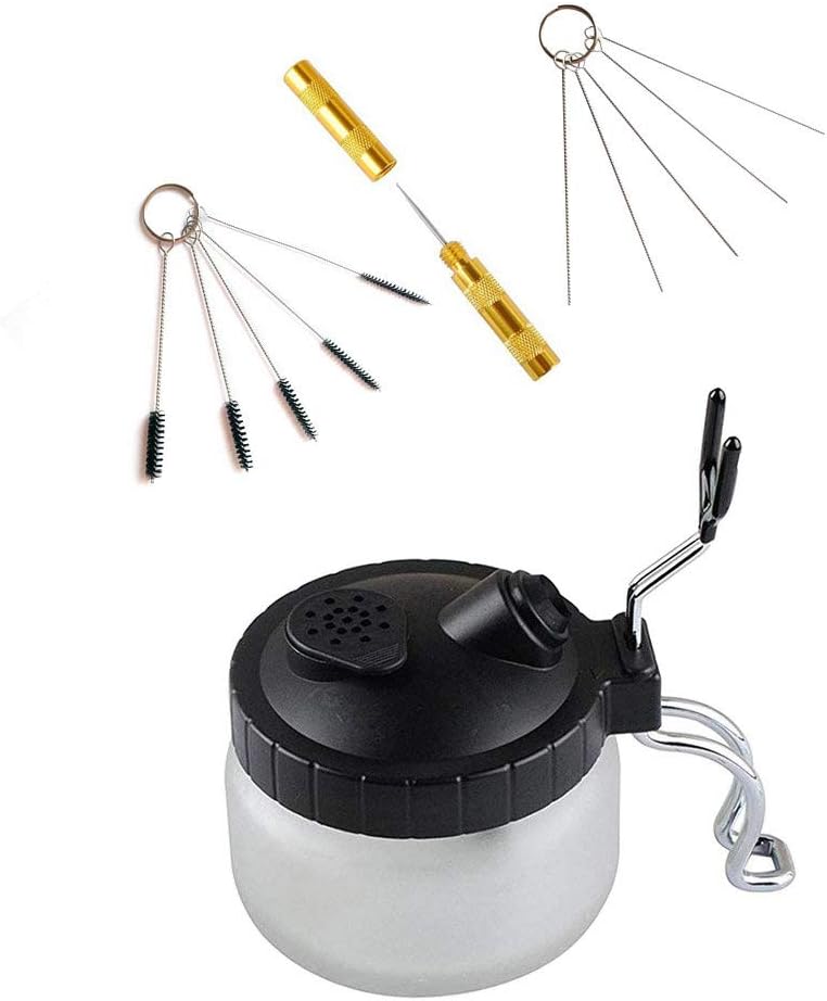

Harder & Steenbeck Cleaning Brush Set, small & fine brushes that won’t scratch.
Airbrush Spray Gun Wash Cleaning Tools Needle Nozzle Brush Glass Cleaning Pot Holder
I use the pot ALL the Time, obs.
The ‘pick’ is sometimes usefull, (be gentle), & only the smallest brush is usable on my Iwata CH or Badger Omni.
Needle Packing Screw Drivers, (bottom) essential to replace/tighten the teflon needle packing seal & air valve spring (top), but not used often though.
