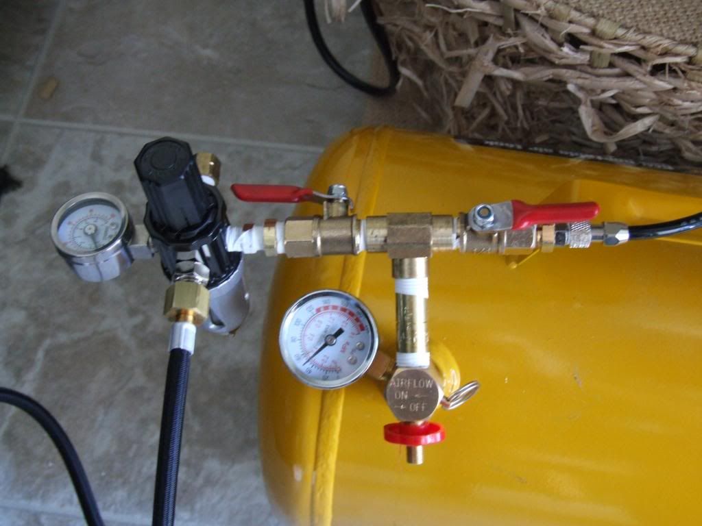

Well, I took the tank route instead. I think it works pretty awesome. The compressor fills the tank to about 45 lbs. and then shuts off. I have been able to turn the regulator down to 5 PSI and get consistent airflow, so I think it will be more than sufficient. Thanks everyone for your input. This forum is why I come to the experts.
Yes, that’s a cat tree. Little buggers run the house anyways so I’ll use their’s for something useful. They don’t use it anymore anyways. [:D]
Nice adjustment, Charles!
Nicely done.
Don
Very nice job. Nothing works better than what you build yourself.
I did something similar a few years back and it worked well over the years.

I took some close up pictures of my setup. Hope this helps. I got all the fittings from Home Depot.
I was about to suggest Teflon tape but I see you’ve adressed that
