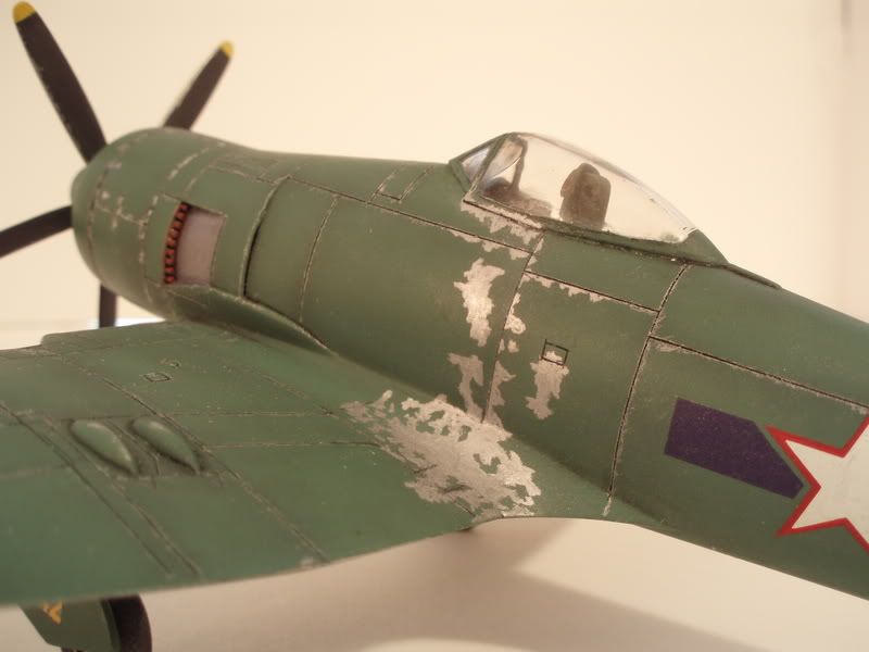

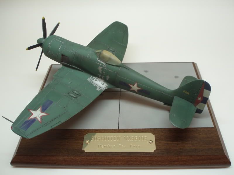

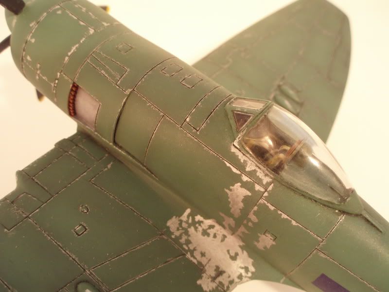

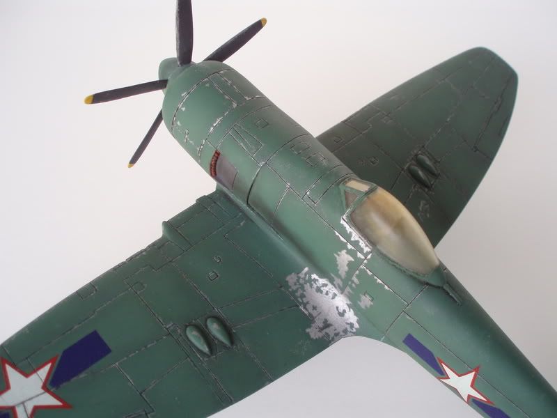

The easiest way is how Gerald wrote, and you can also do successive lighter coats to get your desired results. This is Model Master II dark Euro green cut w/flat white(two different light filters on pic’s, the darker color is the true color).
