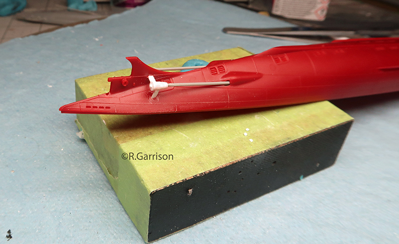

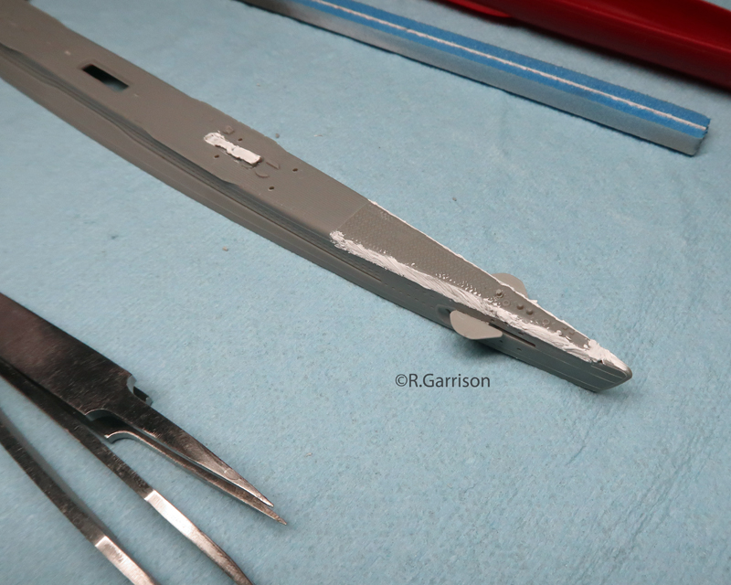

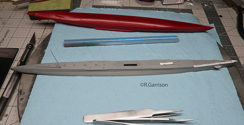

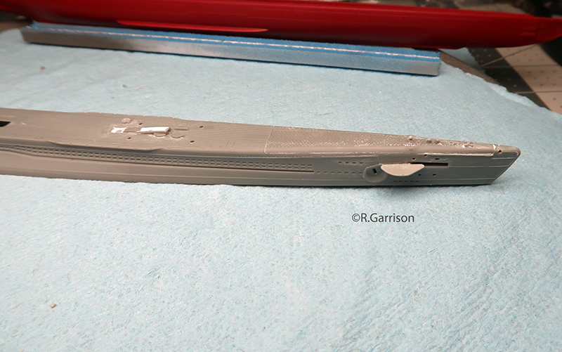

Started step 1
I took some Perfect Putty to help clean some glue joints

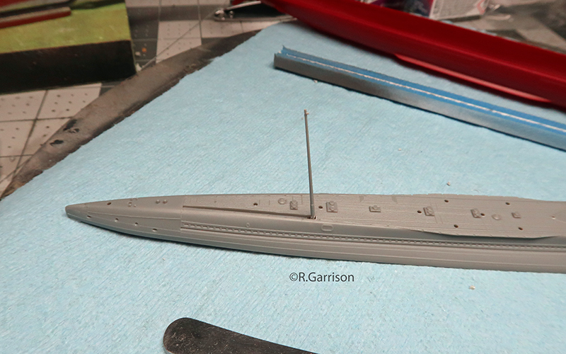

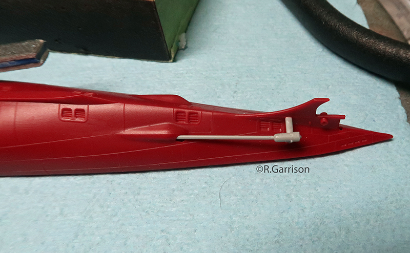

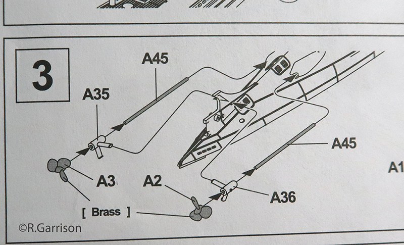

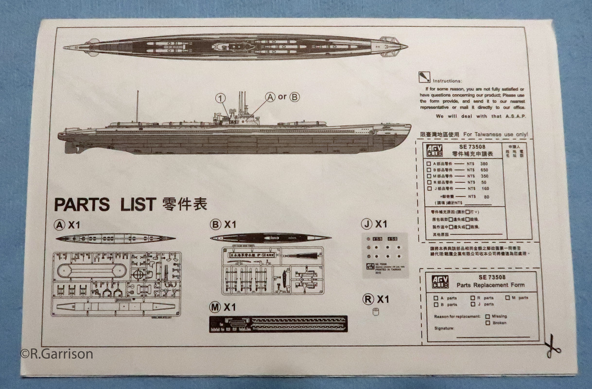

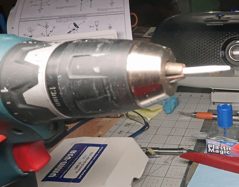

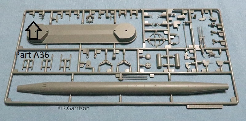

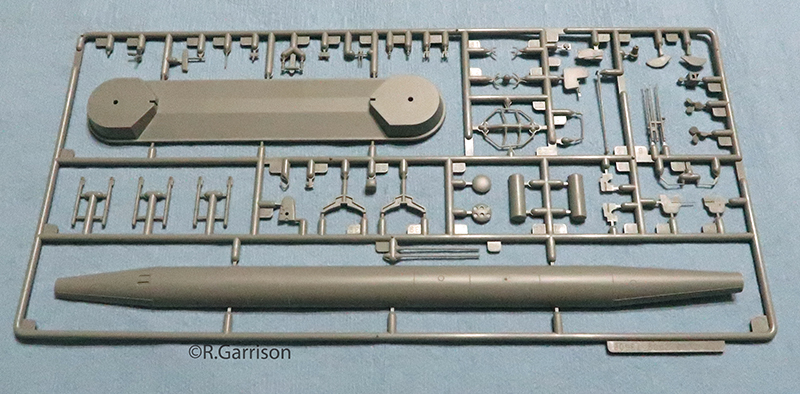

Started step 3 . part A36 was not on the tree . I went back to my photo when i pulled the tree out of the package . Sure enough part A36 not there . I sent email to AVF Club . I will see if I get reply . I took over side round plastic sprue … then took my drill and sand it down to the correct size . Not perfect but very close for my eye .

Like the work you have done so far. It will look great with the Indy…Cheers mark

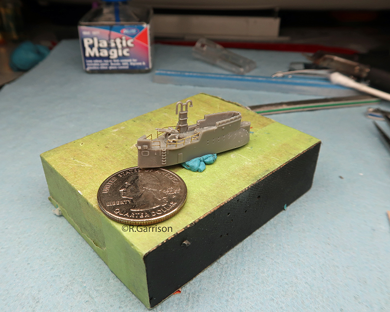

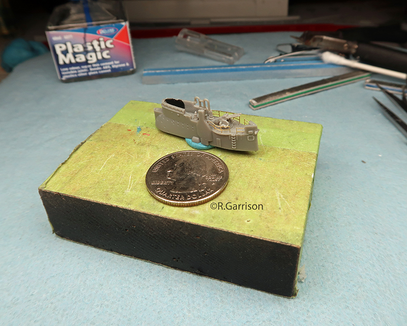

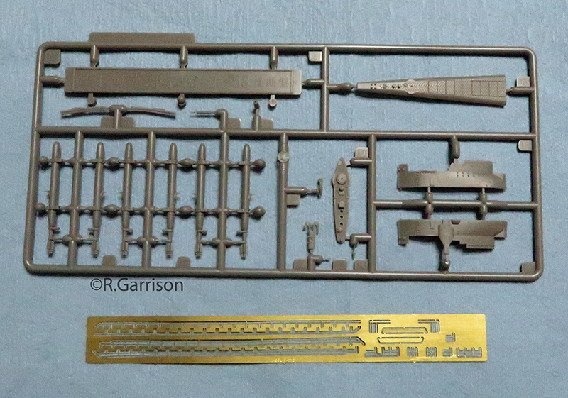

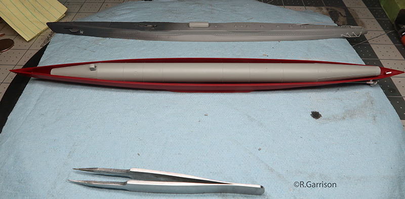

Working on the outside Tower with Photo Etch
Rick

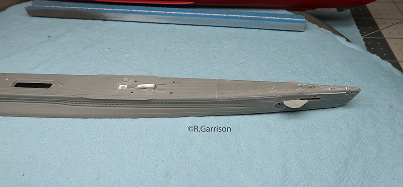

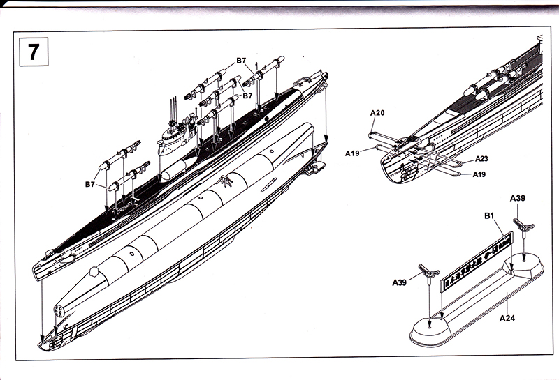

Not sure what step 6 does . But I installed it .

Very nicely done so far. I think you will find Step 6 is building her Inner Pressure Hull just like the real 1-1 Scale…Cheers mark

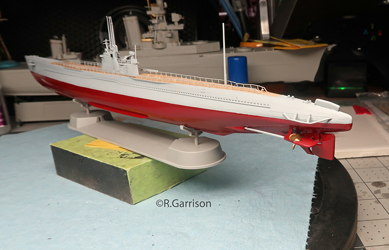

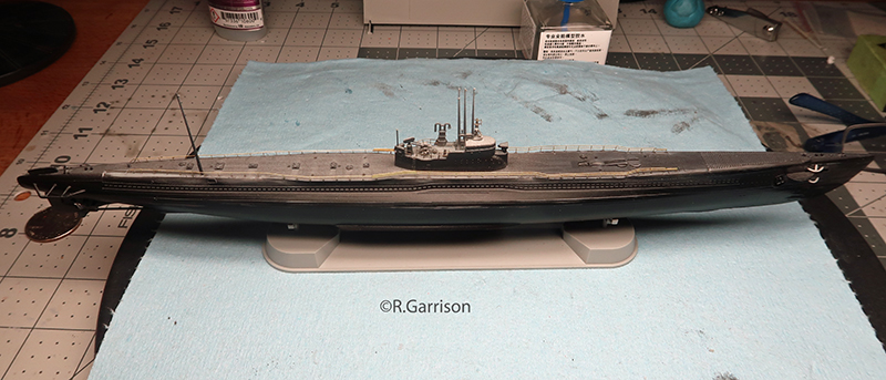

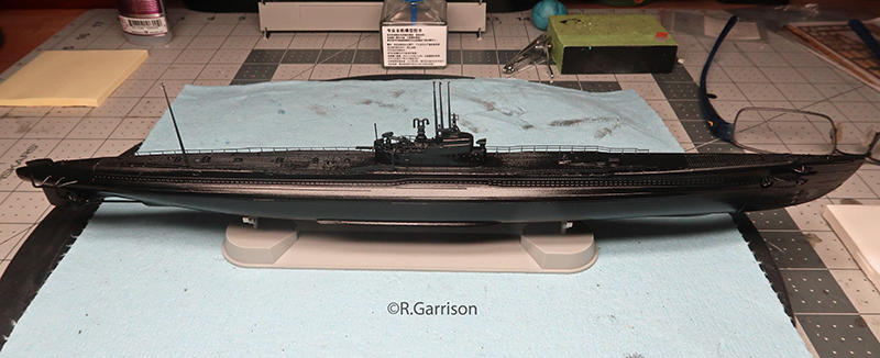

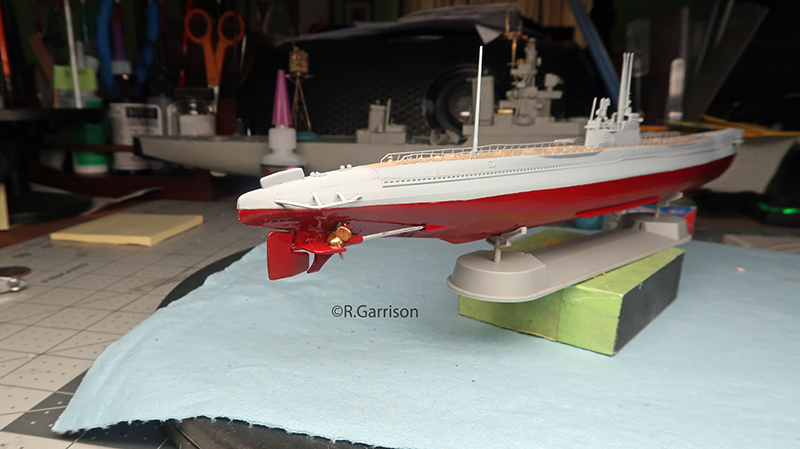

I have to PE gaurd rails installed yesterday . This morning i sprayed Alclad Black primer . Now I need figure out the paint colors

It is always a good feeling when the Model is together and ready for Painting…Cheers Mark

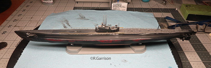

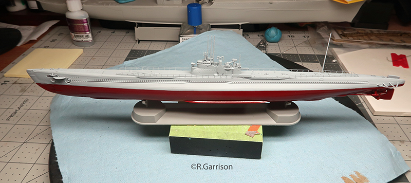

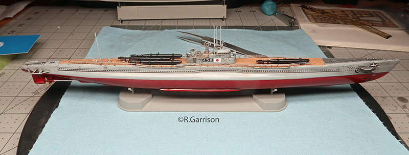

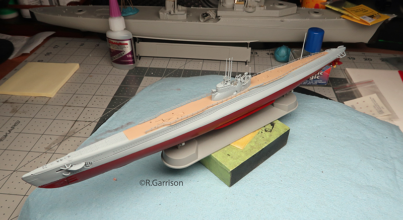

Applied the upper color
I have the wood deck painted and propeller
Rick
Very nice and clean Paintwork…Cheers Mark

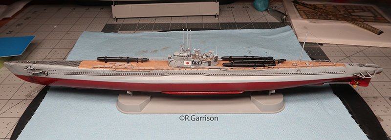

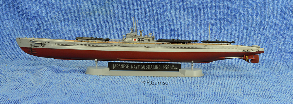

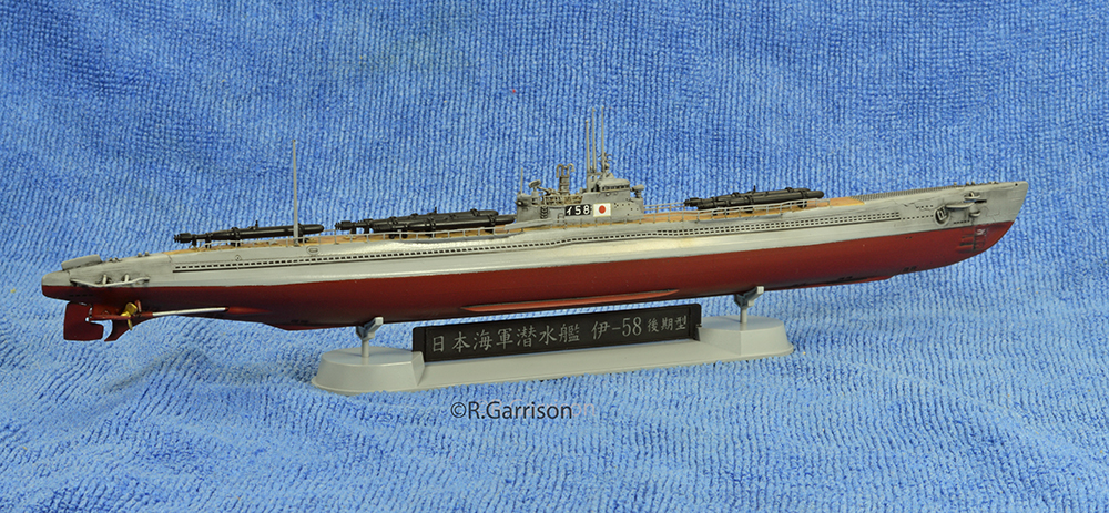

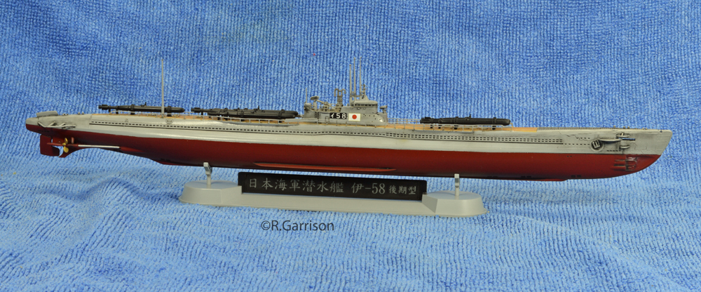

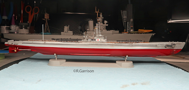

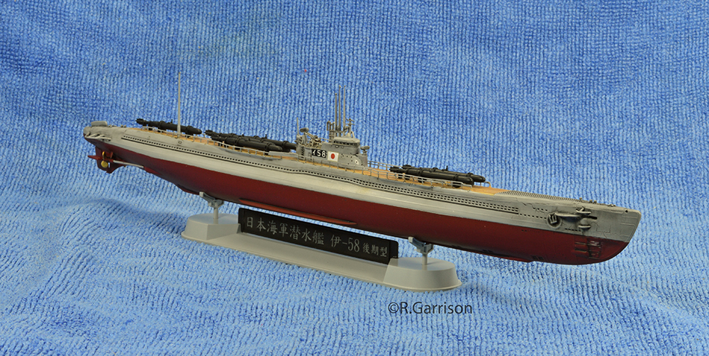

Japanese Navy Submarine I-58 1/350 is finished .
Paints Tamiya
Alclad Aqua Gloss Clear and Alclad Matt Clear
Thank you
Rick

Such a nice build! And an unusual subject matter. You don’t see many Japanese submarine models.
Gary
