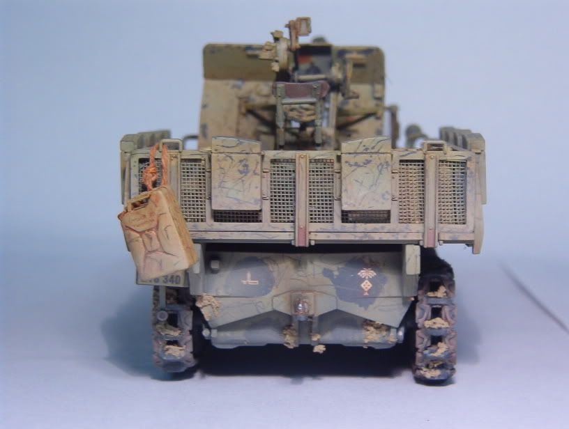

The mud also often wore off or was just not applied to some areas. Take a look at this pic
the markings are untouched and some of the mud has scraped away.
here is the dark yellow i used over a dark gray base coat
here is the desert yellow applied staight to the kit- no primer.
