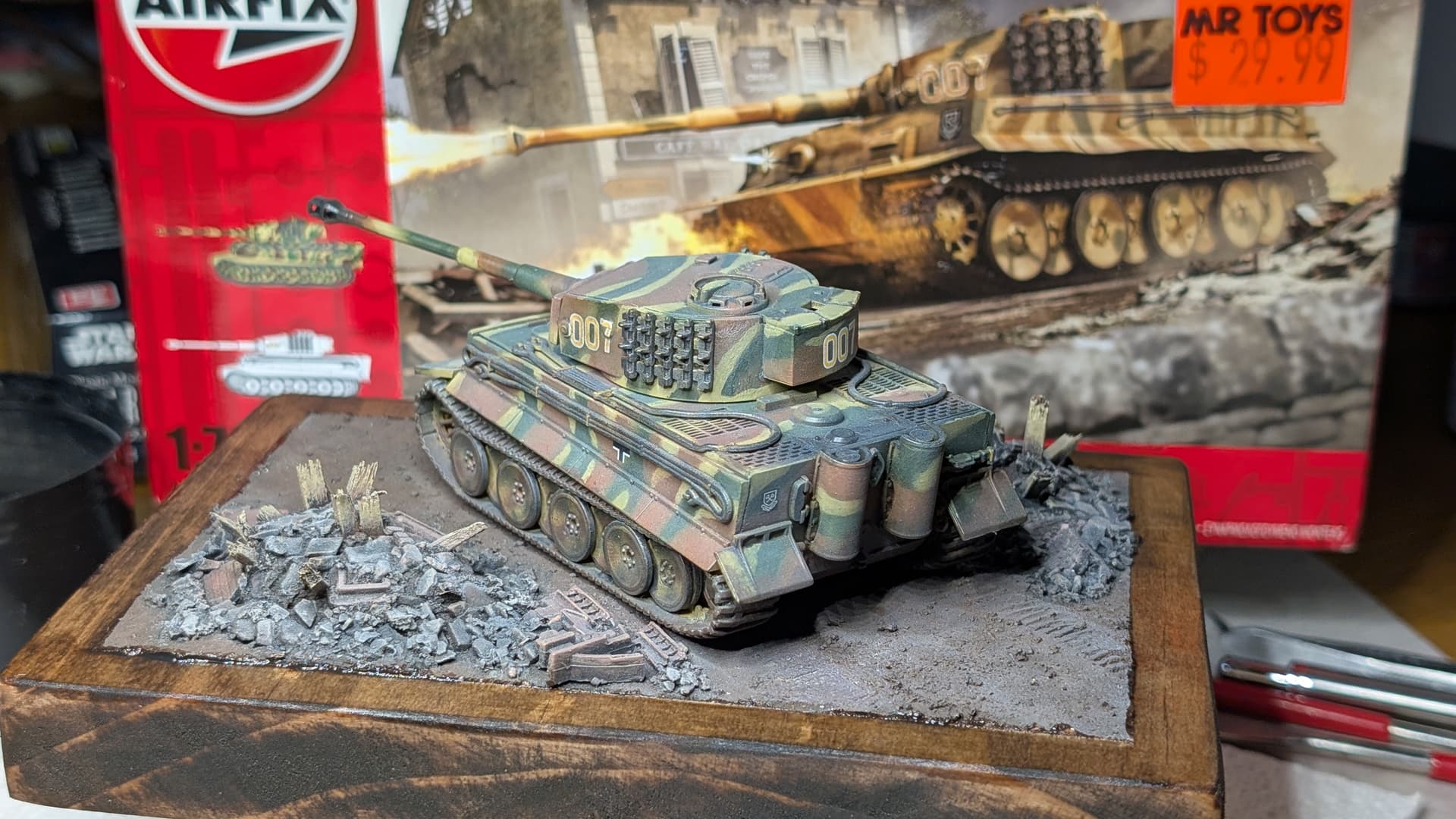

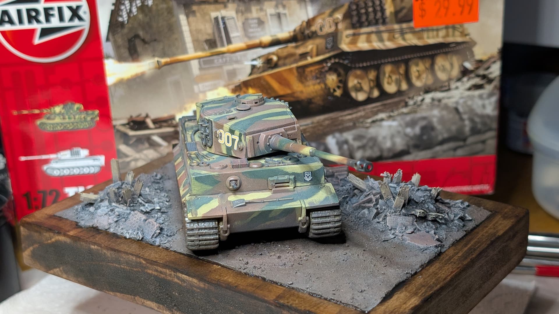

Finished product… Thanks again all!
Looks great,now add a few figures to bring it to life !!!
