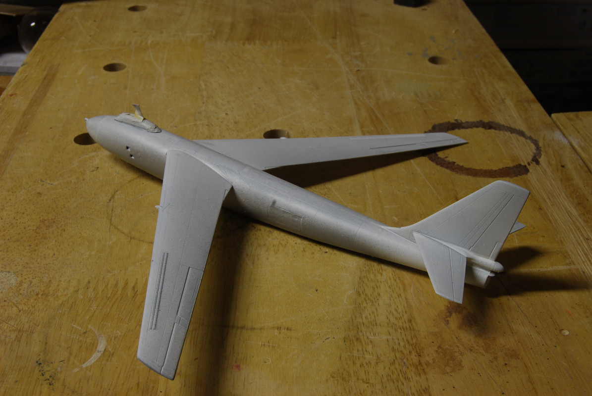

Here are a couple of shots. First is before I tore the wings apart to drill the drop tank mounting holes.
Next is a shot from today, with the wings fixed. I glued the broken parts back on. On one side the part fit so perfectly that it did not even need filling. on the other side, it needed some slight amount of filling of the seam. Got that done and it looks fine.
The crack was in the top wing, just outboard of the root. Looks okay now. The model is sitting on the piece of particle board that will be the base. You can see the saw kerf that the Lexan pylon will fit into.
I decided to paint the engine nacelles and the drop tanks seperately and attach after the model is painted. I believe if I put them on first, it would make painting the bottom of the wing too difficult.

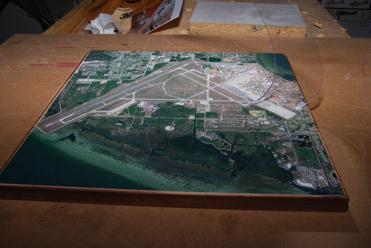

Grabbed a few pictures this morning. First is of the base and pylon. The picture on the base is a Google Earth shot of McDill AFB, where the B-47 was based.

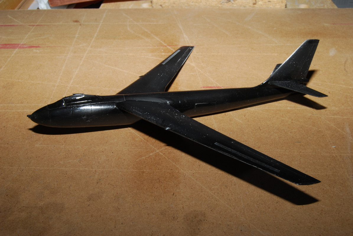

Second is the model after two coats of gloss black. Lots of dust specs and hairs in it, so sanding it out. Hope one more coat will get it ready for Alclad.
That’s a great idea for the base Don. Sure looks cool in all gloss black. I tried the alclad black base on my current motorcycle build and am very pleased with it.
Very nice fo far Don, I like your choice of base too…
Ben
Wow, Don! That is a fabulous “base” base. [:)] This is going to look spectacular.

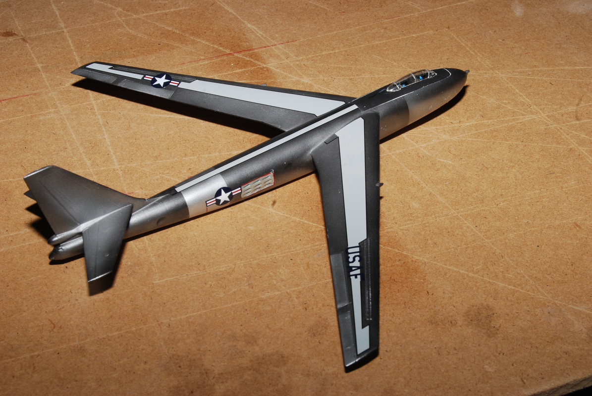

Got the Alclad work all done, and starting the decal work. Decided to try the wing walk decals. They seemed to work okay. The ones surrounding the JATO bottles were real bears, though.
She’s looking good, Don. Will it have the SAC sash on the nose?
No. I wanted a scheme based in US. There were only two schemes provided from US base, both from McDill. These are earlier ones, without the sash. I will put the SAC logo on the nameplate, though.
