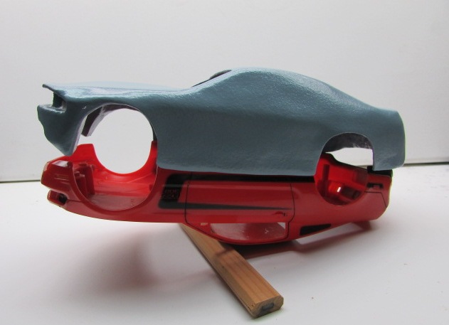

If it does, it should separate easily enough from the masking tape. It did.
The cast came off the mold fairly easily and went back on just as easily. A few more layers of casting material were applied so as the give the cast sufficient strength and integrity for it to be worked on separated from the mold. A small piece of wood was attached underneath the hood to give it some needed strength and reinforcement. Obviously work such as this is impossible to do while the cast is still on the mold. That is why it is so important to have an overall solid cast formed and ready for exterior painting before removing it from the mold for the very last time.

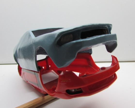

An individual grille piece was cast and then applied to the original cast.
(https://postimages.org/][img]https://i.postimg.cc/DzbmDrcf/Ford-Mustang-cast-002.jpg[/img][/url)]
The joint where the front wheel well openings mated to the body were filled in with casting material. An individual form was made to complete this job.

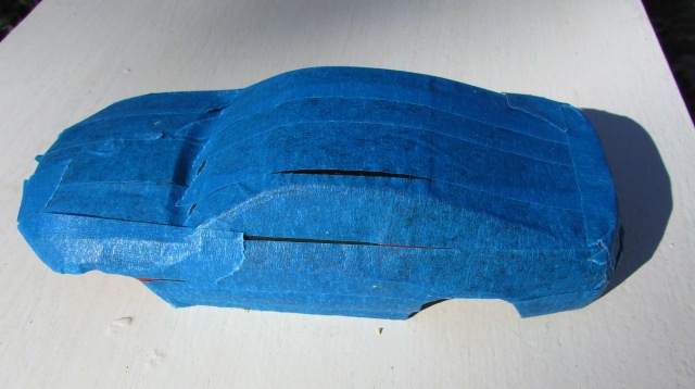

Covering and Securing to the Mold a Suitable Paper Product:
Choosing a suitable paper product as the starting point or the basis for the cast is important because we are looking for strength, porosity for accepting the cast material, ease of positioning on the mold, as well as thickness. Perforated paper towels and wipes seems to have most of these desirable traits.
We want to be able to drape the entire paper over the mold, and secure it to the underside of the mold, trimming excess paper from the wheel wells and the areas where it is not needed. The idea here is to get as close a fit as possible so that the paper conforms to the mold’s details as much as possible. Note any areas that might cause a problem upon releasing the cast from the mold; that is, undercuts in particular. Secure the paper to the mold with some masking or similar tape. Just some short, small pieces enough to hold in place the paper while adjustments to the fit continue to be made. This can be a frustrating task, but it is crucial that the best application of the paper be done so as to ensure a well-formed cast. Spend the necessary time here to get a good fit. Since a flat piece of paper has difficulty bending and conforming to curves, angles and irregular surfaces, wrinkles will inevitably occur. Try to minimize these wrinkles as much as humanly possible. And try to position these wrinkles in an area on the mold that would strengthen that particular spot or would be relatively unnoticeable. This area, when casting material is layered on the paper, will stick up higher than the rest of the surface and will require more finish work, sanding, etc. later in the build.

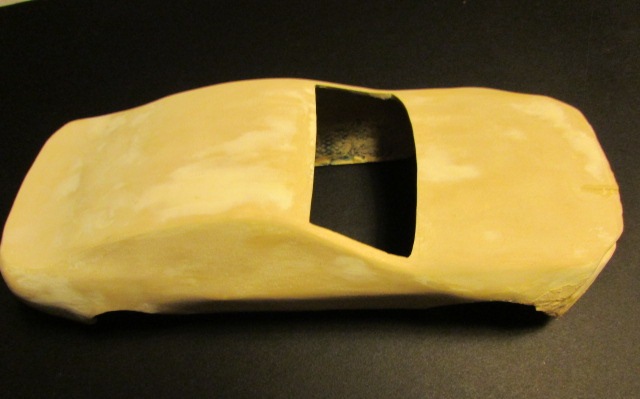

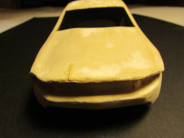

Additional layers of casting material are applied , sanded and formed to obtain a final smooth surface to the cast. Having the cast on the mold lends good support for filling, smoothing, inspecting, sanding and ease of handling when performing these various tasks. Corrections to imperfections in and on the surface and problems with body areas are also corrected here as well.
See how the surface needs to be filled and sanded smooth:

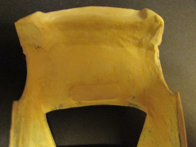

A major and extremely important consideration is how to treat the windows on the cast. Obviously the windshield should be cut out from the cast. It is debatable whether the other windows should be cut out also. What determines this is whether or not doing so would jeopardize the integrity of the cast as a whole. If the cast were to be jeopardized as such, a workable alternative to cutting out those spaces for the windows is using black decals or black paper pieces applied to those appropriate window areas. I spray painted a sealer on the back of black colored paper and applied these facsimiles using a Glue Stick as an adhesive to the cast.
What I found, in Case 1 -1951 Chevrolet Fleetline, was that by cutting out all the windows, this seriously weaken the support pillars of the roof as well as the roof itself. Consequently a substantial amount of reinforcement material went into beefing up the underside of the roof and scabbing on wood and metal pieces to the roof pillars. These structural problems could have stemmed directly from using tissue paper as the starting point of the cast as opposed to perforated paper which appears to make a much stronger shell. The point here is to carefully access how cut outs for windows will impact the structural integrity of the overall cast. You don’t want to get to this advanced stage of completion and fatally remove sections of the cast that would essentially “destroy” the cast. The window cut out situation is a point of no return. Give this extra attention and thought. There is no easy turning back after the cuts are made.
