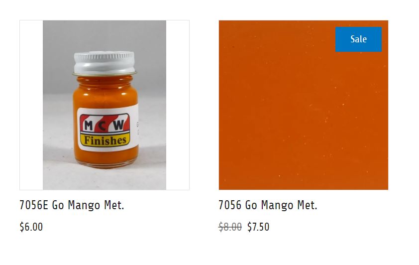

  3. Anyone know why some colors stock number ends in ‘E’. For example, Go Mango, is listed twice as 7056 and 7056E, with different price?
TIA
The -E paints are enamel. Those lacking the E are lacquer. That is my understanding of their system.
Well Heck, that is good to know… Thanks.
