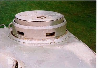

Panther Ausf D with early cupola didn’t provide for an AA mount from the factory as seen in this photo:

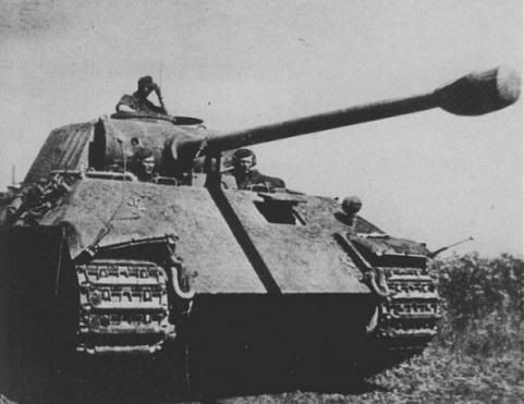

but this pic apparently shows an added ring attached to the cupola

The Early Panther Ausf D did not have AA MG mounts as Derek has said. The above pic is of a very early Ausf D now a memorial in Holland (the only known survivor in the world). The lack of the cupola hatch lock determines it’s age.
Production orders August 1943 called for the addition of a simple ring to the cuppola top with an ‘L’ shaped bar welded to that as a support for the MG like this:
