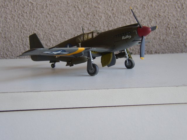

I do believe that’s the kit that Pixilater just completed not too long ago. It seemed to come out very well… he’d probably be glad to answer those questions for you. As for ref. photos… I’ll see if I can dig anything up.
I searched for quite a while, and didn’t find much that was specific for an A-36. You can do a search for P-51 & 51a, which are also Allison-engined.
I glued the nose halves to the fuselage halves first. The wing fit without any filler. The only place on the kit I had to fill was the separate scoop on top of the nose.
If you want to open the canopy, I’d suggest getting a vac from Squadron. The injected one is thick, and mine has a hairline crack from opening it.
I didn’t use the kit decals. I used a sheet from Three Guys Replicas. I used the kit decals on the first one I built. The mission markings were tedious to apply & align, but the wingstripes worked well for me.
I used Eduard’s PE detail set on this one.
I’ll edit this post so you can see the kit decals.
Hope this helps !
