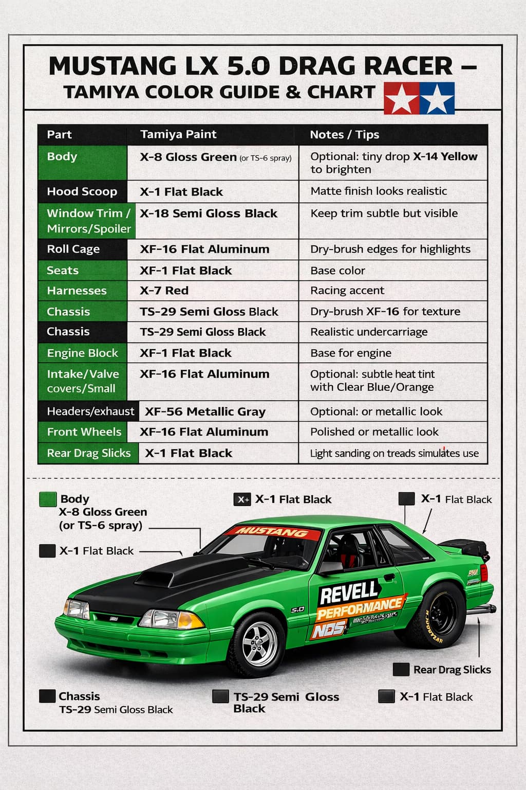

I used chatgpt and asked it to show me a white, black, green ( this one I liked) and a green with a full black hood. This is what it created:
I liked the green with the black hood.
Next I asked it to match me up the colors if I were to use Tamiya x-xf paints, make me a chart and a map. It gave me this:
That’s how I start now days, let’s you visualize the project and help with the paint and mixing colors.

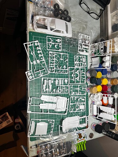

ok for those interested, here is what’s in the box

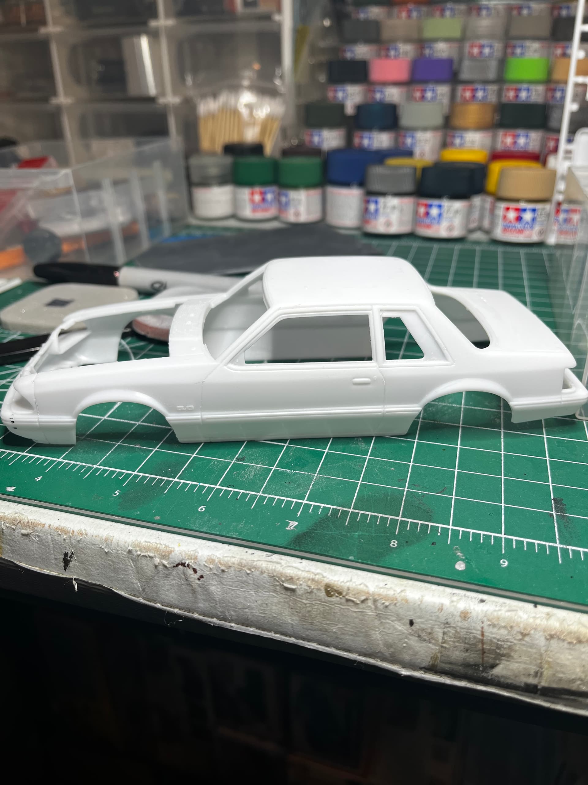

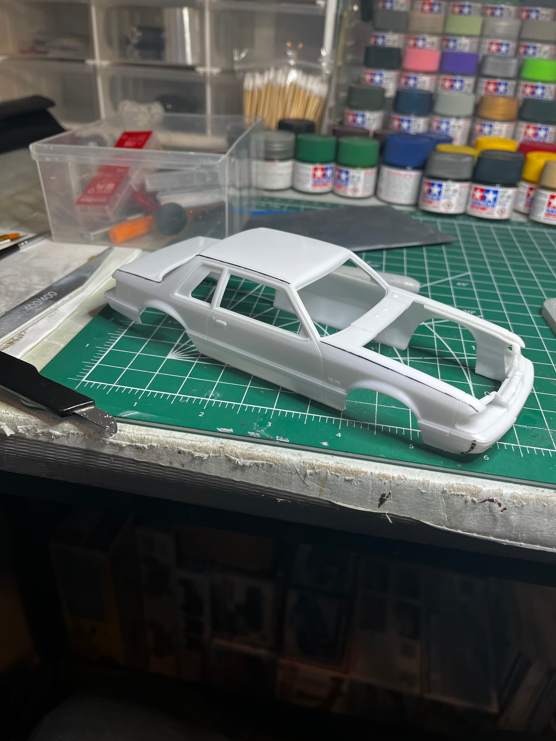

Everything looks pretty good, no flashing, no loose parts. I started by inspecting the body, marking the spots that need sanding and making the pannel lines deeper.

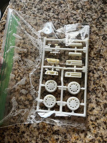

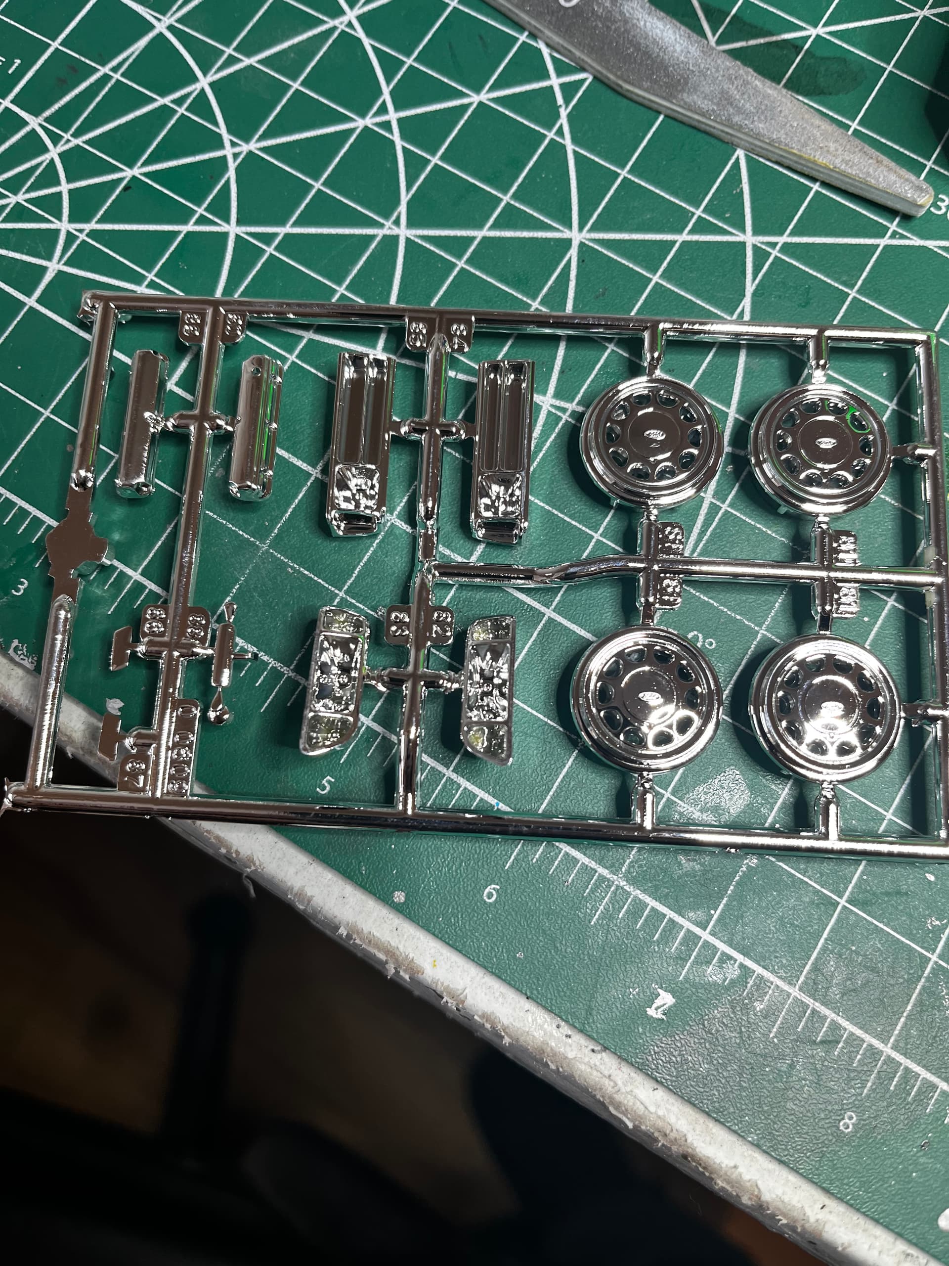

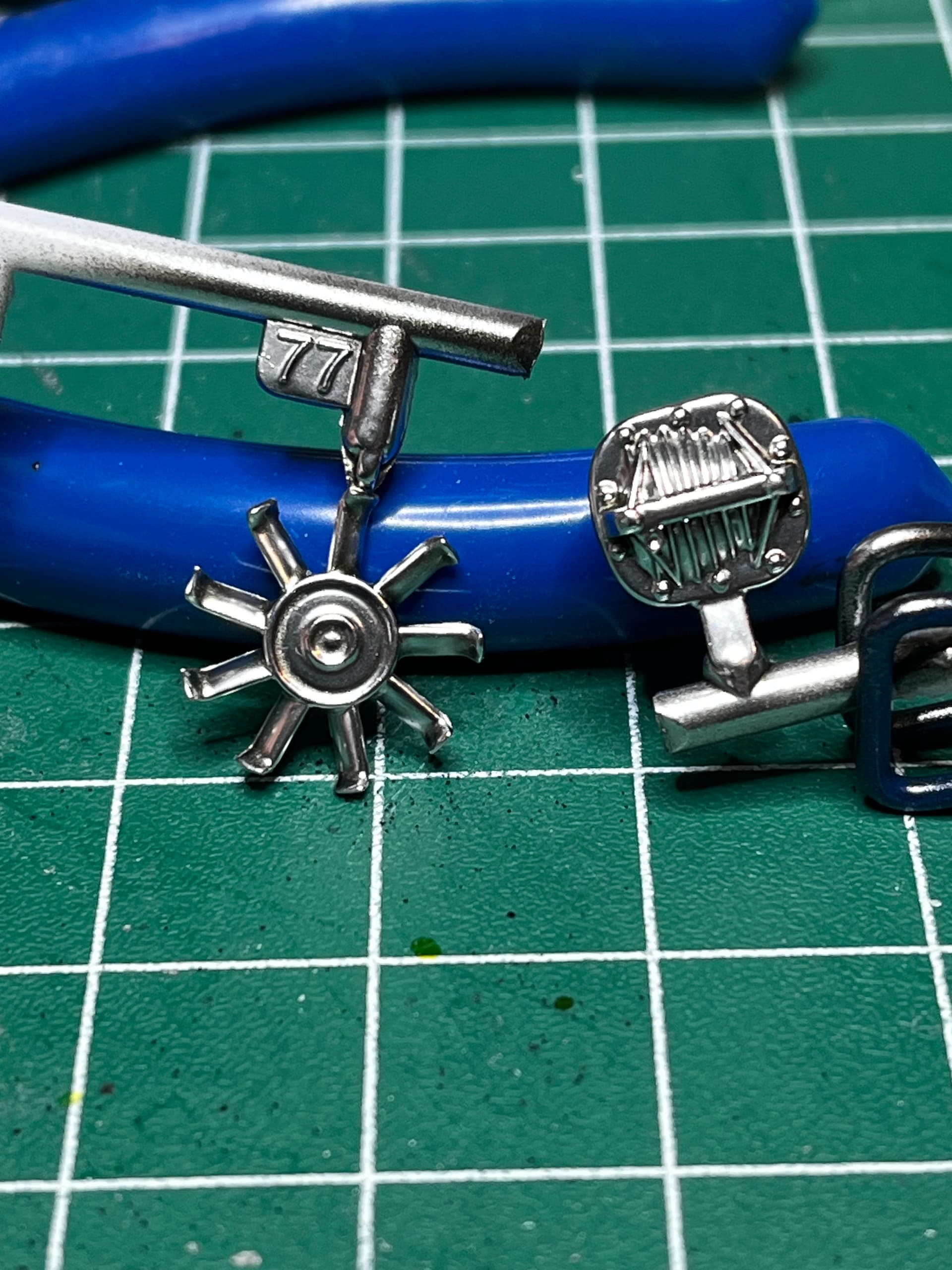

I grabbed the chromed parts and put them in a bag with some oven cleaner, let it sit about an hour then washed it off with dawn dish soap.

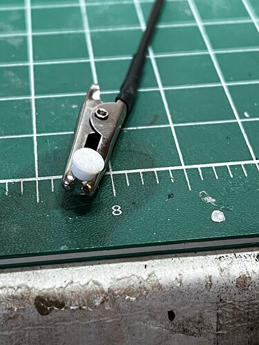

Next I sanded off the raised spots on the distributor leaving just enough to mark with a sharpie then drilled holes.

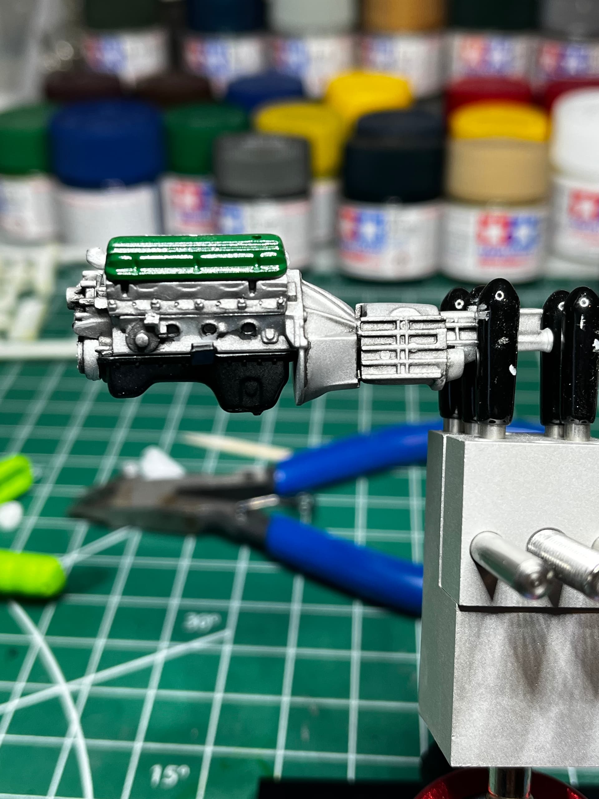

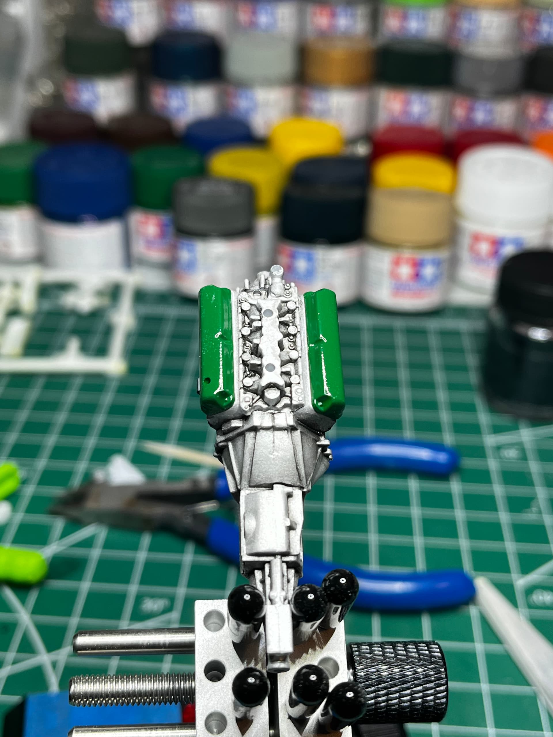

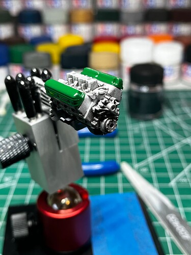

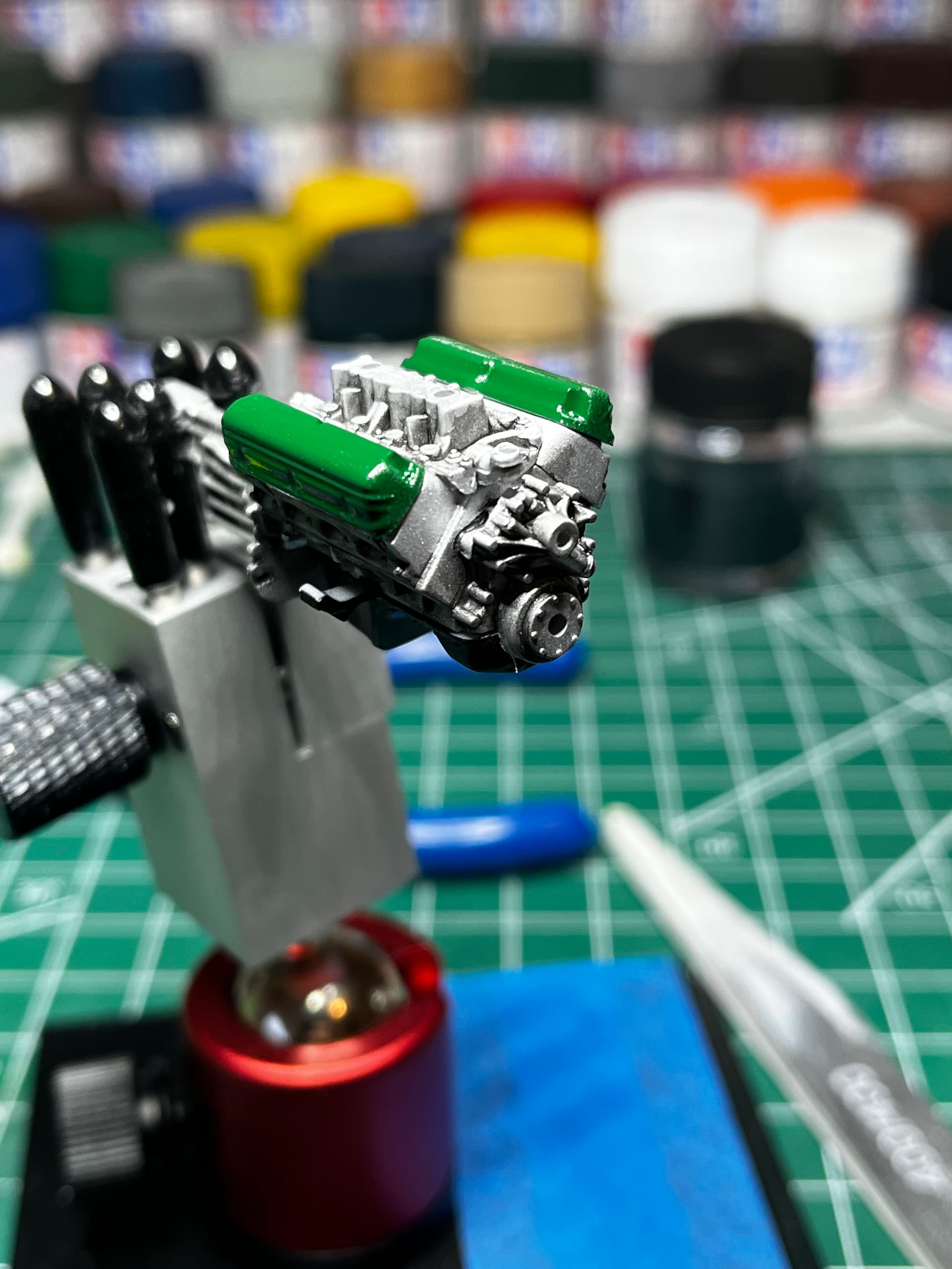

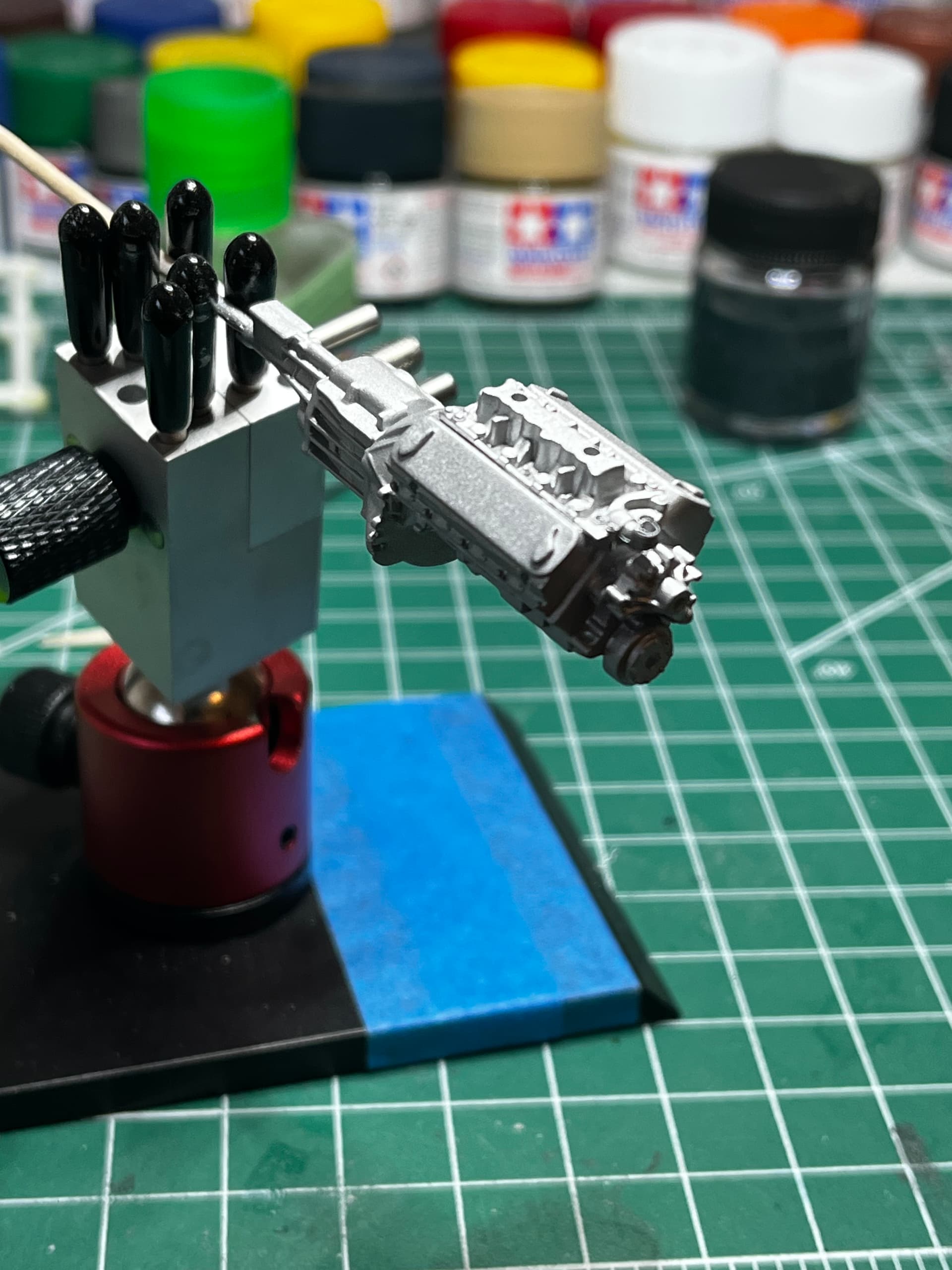

Assembled the engine block, primed and painted it, mixed up some Tamiya x-5 green and x-8 lemon yellow 10:3 with 50% x-20 thinner and hit the valve covers, let them dry. Pin washed the engine, and installed the valve covers. painted the starter and slapped it in place as well.
Uploading: IMG_1462.jpeg…
Uploading: IMG_1463.jpeg…
Uploading: IMG_1464.jpeg…
Uploading: IMG_1465.jpeg…

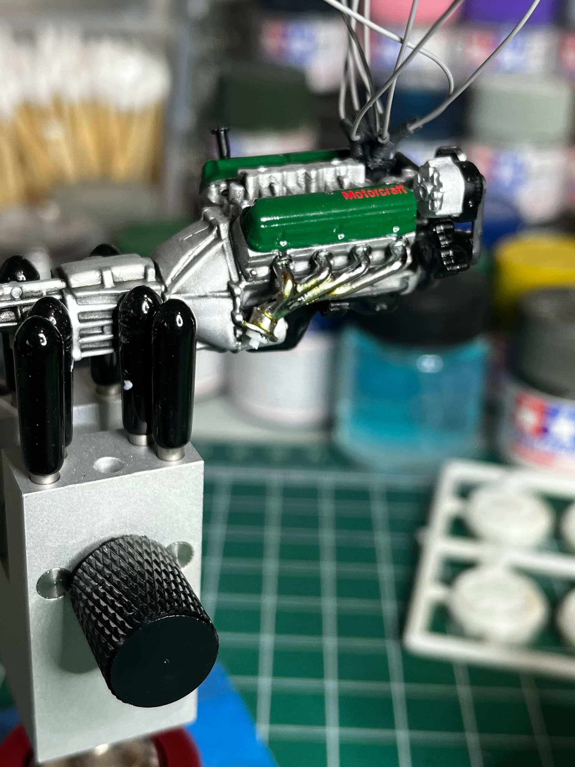

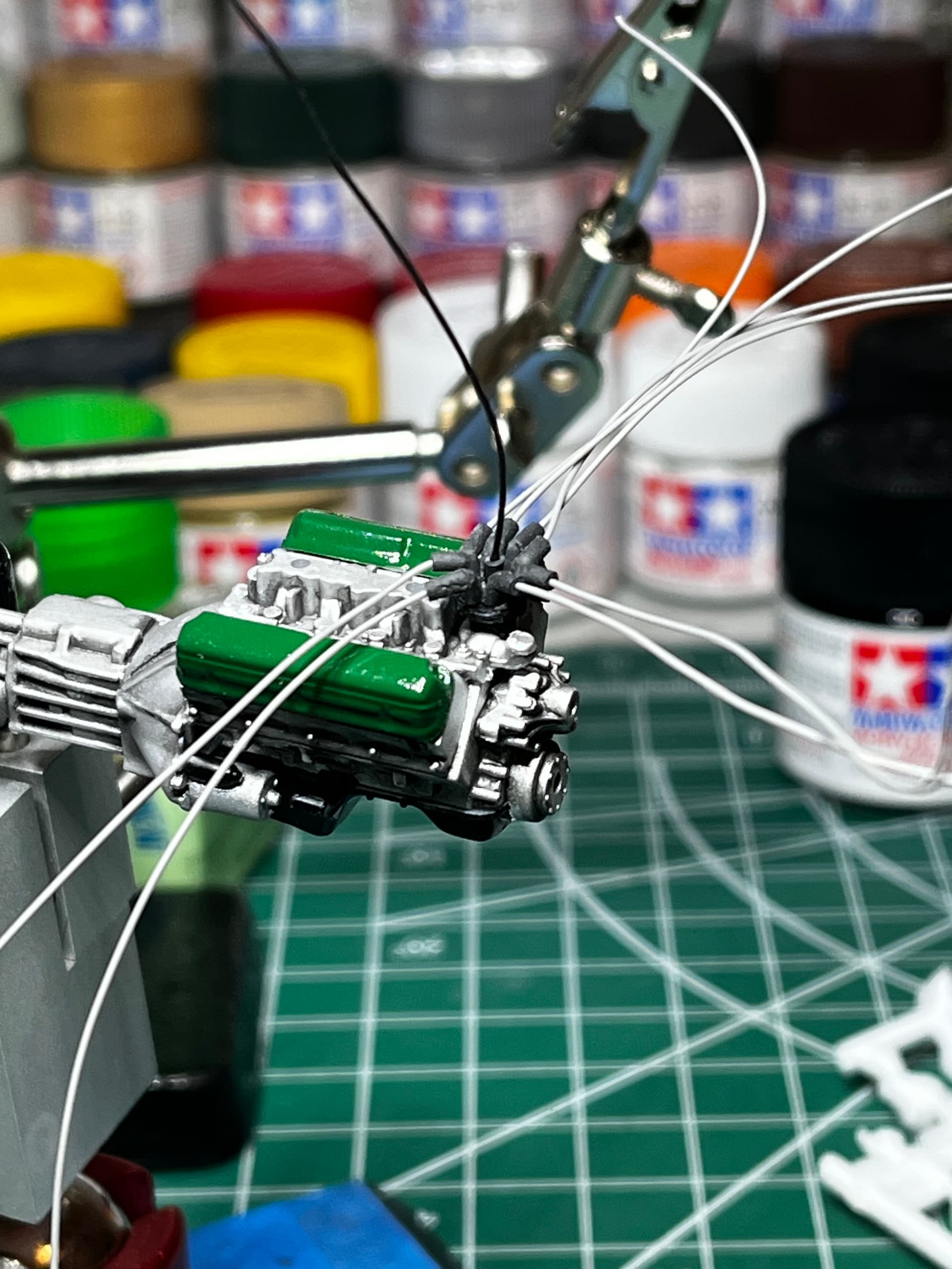

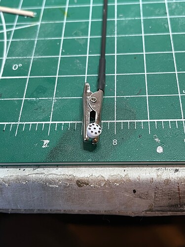

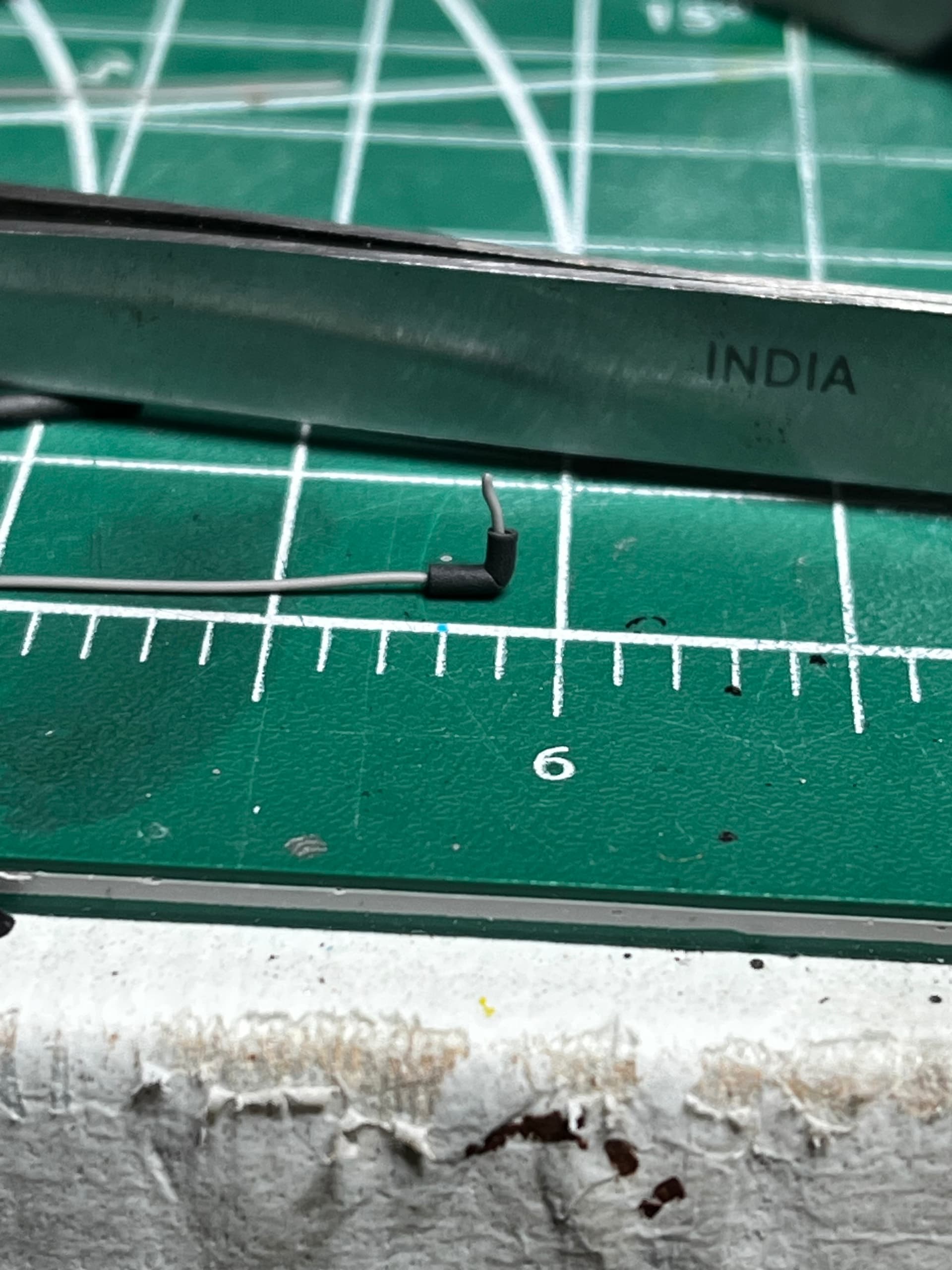

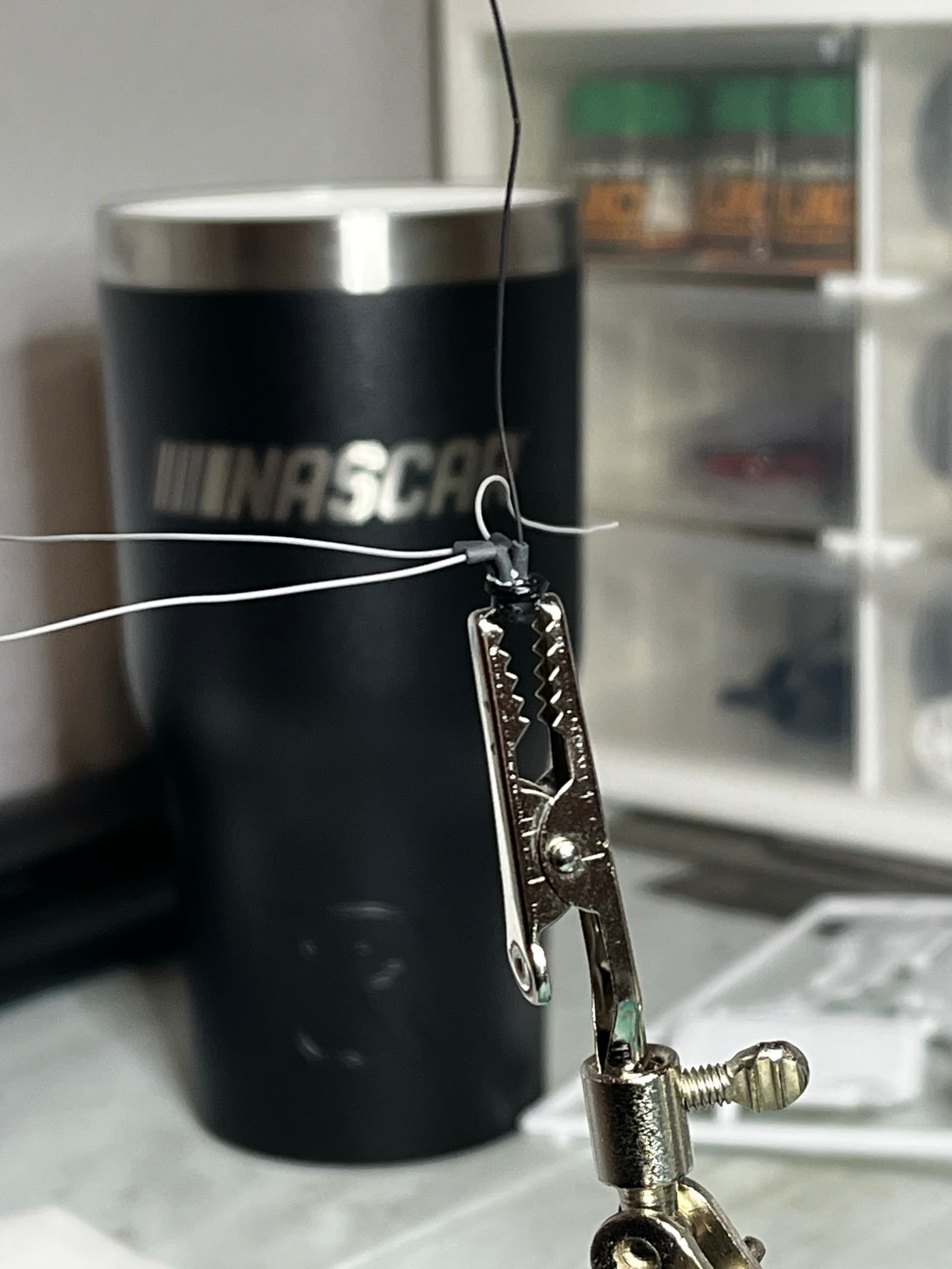

Next I painted the distributor, and started adding plug wires, I cut the boots at a 45°, ran the wire through and bent it over then used super glue to make it stay put ……like a good spark plug wire.

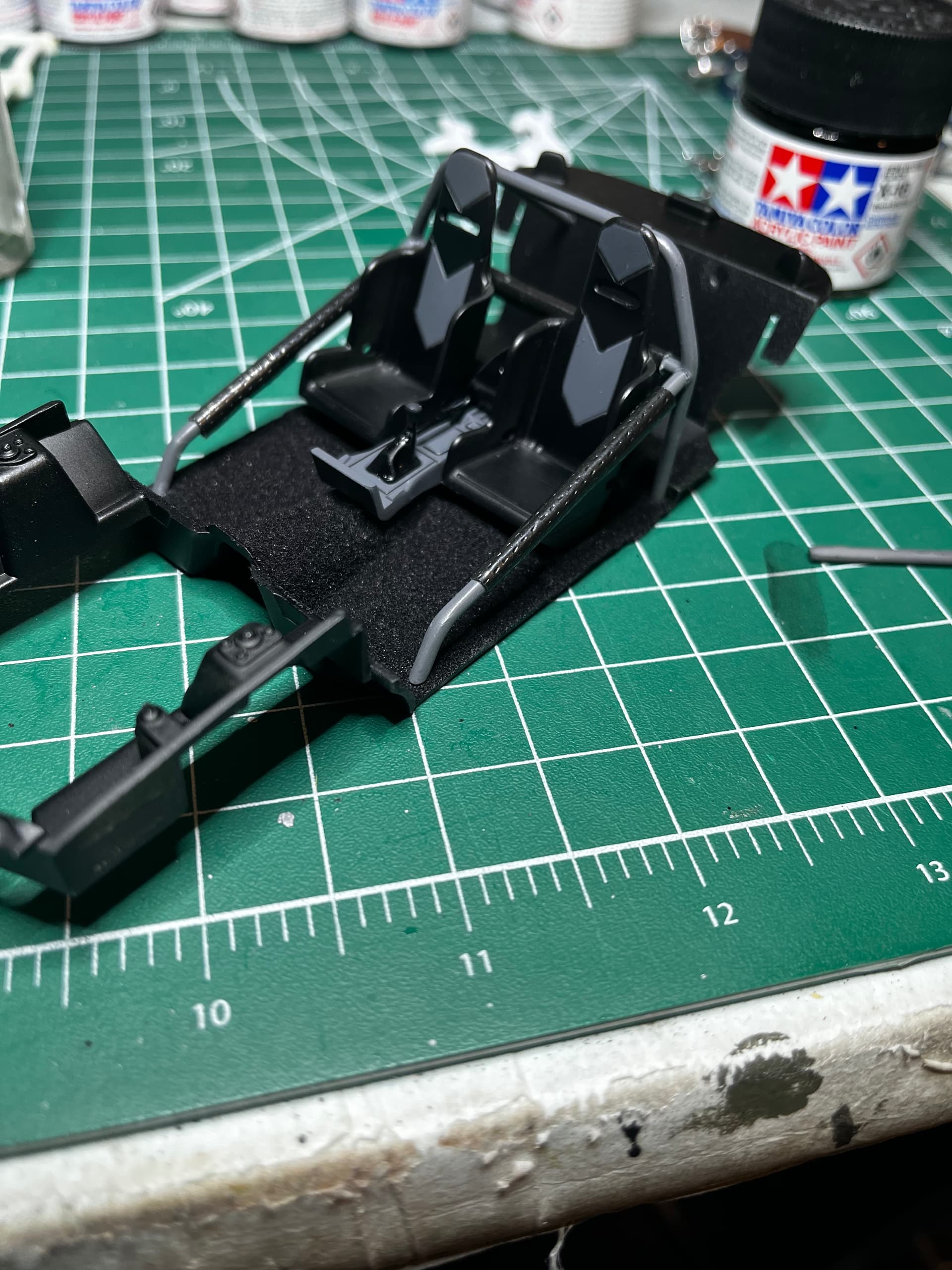

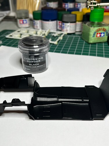

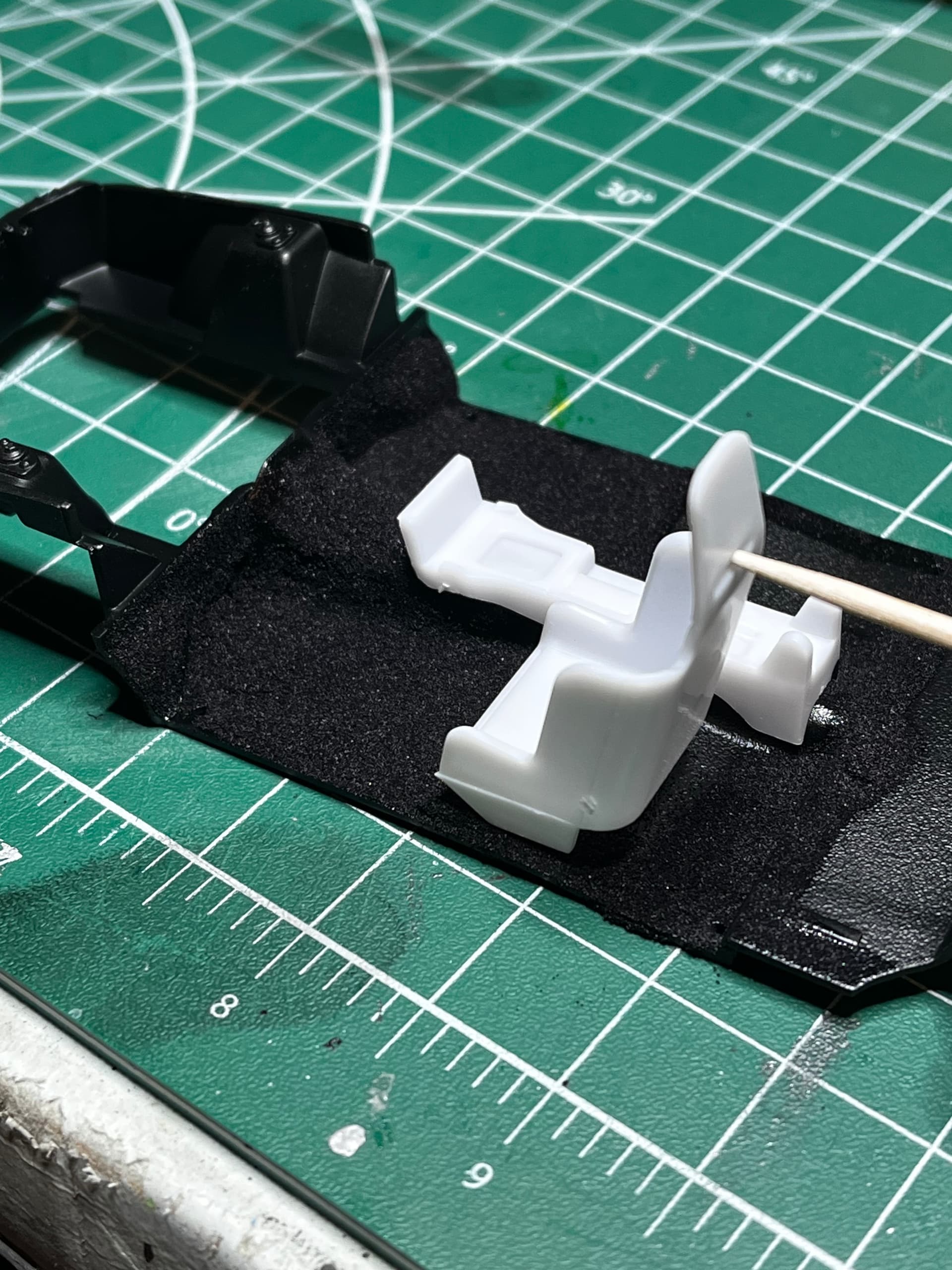

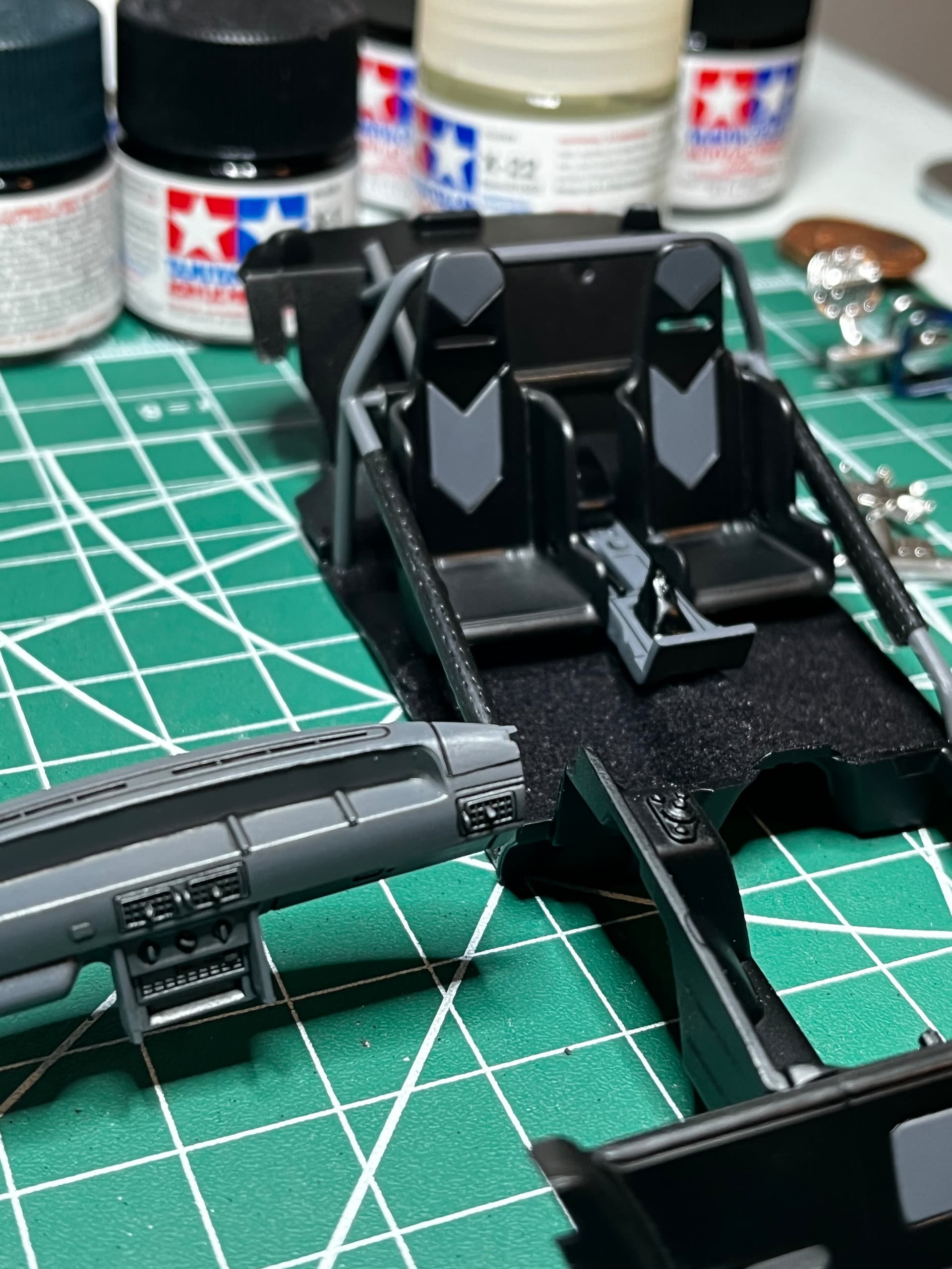

Lastly for the day I primed and painted the floor of the cab, and used embossing powder for carpet because who wants to drag race an uncomfortable no carpet car?

Then engine pics didn’t want to load I guess so I’m trying again…

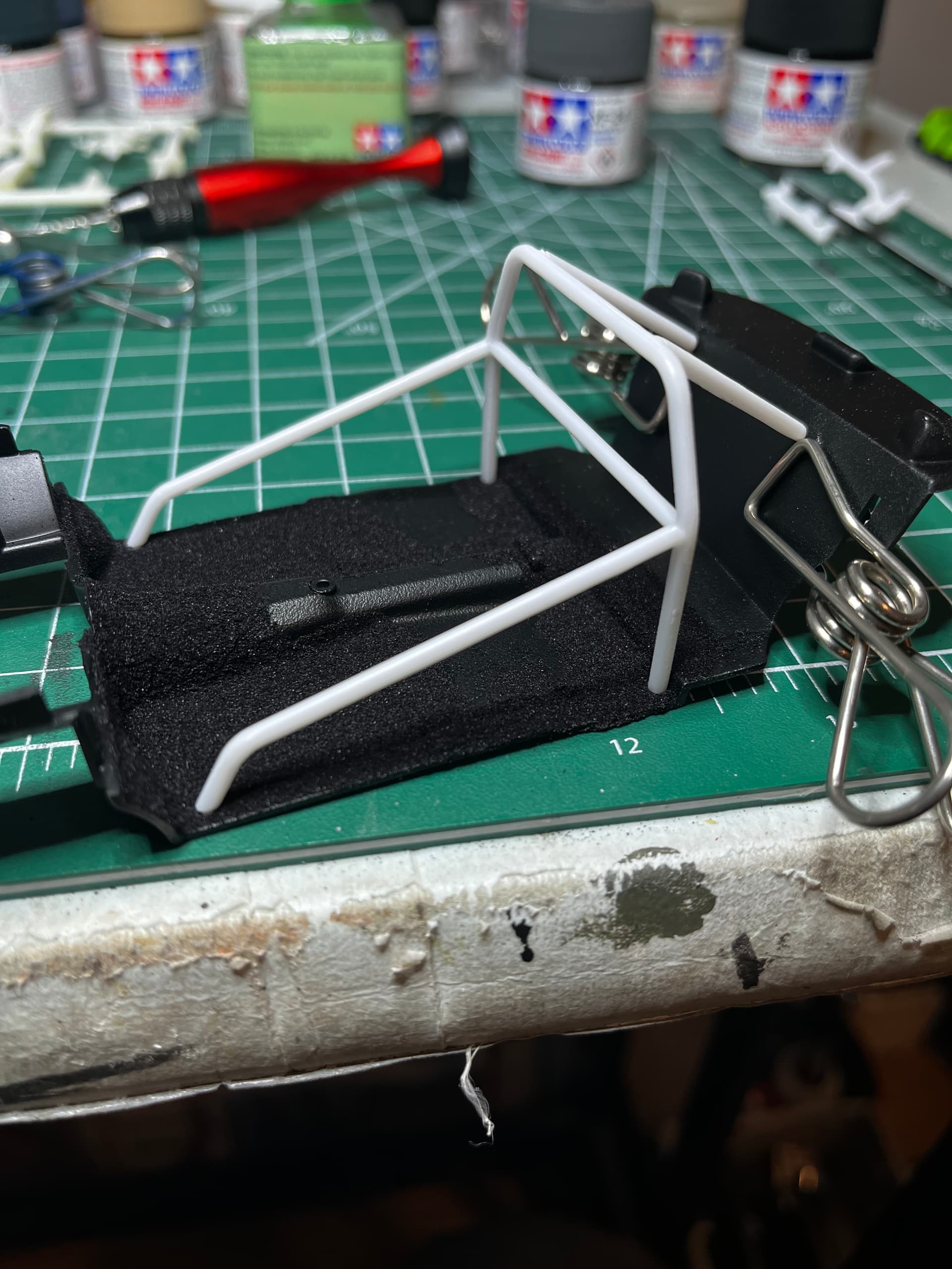

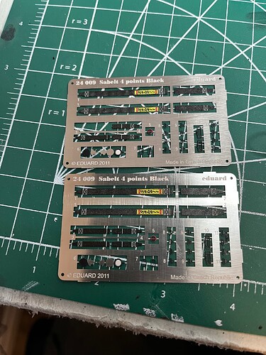

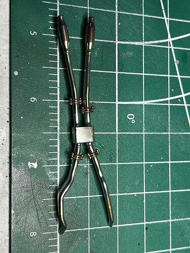

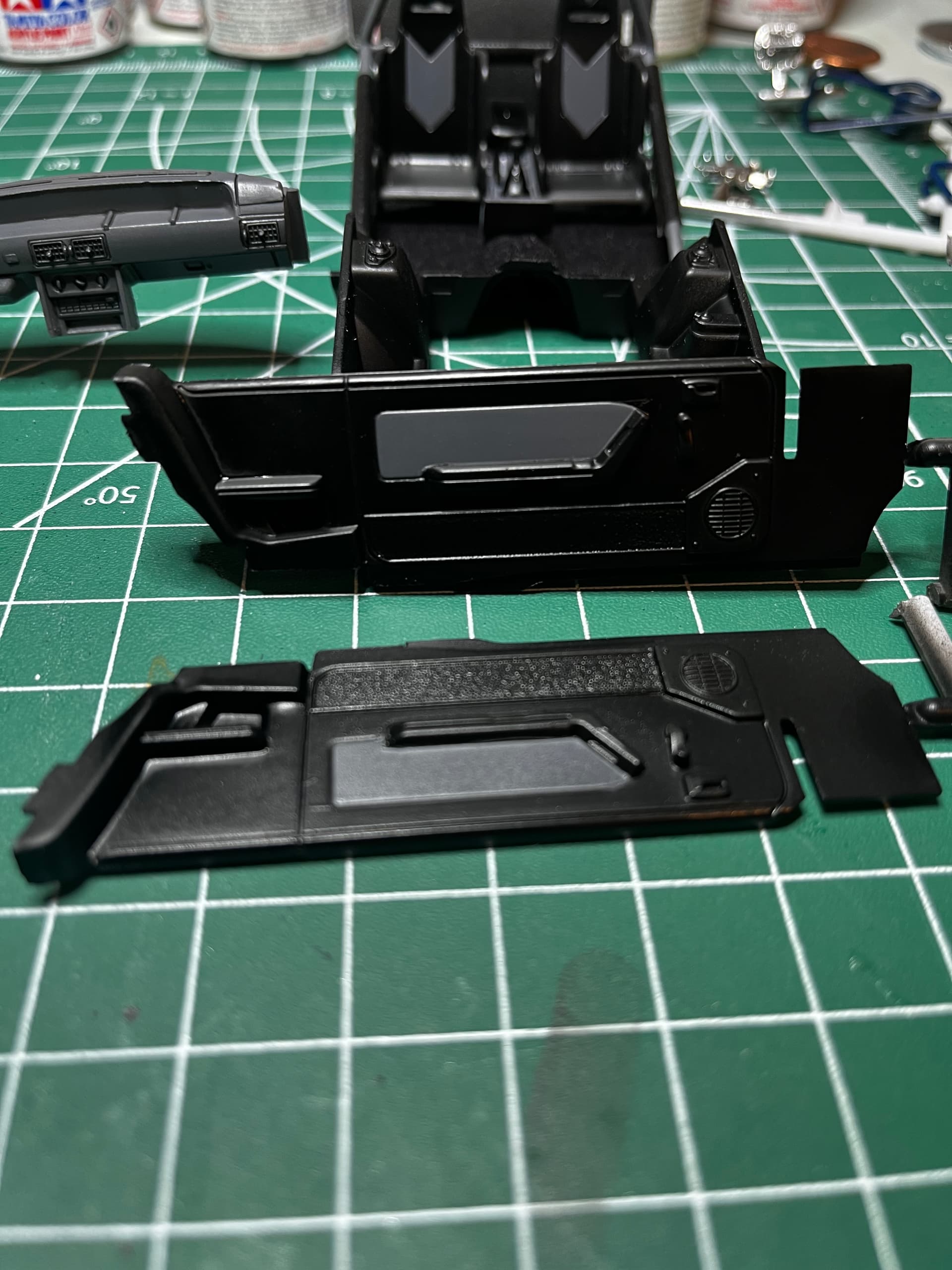

A few days ago I shot the exhaust, fan, rear dif cover with fusionfirm liquid chrome. First time using it vs molotow or just chrome paint. Painted the parts gloss black Tamiya x-1, then shot the chrome. Layed down crazy good. So fast forward two days. I used nitrile gloves and did notice that handling did dull it down, that being said it was over the top shiny and it may need more than two days to fully cure. Anyways I heat stained the exhaust, installed the exhaust on the engine, set the role cage in place and glued the joints together. Oh and installed the oil filter. Shot the center console, parts of the seats, parts of the door with Tamiya xf-24. Cut slots in the seats for the 4 point seatbelts I have. I think that’s all so far.
